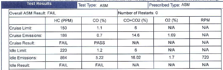

Well, the Z failed emissions today... I've got 3 months left on my tabs. So I either try to get the NA engine to pass and then swap the motor or just swap in the new turbo engine and hope it will pass NA emissions checks right after I get back from Canada in 3 weeks. hmmm
hearsay is that the turbo engine should run just as clean when off boost so it should pass considering they don't even pop the hood on our tests
Seems I'm running lean... at idle and cruise. and yes, I can tell its not idling perfect so maybe I can find a vacuum leak or something quick and fix it. Spark plugs look very light tan colored... oxygen sensor was replaced about 14 months ago and that made it pass emissions last year. AFM is 'rebuilt' and has been on the car a couple years since then. The car runs great, no power loss or misfires really... except for a very slightly unsteady idle. It blows a little smoke above 5000rpm but that shouldn't matter for emissions stuff.. .probably oil due to the 235,000 miles on it

Posts: 3,617
I'm surprised it failed if it is in fact running lean... Usually running rich is the downfall for smog tests.
What were the readings?

Yeah... I was there 3 weeks ago. In the 3 years I've had my L28ET... I've never had it "LEGALLY" pass emissions. Luck ran out this year as my mechanic friend can't do emissions anymore... now it really does have to pass! DOH! Thas why I'm doing the Z31 ecu swap.
Did ya turn down the timing Bleach? N/A's are usually easy to pass when ya adjust the timing down. Will the shop let you put it on the emissions machine in "observation mode" so you can adjust?
Old Jun 26, 2006 | 02:12 PM
  #167
well, maybe it could be rich. The paper they give you tries to tell what probable causes are. I guess the idle HC would be a rich condition more than lean. Maybe my FPR hose is broken or something.
I forgo to turn the ignition advance back. I don't remember right now if it was advanced or not... probably is.

  #168
Hmmm Try retarding your timing 6 degrees, richen your AFM to 900-950rpm's. Then open up your idle all the way, as high as it will go. And what i was told is the idle is the screw on top of the throttle body. Also unplug your T.P.S., put a thin plastic piece on it. And fake plug it back in, don't connect the contacts, or it will operate. Because it could be bad internally, I seemed to get away with it more plugged in go figure. But I guess it all depends on the engine and setup. Some work differently than others. Anyway only do this process, when you are going to emissions. Otherwise, you are just burning more fuel, because of the high idle. Hope this helps you out, and let us know how it goes.
Old Jun 26, 2006 | 02:36 PM
  #169
Yowsa! That's more than a tad over. Timing won't adjust that much. Is your EGR working properly? Still have a good cat? I've got a buddy that throws a bottle of Everclear in his tank every year for emissions... Alcohol burns cleaner.
Old Jun 26, 2006 | 02:41 PM
  #170
Actually it doesn't look like he had a NOX test. Which the EGR would take a major part in. That is something I learned from my Celica failing before. So when I did my motor swap and such. I made sure the EGR was clean, and functioning properly. And also that trick I said, that was told to me by the Zguru. And it played a part in HC, and Carbon Monoxide. Plus the fact I passed with a gutted cat, blew my mind completely. Anyway just trying to help you out man. Not much else I can think of really, but I do think you should replace the o2 sensor in case.

Make sure the cat is good, run the car a good amount before hand like take a 20 minute or so drive, use high quality/high octane fuel and maybe even a booster and reatrd the timing. Worked for my 260k+ original engine i passed with flying colors at a california state ref.
Yeah, it certainly looks like you're running too rich, especially because the car still runs pretty good (with the exception of the slight stumble you wrote about earlier that sounds like it's probably also from a rich condition at idle)... if it were too lean, the car would proabably run like caca and you would most likely notice it in the operating temp as well.
Time to check all the usual "Running Rich" suspects...
Rod.

unplug the #5 injector bleach, that works like a charm, boost your idle, and run 94 octane, and add a bottle methl hydrate to help out the clean burn. a good cat works wonders. thats how i pass, no egr, and i got a wicked big cam.

well, it runs worse with the TPS off. I swapped out the FPR and it has a strange studder and has far less power so that's not going to work... oh, I think it might have been a turbo FPR. oops...
I replaced a few hoses today but nothing really made a difference. in the end, I got the car to run worse but I can't even tell if its too rich or too poor...I mean, lean.
