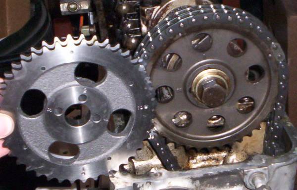

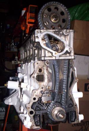

The cast sprocket on the left weighs in at 1.25 lbs. The 'other' one on the right is only 7/8 lbs. I reused the lighter weight sprocket and installed the rest of the timing set new.
shust as I shushpected!
Old Nov 24, 2005 | 02:52 PM
  #80

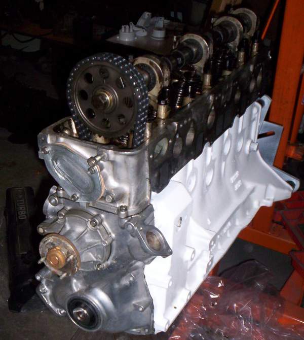

Yup! Thanks for the tip Mr. Pick. I decided to confirm this since I had everything apart. The lighter weight one looked new anyway. No visable wear or damage. However, when I install the new guides, tensioner, and chain I did get slightly less slack in the chain. The tensioner is pressed back against its resting point as it should be with a new timing set. It used to have just a tiny bit of movement before.
New timing set installed, more coats of paint on some items, oil pan cleaned up good and drying. (will paint next) Front cover cleaned. That's it for now!
i also have the one on the right, but does anyone have a clue who sells them?

I bet the one on the right is original equipment and the one on the left was made in Taiwan
Old Nov 27, 2005 | 06:21 PM
  #89
The sprockets made in Taiwan do not have the holes right above each "number" on the wheel. When you time your cam with #2 or 3 position you can't see the mark on the cam tower to verify correct timing. The sprocket on the left is Japan made just like OEM Nissan.
Rumor has it that Nissan did make a steel sprocket for the 510 and early Z-car.
Nissan part number 13024-21000
Nissanparts.cc lists it as available for $55.00

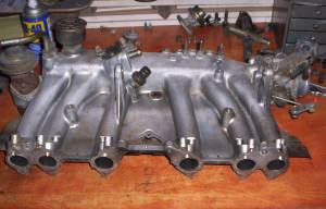

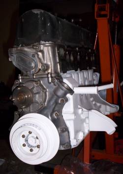

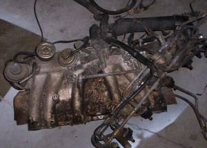

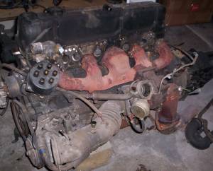

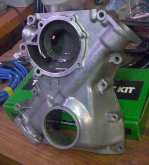

Water inlet, engine mounts, crankcase vent, oil pump, and some other junk are now installed.
The water line and fuel hose mount that I made are painted but not pictured. I got the intak manifold off the turbo engine on the floor and cleaned up. (that took a while) Next the JSK rail goes on along with new air hoses and fuel lines on the manifold.
That AAC valve look useless. I'm going to block it off.
Oh, I finished painting the oil pan as well.
No wonder this other turbo engine had an exhaust leak. Every single exhaust manifold bolt was fairly loose... hmmm...
I also cleaned up the surface of the water pump pully mount for LWW.
Attached Thumbnails 280ZX (NA) to 280ZX Turbo swap-z38.jpg   280ZX (NA) to 280ZX Turbo swap-z39.jpg   280ZX (NA) to 280ZX Turbo swap-z40.jpg   280ZX (NA) to 280ZX Turbo swap-z41.jpg   280ZX (NA) to 280ZX Turbo swap-z42.jpg
Do you plan on keeping the AAC actuator unit hooked up? I want to use the N42 intake manifold I have, but when I unplug the AAC & EGR actuator from the harness, the engine starts to spudder out.
Old Dec 5, 2005 | 10:46 AM
  #98
I will stare at the oil on my white engine and fear will drive the dirty mess away.
I was wondering if unplugging that unit would have any ill effects. I didn't read anything about the AAC unit on the L28 Turbo to 240Z swap page that I have saved. hmmm.... so do you just keep the unit plugged into the wiring harness but just not hook up any of the vacuum lines?
Old Dec 5, 2005 | 12:10 PM
  #99
jfairladyz's Avatar
Posts: 5,485
From: Temecula, CA
That's probably the easiest way to do it bleach. You could probably install a resistor or voltage regulator in it's place in the wiring harness and that would give the ECU the false sense that it's still there. Without knowing what signal voltage/resistance though I couldn't tell you exactly what you need. You could always mess around with it though.
