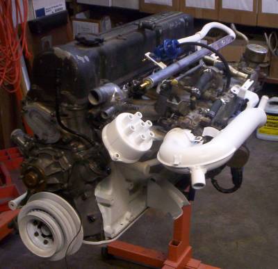

NICE Its coming to gether.. Like I said RFT the turbo
Old Jan 24, 2006 | 08:03 AM
  #127
I already painted the heat shield and the manifold. Now you want me to paint the turbo housing? I suppose next I should polish the turbine side and the intake manifold. Maybe I'll just rip it all apart now and do that...
or maybe not.
I sure hope that downpipe clears the firewall.... it looks like it goes back pretty quickly

I Was Going To Ask About That Downpipe. Nice Pics Bleach

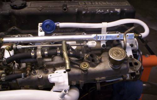

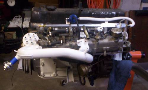

Looks like since my last post I have installed the FPR, one fuel hose, J-pipe, thermostat housing, distributor, and alternator bracket.

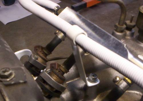

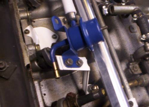

Awesome man, it look great! And did you use part of the trombone rail to mount the fuel regulator? If so, you gave me a great idea on mounting mine. Right now, mine is mounted on top of the valve cover. And I am unsure if the hood will clear or not. If you know, could you let me in on it? The hood is too heavy for me to pick up on my own. Carl is coming over tomorrow, and help me put it back on.
Don't want to jack your thread, anyway let me know on those questions. and can't wait to see your Z in action again!

Yes! The 'other' turbo valve cover has fewer scratches. I was going to paint it white and then polish out the top letters like they are from the factory. ya, it look ugly in the pics now. I think I'll do that next.
Also, I did use parts from the factory fuel rail. I have one part that slips over the stud in the front cover. (not pictured) It spaces out the idler pully like it was meant to from the factory and I'll tie the fuel hoses to it as they come around the front of the engine. The factory FPR mount was cut out and cleaned up for that mount. I bent the tabs a little to clear the JSK rail. The other little bracket that the fuel hose goes through is also another piece of the factory fuel rail. It was part that has a plastic gromit in it that the original fuel line goes through. Cut off the bracket and remove the plastic center gromit. I was showing the closeups to give you an idea of what parts of that rail I used. It worked out great.

hey bleach you are not going to be intercooled? I was jus wondering since you are using the oem jpipe.

What Are You Doin Using That Stock Regulator For, Upgrade My Friend, Upgrade, Check Out Aeromotive's Vacuum Controled Regulator, Cheaper Than Msa's, Same Function, I Put Mine By The Fuel Filter. All Braided Lines.

Right now I'm using the stock regulator and no intercooler. I'm also keeping the boost levels low.
I will upgrade the FPR, get a recirculating BOV, and add an intercooler after I have driven the car for a while. ...maybe later this summer or fall. (if I have money at the time)
