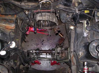

The engine is out, replaced the steering rack, new tie rod ends and mounting bushings. The steering boots were the wrong size... again. Check the boots when you buy them. They're always giving me too small of an opening on them to go over the rack.
I'm working on laying down the FI wiring right now. There is one extra white wire going out the back of the fusable links box that the NA wiring does'nt have anything to plug it into... so ya, I'll look into that and see what to do with it. Everything else is going smoothly.

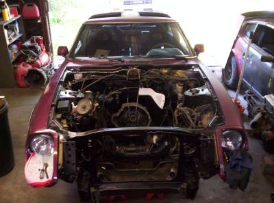

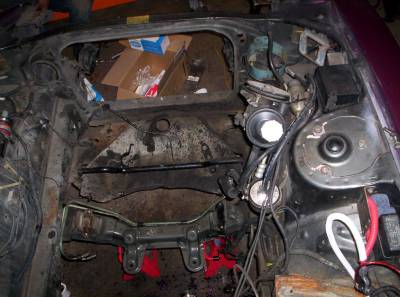

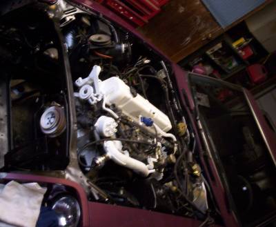

So I decided to paint the engine bay while it is out so I'm working on that today. The new engine should probably be going in tomorrow evening.
Here are some pics from Saturday

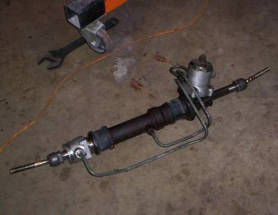

lower milage steering rack cleaned up, with new bushings and new inner and outter tie rod ends
engine bay cleaned up a bit
ya, just the bay area
NA wiring harness by the fusable link box
turbo harness tapped in. Three main power wires out of the links box are the same. The one clip on the left with the crimp connectors is the only part that was different. I matched the colored wires to the NA setup and that leaves on white wire goning from the FI harness to nowhere. I'll look into what that wire is for. If its a signal for the boost gauge then I don't need it as I'm not running the factory boost gauge.
Still painting...

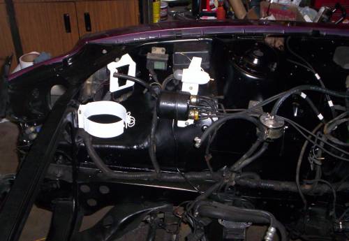

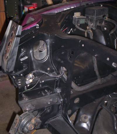

Old Jul 3, 2006 | 01:15 AM
  #216

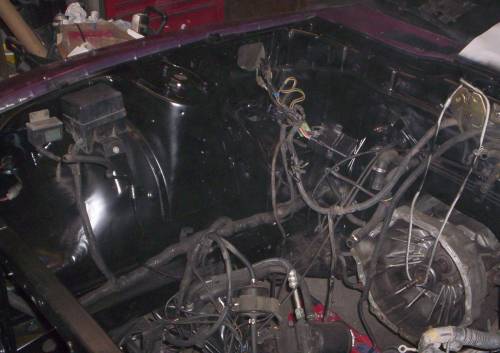

The engine bay is all black now. Ready for a white engine.
The front part...

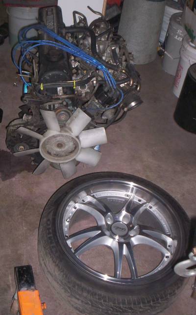

Old Faithful. We've been through so much together and you always took me home at the end of the day

Old Jul 3, 2006 | 07:13 AM
  #218
235,400 miles on the NA motor and still running strong. It had stock compression of 8.8:1 at 200,000 which is the last time I checked compression.
The engine bay didn't get a whole lot masked off. I did a quick cleaning of the bay and then I just held the wiring harness out a bit with one hand and sprayed some paint around behind it. I did the engine bay one section at a time this way. I only masked around the top edge. It took about 6 hours of work but it looks really good now.
The white does not look quite that bright in person. the flash made it glare a bit

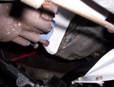

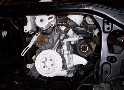

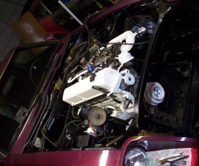

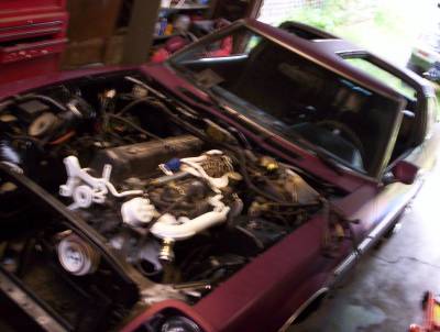

had some trouble with the flywheel bolts and the clutch but its all together now...
the car is ready for the engine
engine in (crappy camera always blurrs, I even took two pics)
the engine is not quite bolted to the transmission all the way
this one stupid pin that sticks out will not go in! I got the upper two tranny bolts in loose.I then set a jack under the tranny so the engine is hanging on the transmission. I got in the engien compartment and lifted the entire engine up and twised it over and over but the stupid thing will not go in!!!

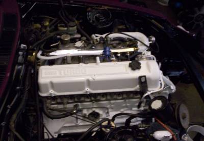

Very nice.. and thats a lot of white

I realize this is a little late coming but... it's a whole lot easier to put the engine/tranny into the car already bolted together. It just slides right in that way. Then just loosely attach the tranny mount so you have leverage then bolt up the engine mounts.
Enjoy the fireworks.
Old Jul 4, 2006 | 09:02 PM
  #222
Skully's Avatar
Joined: Feb 2002
Posts: 2,906
From: Saskatoon, SK
yeah you should have pulled the tranny out...thats what ill be doing and replacing some seals while im at it too...looks awsome cant wait to see it
Old Jul 4, 2006 | 10:23 PM
  #223
apollo's Avatar
Pro Pumpkin Carver
Joined: May 2004
Posts: 2,160
Nice work. Get a fat *** double bacon cheese burger. Nothing burps better than bacon
Old Jul 4, 2006 | 11:31 PM
  #224
I've pulled a few engine/tranny combos. Without a tilt on the engine hoist, it sucks. It is a lot less work to just pull the engine then to remove the center console, shifter, tranny mounts, driveshaft, and drain the tranny fluid. I had no need to remove the transmission.
I'll get it to snap together tomorrow.

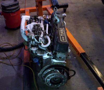

There's some white for ya
