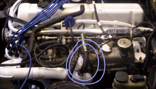

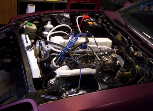

You could probably see from the pics that the BOV hose is going to the middle of the manifold. I'm getting the signal from right next to the FPR hose. I see it working properly when I move the throttle by hand and watch the BOV

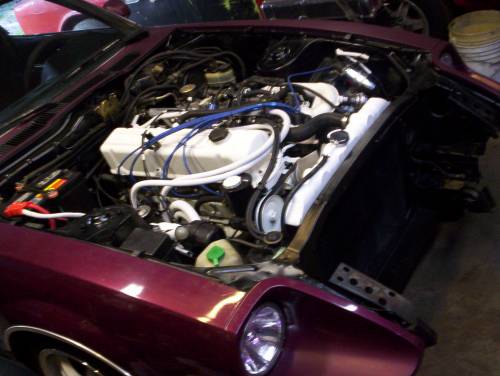

Here are some pics for you folks.

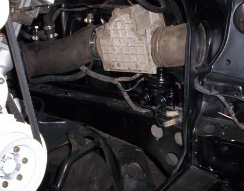

don't mount the AAC unit here, move it back a couple inches or else the radiator will hit it.
How about this stupid thing... could my vacuum leak be going through this?
All hoses are brand new as well as all hose clamps. It looks ... new, and not kinked
Every single vacuum hose and fuel hose on that car is new except for the valve cover vent hose which looks to be in good shape. That hose has a unique pre-formed shape to it so I reinstalled it.
I'm just wondering if one of those items on the intake is bypassing air from that hose... I'll check tonight when I get home. I didn't go back out and work on my car last night. I drove the Toyota today.
