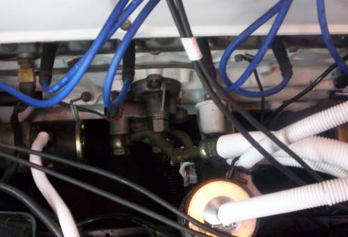

injection, fuel, and hoses hooked up...
Old Jul 7, 2006 | 09:58 AM
  #230
RodMoyes's Avatar
Doesn't post much...
Posts: 3,617
Looking great!!!!!!!!!!!!!
But what's up with that nasty-*** lookin' intake manifold????????
Rod.

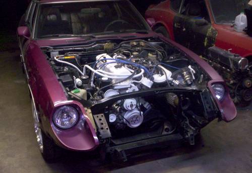

Today I finished up more details. Hoses, wires, throttle linkage, and other stuff...
I hooked up the coil and wired it into the ECU harness which really only required ONE wire to be plugged in there. The main power and ground for the turbo coil wiring I just spliced from the NA coil's power and ground and then stuffed the NA harness into the fender. ...also, my tach works as I've heard some people who do this conversion end up with no tach signal.

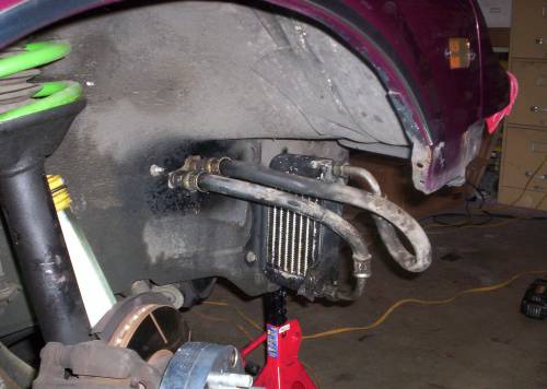

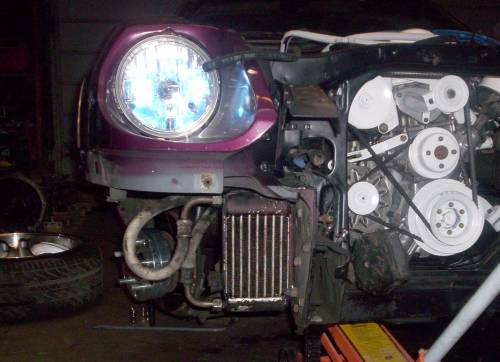

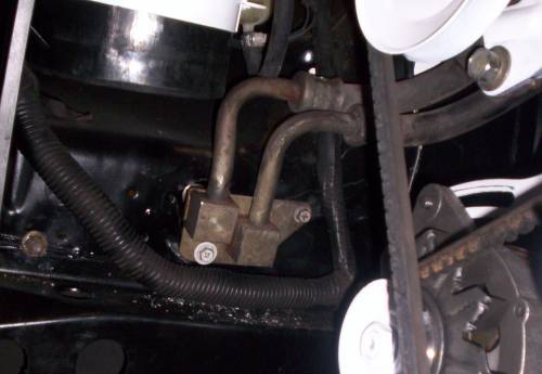

then there was the oil cooler. Mounted it to the block
Cut a hole in the car
mounted the cooler. I checked for clearance from the tire while turned full lock. Its fairly close but should be fine. It has aboot 2 inches of clearace.
Oh, and then I started it up. It was 3:46am today and the garage door was closed. I had only half of a straight pipe exhaust and no radiator so I only ran it for a few seconds. It fired right up. When I tapped the throttle it died out but came back with no throttle pressed... I'll get to look into this more later. I need some sleep

hey nice going bleach man, love the aboot in there too. nice work with the oil cooler placement, i always wondered what we could do to get external oil filters and coolers to fit. what are those lines off of? they look real professional
Old Jul 9, 2006 | 11:09 AM
  #237
It's a stock 280zxt oil cooler... thas why it looks like it should fit right there. All auto 280zxt's had an oil cooler.

Yes it a factory 280ZX turbo oil cooler and that is the factory location for mounting it although I don't have the exact holes in my car for where it mounts so I just guessed.
