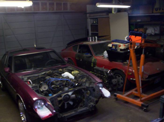

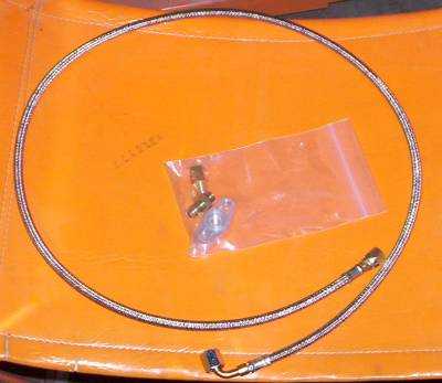

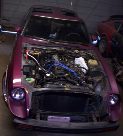

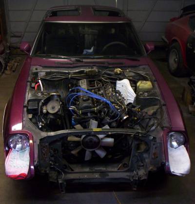

So I got my oil feed line. Stainless -4 with restrictor to put at the turbo. It has an aluminum plate that goes right on the T3. I still need to get a couple more fittings though. The BPT thread I got was not the right size. I think someone on Hybridz posted it was 1/8 inch but that' way too small. Probably 1/4 inch BST... anyway I'll get the whole thing put together and post what you need to buy. I got this from ATPturbo.com for pretty cheap. It'll end up running me about $100 for the whole setup once I get the right stuff. for you, it'll be a little cheaper since you wont' have to buy the wrong fittings first.
Here is the start of today. Already had the air dam and hood off.
And then at the end of the day... all junk is disconnected except the bottom bolts on the tranny and the engine mounts
and this is Bleach's Garage (.com)

Me gusta!!! You runnin that oil feed from the oil pressure sensor to the turbo? It doesn't look long enough to me.
