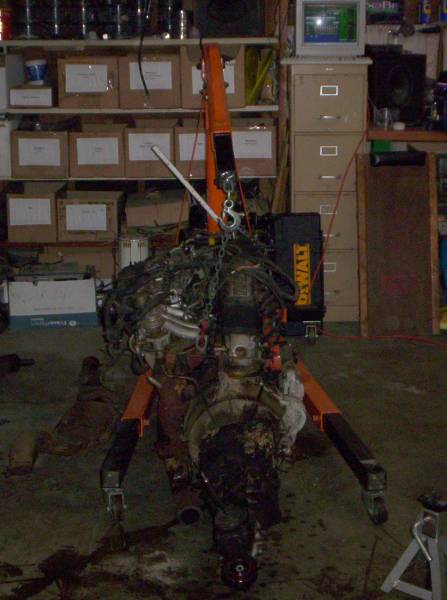

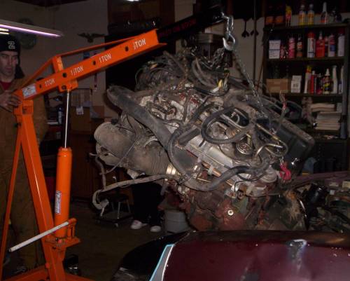

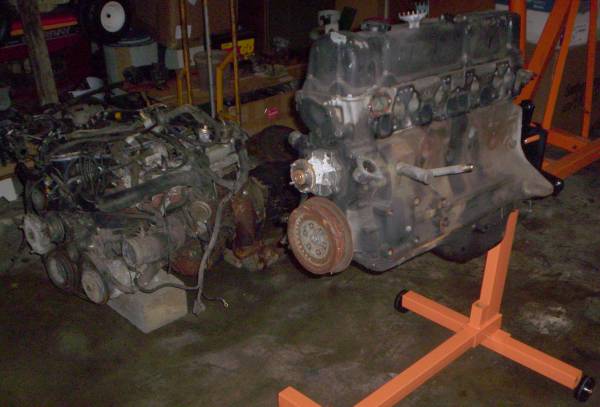

And it's out!
I cut away more of the firewall, and removed the alternator for clearance
with a snap, rattle, and bang out came the turbo engine...
Attached Thumbnails 280ZX (NA) to 280ZX Turbo swap-proj6.jpg   280ZX (NA) to 280ZX Turbo swap-proj7.jpg   280ZX (NA) to 280ZX Turbo swap-proj8.jpg

I'm trying not to think about driving it quite yet... I'll start daydreaming. There's still a lot of work left to do. But its nice to have the parts car out of the garage. Now I can set both engines in the middle of the floor and start doing the small stuff.
Ok, a couple things to remember. No matter how many times I looked at the clutch slave cylinder while under the car, i still forgot to disconnect it. It pulled a bit but I saw it and cut the line. Also, that bracket on the back of the transmission does in fact hold tight to the exhaust pipe! I yank on that engine so much it litteraly ripped the pipe right out of the rusty muffler. I had cut the pipe off just after the downpipe.
I removed the 3 bolts on the bottom of the down pipe and then slammed on the exhaust for a while. It wouldn't break loose.
For the electrical, I figured I could cut/splice the wires either going right into the fusable links or coming out of them. I cut them comming out. So now I will use the turbo fusable links box an solder it in to my car in the same manner. Everthing else just unplugged.

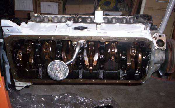

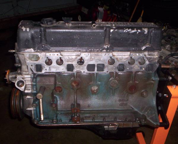

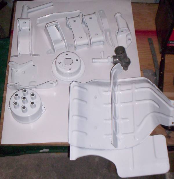

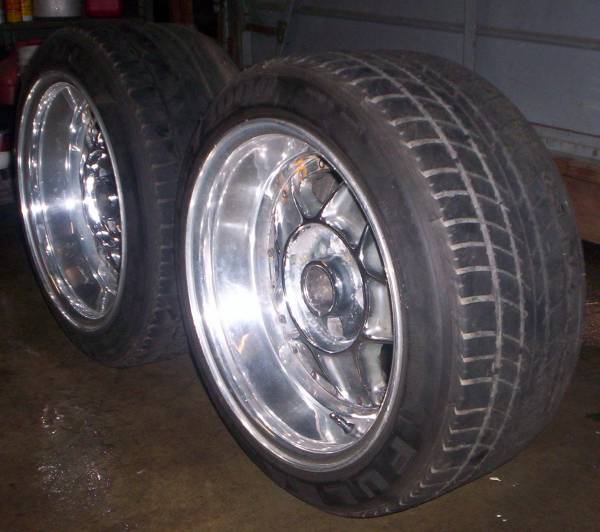

1. Engine up on the stand. Do you call this, twin turbo?
2. Cleaned up a bit

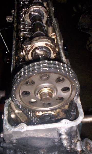

3. Timing is set correct. Cam looks great. Upper sprocket looks different. Is this Nissan or aftermarket? (maybe different for the turbo?) Timing set looks really nice. When I pull the front cover off I should be able to tell if it was replaced or not. I have a new set anyway
4. My 16x10 wheels for the rear
Attached Thumbnails 280ZX (NA) to 280ZX Turbo swap-proj13.jpg   280ZX (NA) to 280ZX Turbo swap-proj11.jpg   280ZX (NA) to 280ZX Turbo swap-proj12.jpg   280ZX (NA) to 280ZX Turbo swap-proj10.jpg

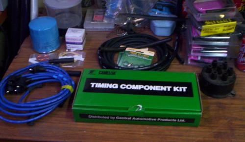

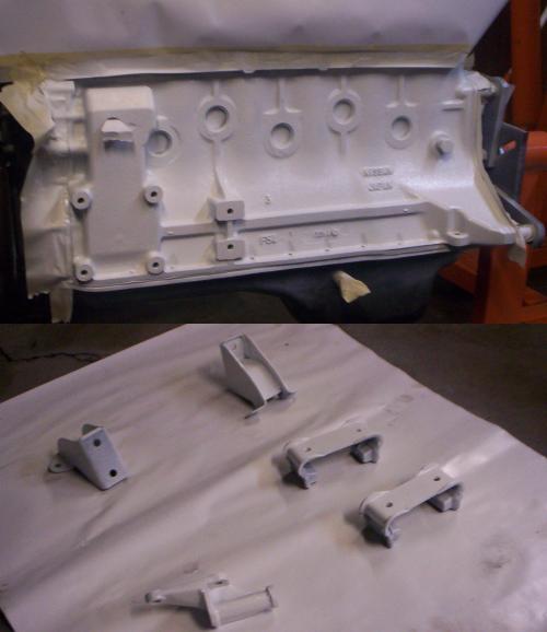

Just a lot of cleaning and some painting the last couple days. The block is done with paint as well as a few accessories for the front end. I think tomorrow I might be putting the new timing set on.

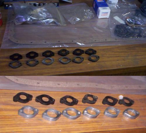

Pictured are the painted items, the timing set with spark plug wires, blue Nissan oil filter, and my gaskets. I have a set of the aluminum injector holders which I cleaned up a bit.

Damn, those injector holders are looking pretty good. Two thumbs up on those. Are you keeping the block that gray color?

hey bleach the timing kit...where did you get it...i see those ebay ones kicking around that are from "japan" but i could swear sombody posted they suck...i need a nice timing kit
engines looking clean...but ahh you shoulda went black..:P
Old Nov 20, 2005 | 08:25 PM
  #64
Mine was from Importedcarparts.com
I think they are out of them now. I get a lot of my stuff from that website. They have good prices and quick shipping. A lot of their stuff says manufacturer "Japan" and some items even come with Nissan part numbers on them! I think they get them from the same distributors as Nissan. Rocker arms used to be $13 apiece but are back up to $40 something. A few years ago they had a lot of 280ZX parts but a few items are drying up...

What is the difference in these two upper timing chain sprockets? Non-turbo on left and turbo on right... maybe? Any known timing changes?
oil pan and front cover are off. Cleaned stuff a little, but everything looks really good on this engine. New oil pickup tube (just because I had it already).

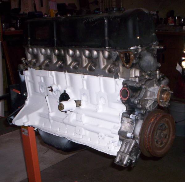

and in case the colors don't show up vividly, I'm painting the engine white. (not grey)
Attached Thumbnails 280ZX (NA) to 280ZX Turbo swap-proj16.jpg   280ZX (NA) to 280ZX Turbo swap-proj17.jpg   280ZX (NA) to 280ZX Turbo swap-proj18.jpg
More holes in the turbo one.... lighter weight? The turbo one doesn't look to be cast.

As long as the timing holes are all in the same place then it makes no difference which one you use.Thats the only difference. The one with less of the larger holes might just be from a casting change or they are using a cheaper (both cost and property wise) so they wanted to keep more material on the sprocket maybe But just make sure the timing holes line up the same and it's all good

Yeah I'm double posting but I thought of something else. I don't if what Nismopick said above has any merit, but if indeed the turbo one was forged that would make it a stonger piece than the cast one. So they could take out more metal to make it lighter without sacrificing too much strength. Where as the cast one would need more metal to stay rigid. That is of course if the turbo one is indeed not cast as he suspected. Just a thought. Plus if it's not a Nissan part then chances are who ever is manufacturing them wants to do it as cheaply as possible. And casting is much cheaper then forging. Which is just another though.

no, the engine is not going to be caked with grease unless all my new gaskets fail. My truck's engine I did not paint but just put it together. 2 years later its still very clean. Any fresh painted engine will show the oil, except for black.
Hopefully I have no leaks. If I do I can either fix them or do a quick degrease before I go to a show. Its hard to find any kind of dark maroon or purple color in high temp engine paint. Plus its easy to get things in white. Its a neutral color that will look fine in any color car. and ya, it kinda goes with the 'bleach' theme. :P
