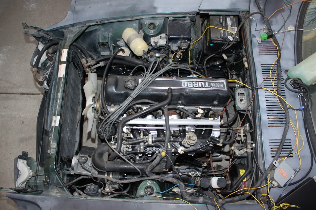

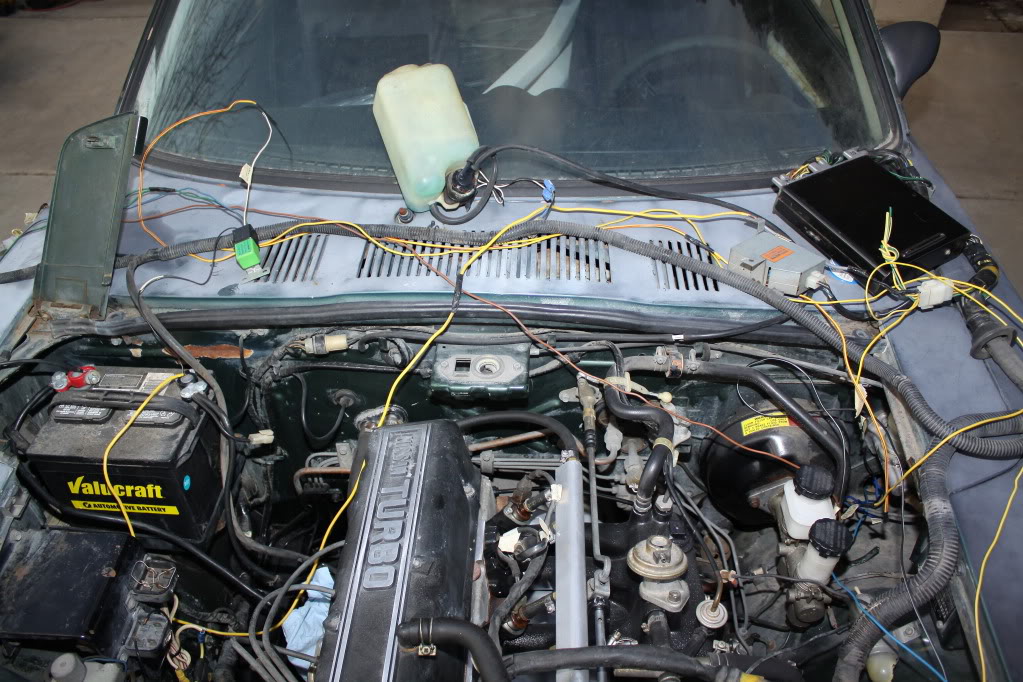

w00t! Finally got around to working on my "project 280zt". Wired it up, drained the old fuel, and got it started. Minus the 3 leaking fuel injectors and shot fuel pressure reg, it's a runner!
Since I'm doing the Z31T ecu / MAF upgrade, I just mocked up the wiring harness, so I can make sure it runs, then pull it back off, make the modifications, and make it look purdy.

The wiring looks awesome, leave it as-is.

hate to say it but wiring looks better than mine
