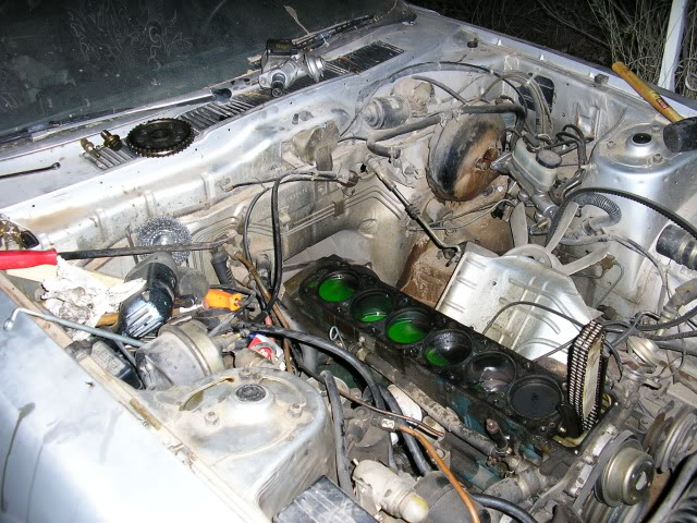

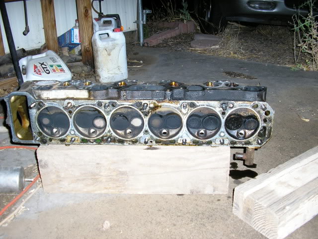

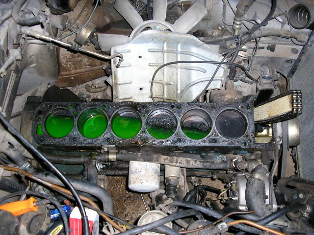

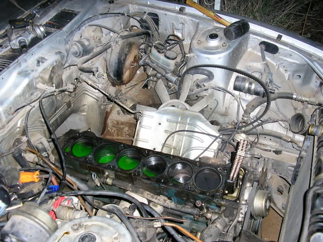

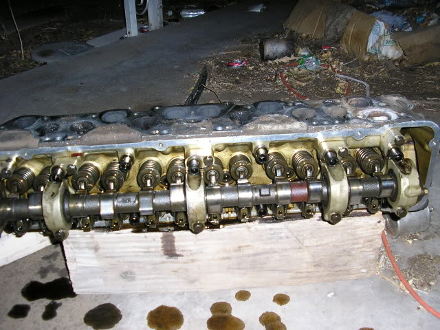

^ That's allright, no problem, I can deal with it later. Anyway update, or should I say heavy update. lol I got the cylinder head off successfully. Now here is some pics of the inside of the engine, and the condition of the head. Let me know if everything appears to look good. Thanks in advance.

Looks like your making some good headway! BTW idk if you have a Dollar Tree store near you but they carry a cleaner called "Awesome!" and it works great for cleaning off the grease and stuff. a raged soaked in it helps loosen gaskets a little too

Yeah very funny. lol Anyway I showed the pics to a friend of mine. Who has rebuilt many engines in his life. Although he really didn't tell me something, that I was thinking already. He was telling me, that a couple of valves look burnt. And it would be better to rebuild the head. Or get another one. Also, to get that antifreeze out of my cylinder walls. As soon as possible. And wire wheel the pistons, with oil on them.
