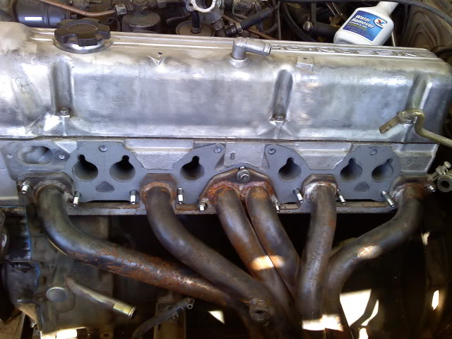

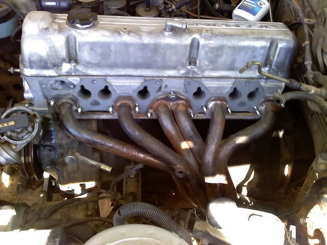

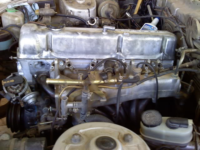

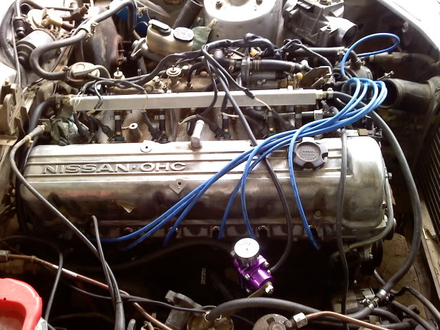

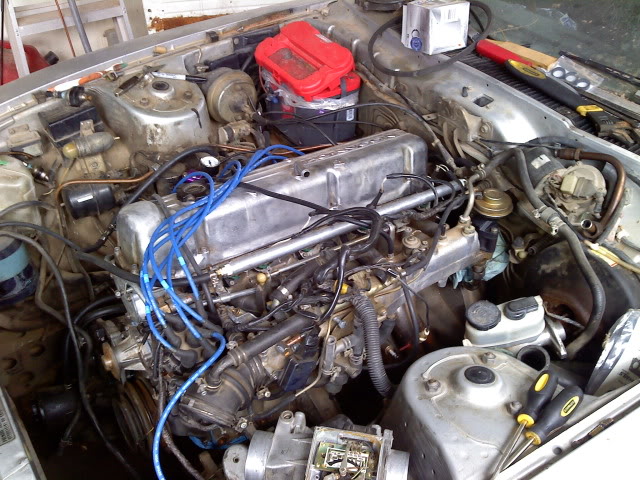

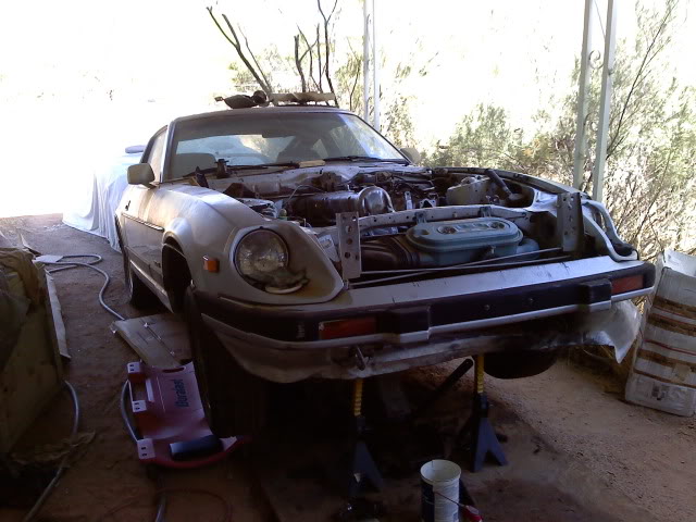

Here are some more pics of my progress. A couple header pics, and intake as well.

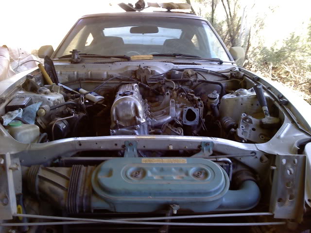

Engine bay, and frontal views.

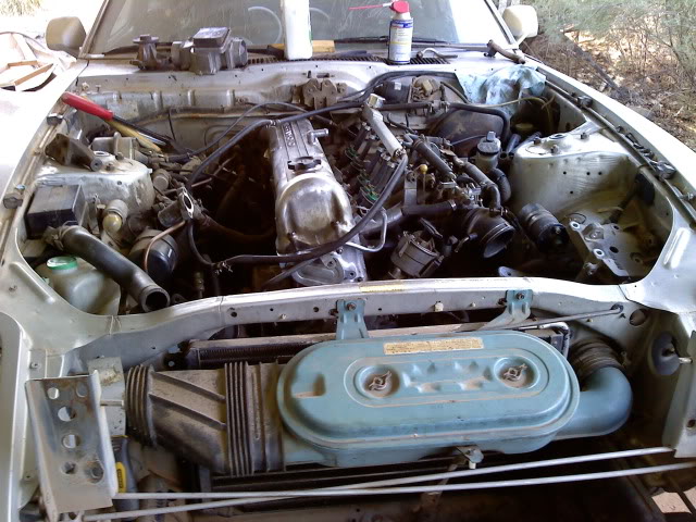

A couple of body pics. (First 3 being older, and the 4th pic just yesterday.)

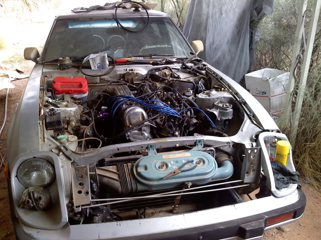

And these 2 just taken yesterday. I pretty much have the fuel rail on, with aftermarket regulator. I had to guess which line was in, and which was out. Since nobody told me. Hopefully when I try to start it tomorrow. It will be flowing the fuel correctly.
Enjoy, and feel free to comment. I am pretty close to having this Z running. I am trying my best to make it happen.

Oh, also is the #1 spark plug wire, supposed to be where the 1 is marked inside the cap? Just want to verify that. Because I couldn't find it in my manuals. Also, do you think I should try and put the old regulator back on? Since I know I am getting pressure. Maybe it is just finicky with that aftermarket regulator. Anyway, and feedback is greatly appreciated. Going to crash for a while, and go to work.
From looking at your pics, the #1 wire is on the wrong part of the cap (unless you have your timing WAY out) the wires need to be one cap over in the clockwise direction. cuz it needs to be pointing to the very front of the car on the cap.
And it wouldn't hurt to try using the oem regulator to entirely rule out fuel. btw are the injectors even getting power?
^ Dude you just saved me a lot of headache! I had a weird feeling, that the wires were in the wrong spot. And I started to remember, that the number 1 wire, is just above where the front tab is on the cap. That could make a huge difference.
