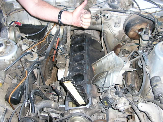

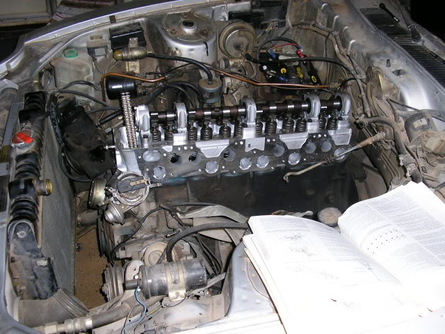

Update....The cylinder head is on the car, and torqued to specs. I did take pictures, but will have to wait until tomorrow. I would say two more weekends, and my Z should be running. Woo hoo!! I'll keep you all posted.

Okay I'm stuck...I can't get the cam gear on the camshaft. With the chain on the teeth. It is just a little below the pin. That I can't quite get it on, where it needs to go. Please help, with any tips you have. It would be much appreciated. Thanks in advance.

Okay...I have been brainstorming at work. And came up with an idea to get my cam gear and chain on. I am going to try, and put the cam gear on first. Then kind of put the chain on the teeth. And rotate the engine, until the chain gets back on the gear. What do you think? A bad idea, or do you think it would work? Feedback is welcome. Thanks in advance.
Old Aug 3, 2010 | 02:58 AM
  #240

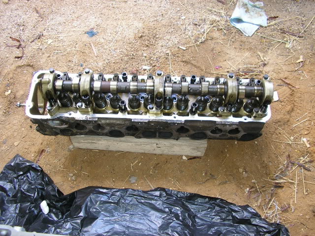

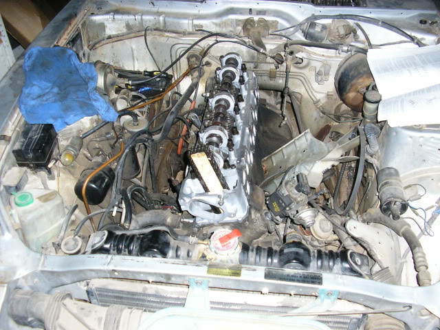

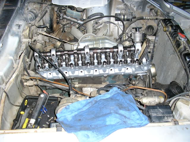

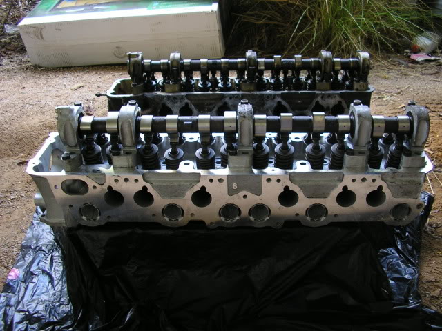

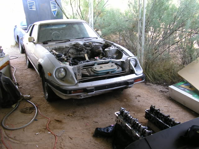

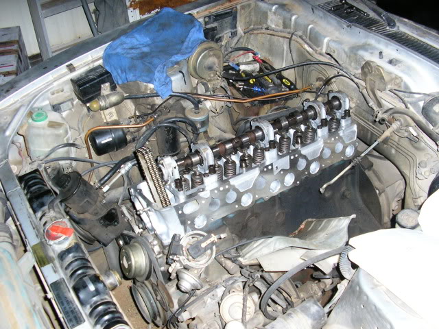

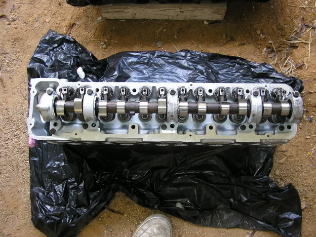

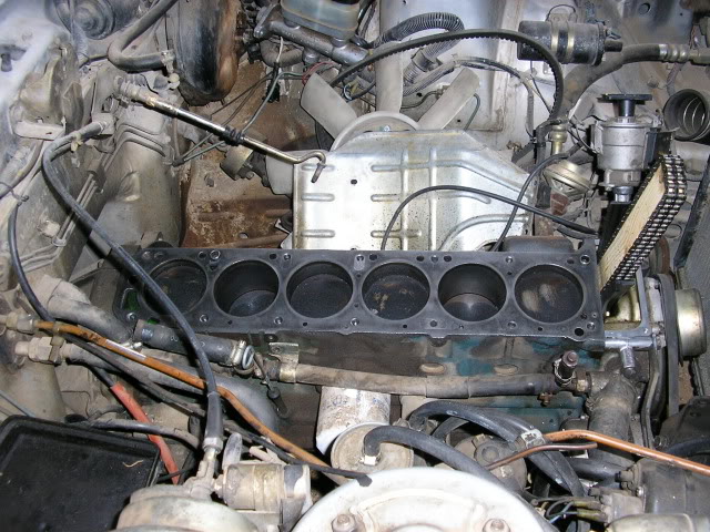

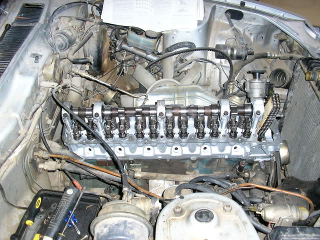

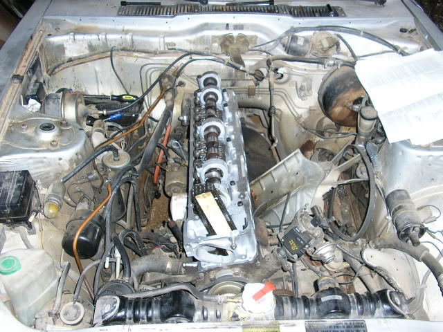

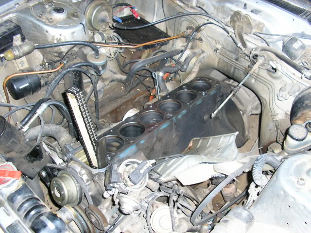

Okay..here are the pictures as promised. Just a little late. But better late than never right? Anyway...enjoy, and feel free to comment. And more to come.

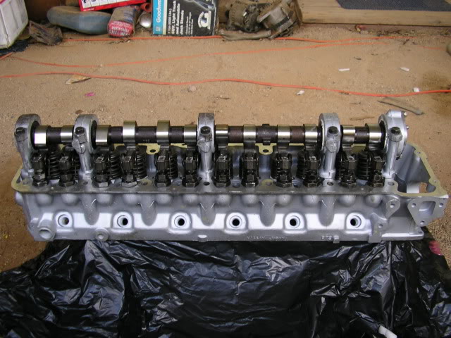

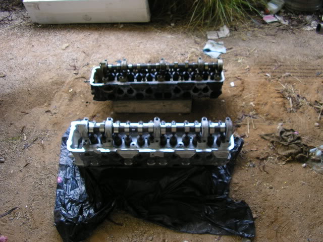

Here are some more pictures. More to come very soon.

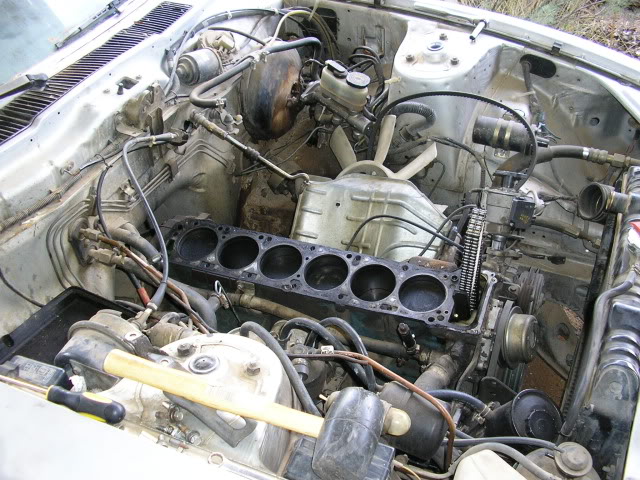

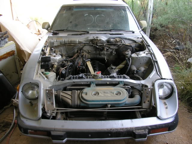

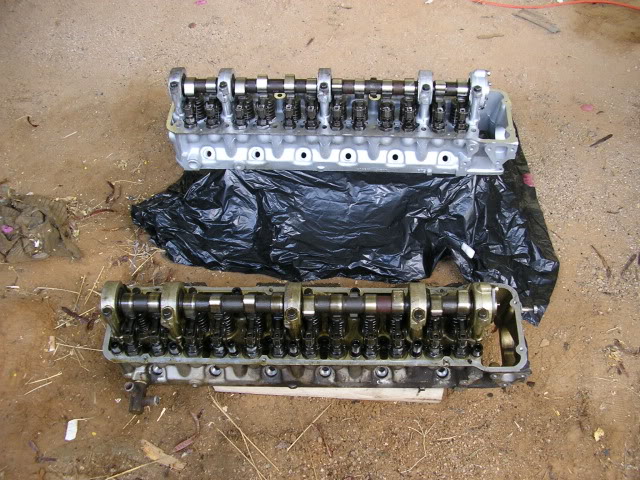

I goofed up, and forgot some earlier ones. So here they are.

Okay...forget that trick I mentioned previously. Could be a bad idea, and damage my teeth on the cam gear. Or damage my chain. Anyway, I talked to my brother the other day. And he said because of my tensioner, keeping the chain tight. That I would need to pull harder on the chain. That is what he said, he had to do on his Celica. When he put a new cylinder head on it. So I am going to try and put something in one of the holes of the cam gear. And with the chain on it, and in the right place. Try to pull it, and up just enough to get it on the camshaft. I will keep you all posted, as to what happens. Wish me luck.
Old Aug 5, 2010 | 11:23 AM
  #244
Unhappy I really need help please!
Now I am in a mess. I tryed prying the cam gear on the pin. With a screwdriver, and being careful of course. Anyway then while I was doing that. I tapped on it with the rubber mallet. At first, it looked like it was going to go on there. Then after I noticed, that it wasn't quite lined up with the bolt hole. I started to take it off. And noticed, that the pin was pushed more in. So I did some more investigating. And low and behold, the camshaft got shoved back.
Is there anyway to take the cam towers off. And try to move the cam toward the front? Or do I have to take the head back off? This really sucks, I have been fighting with this for a few days. And now I am in a worse situation. Any tips, advice, is much appreciated. And please no smart *** comments. I really need to figure this out. Thanks in advance.

oil up everything and tap gently on the back of the cam tills its pushed forward back into place. you can pull the cam backwards out of the head when its not in the car. the cam gear keeps it from doing that tho.

Well the camshaft is back in place. But now I have two more problems. One: is I tightened a cam bearing bolt a little tight. and now it is loose. When I turn it with a ratchet, and give it a little pressure. (which means, I might have to helicoil it) Two: I accidentally dropped the timing chain yesterday. And thought I was allright. So today when I go to pull up on it, to try and get some slack. It moved a few teeth. So now I have to take the front timing cover off. Which I will need to read up on. Who freaking knows, when I will ever get this Z going again. I keep running into obstacles. And with frustration, and tired of screwing up. I feel so helpless.
Anyway, if anybody has input on this. That would be great. Otherwise, going to read my books. And see how the process works. Will keep you all posted, wish me luck. Also pray for me. I am going to need all I can get. Thanks in advance.

cam bearing? you mean the cam bearing tower? If so ouch... you might need to pull the top half of that head apart to fix the threads. and the TQ on those bolts is only like 10 ftlbs. Make sure their all snug else the towers might be rocking around slightly and setting the cam towers back down.
As for the timing cover. There is a LOT of little 10mm bolts all over the front of the thing and their easy to miss! I spent 3 hours trying to get my timing cover off the first time sense I missed one buried in grease and another being the oil pump. Some of the water pump bolts hold it on too. I usually pull my radiator and remove the fan when I do a timing cover pull just to make much more room, if thats any help.

^ Yeah, cam bearing towers. And the bolt is tight, if I don't try to turn it with a wrench. Hopefully it will be allright. Okay, yeah might as well remove the radiator, and the other things. Thanks for the tips and info. And yes you are a great help. Appreciate it bro'.

Oh if you know for sure you got ALL the bolts off and it doesn't want to come off just tap on the top a few times with a rubber mallet and it should pop right off. Age glues those covers on nice and tight.
