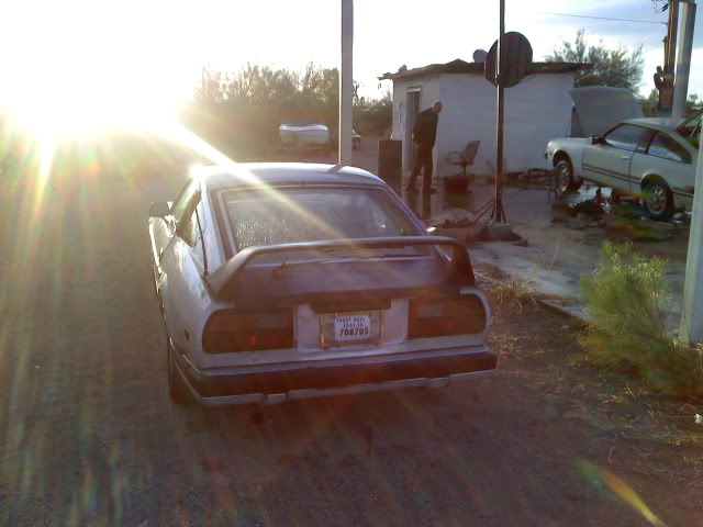

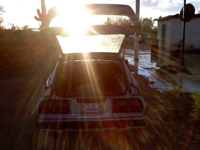

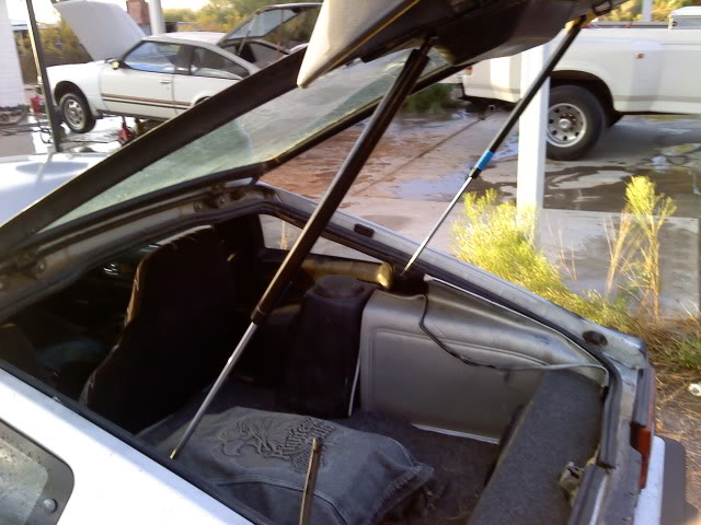

Here are a couple new pics I took today. More to come, as I slowly fix this Z up. Oh, and yes the Firebird does move under her own power. Only way I could get my Z out.

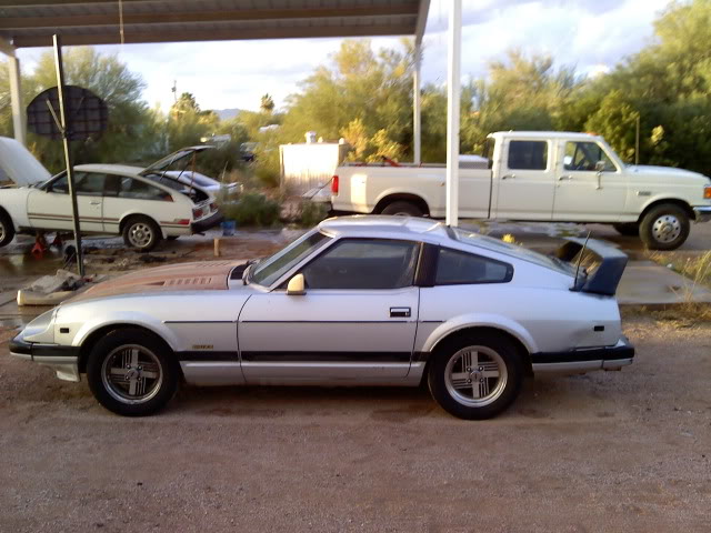

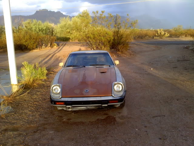

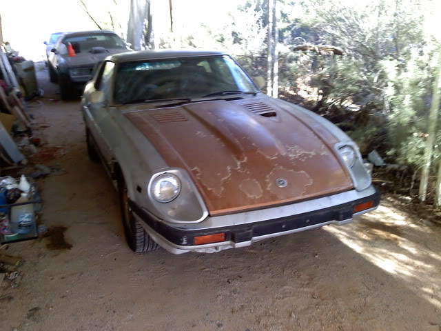

Old Dec 3, 2010 | 02:22 AM
  #320

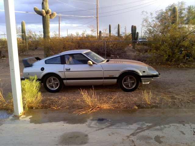

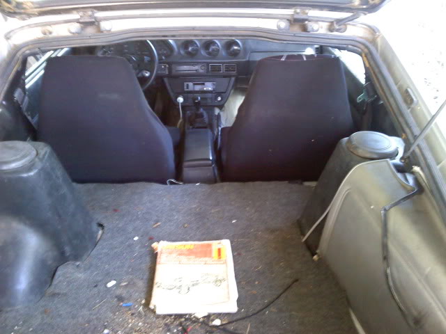

Okay...more recent pics to see and enjoy.
These were taken at my brother's friend's place, on November 21st: Sunday. His friend is currently fixing up a 1980 Toyota Celica GTS. It is pretty clean, and he got it for a steal.
Oh, yeah these were taken before I started painting the hood, and vents. Feel free to comment, and thanks.

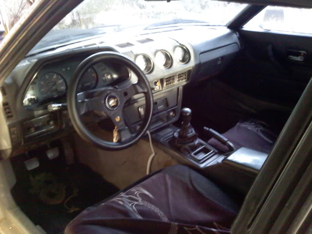

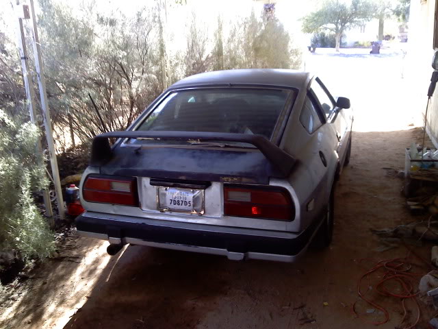

Old Dec 3, 2010 | 02:34 AM
  #321

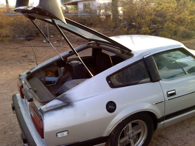

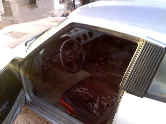

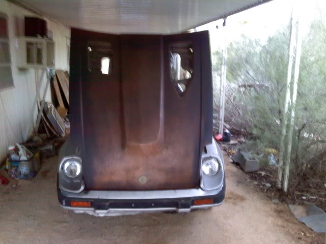

Here is the Z, while I was painting the hood flat black. And a couple of interior shots. Much more to come. Stay tuned.
Believe me....The interior is far from done. And that pic was taken before I did more work inside. As you know...I am converting my interior to black. Just taking my time. I will take some more pics and post here. You can bet on it.

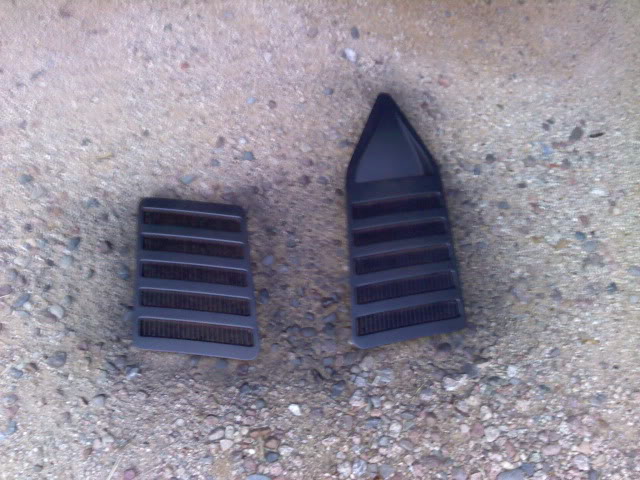

Old Dec 3, 2010 | 08:56 PM
  #322

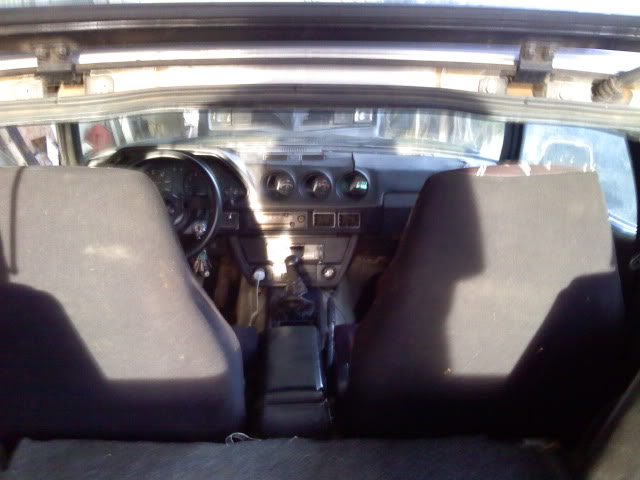

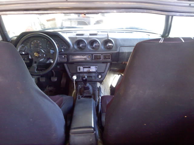

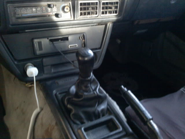

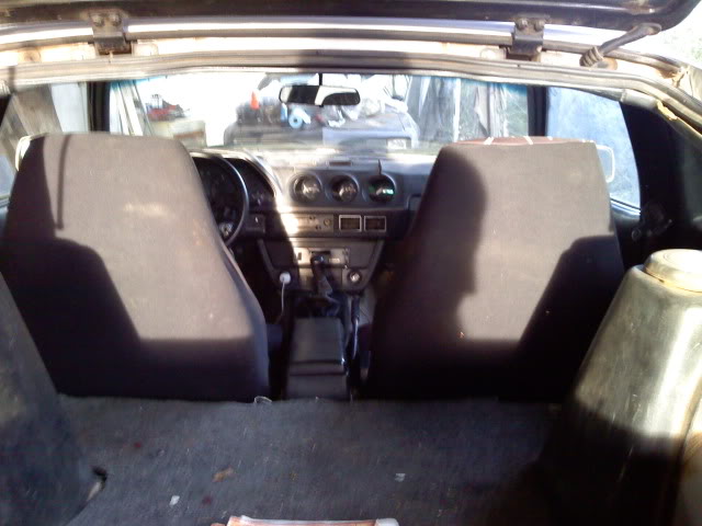

Here a few pics of my interior, with new black leather shift boot. And also cleaned up a little inside. For some reason, the pics didn't turn out too well. Oh well, enjoy, and still more to come.
