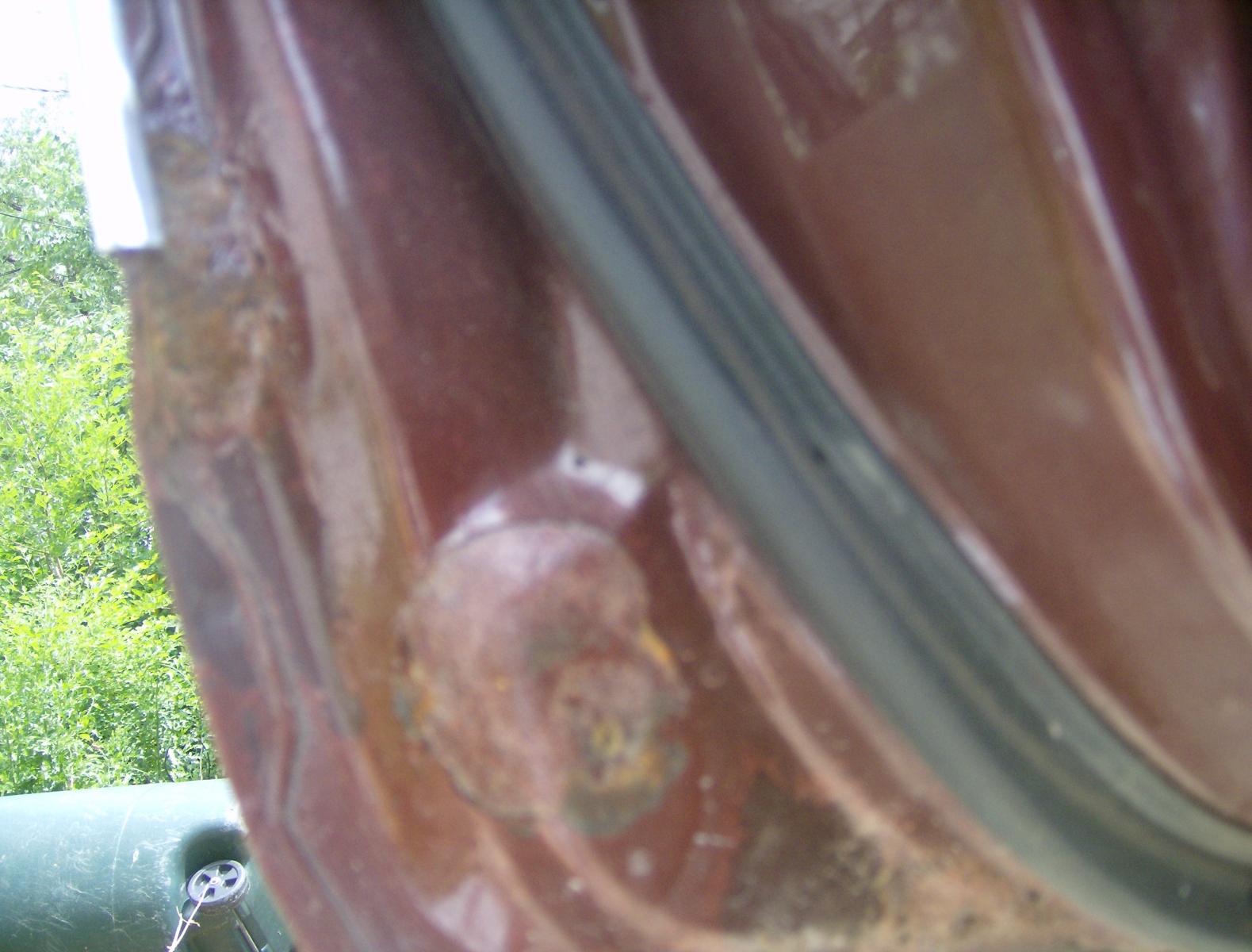

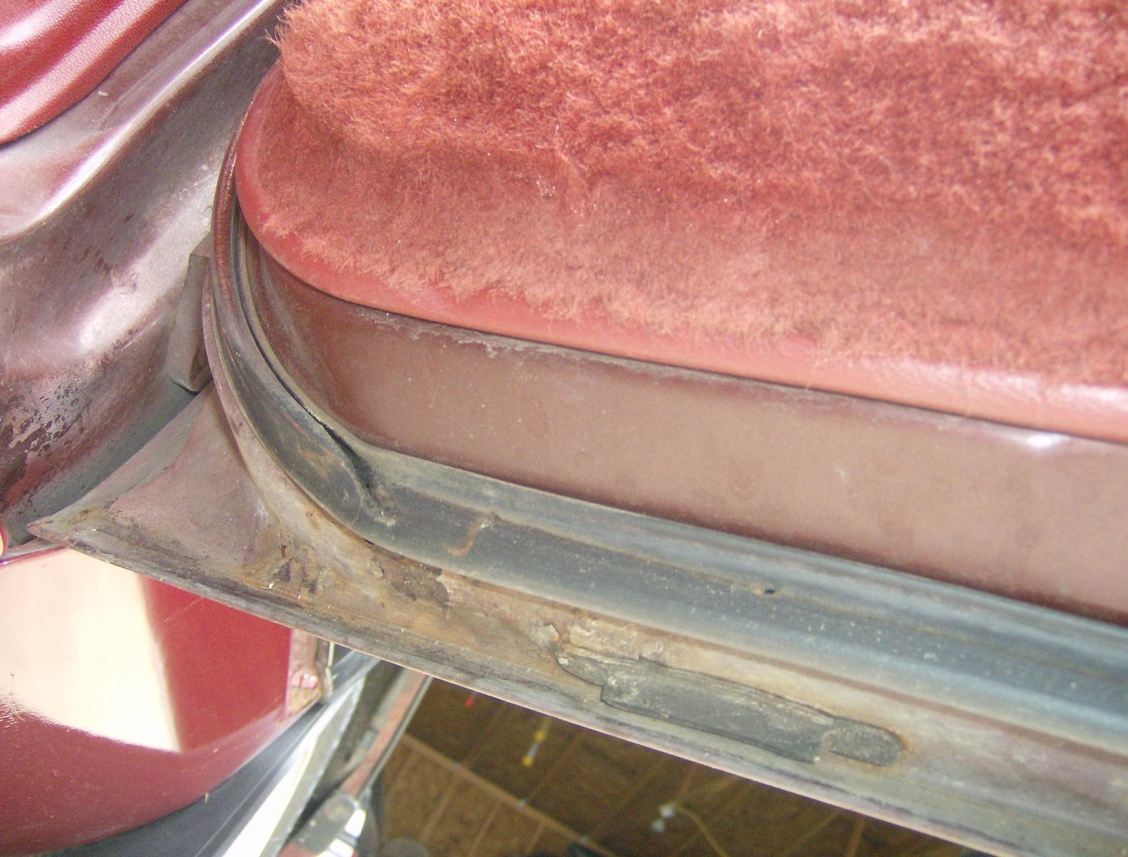

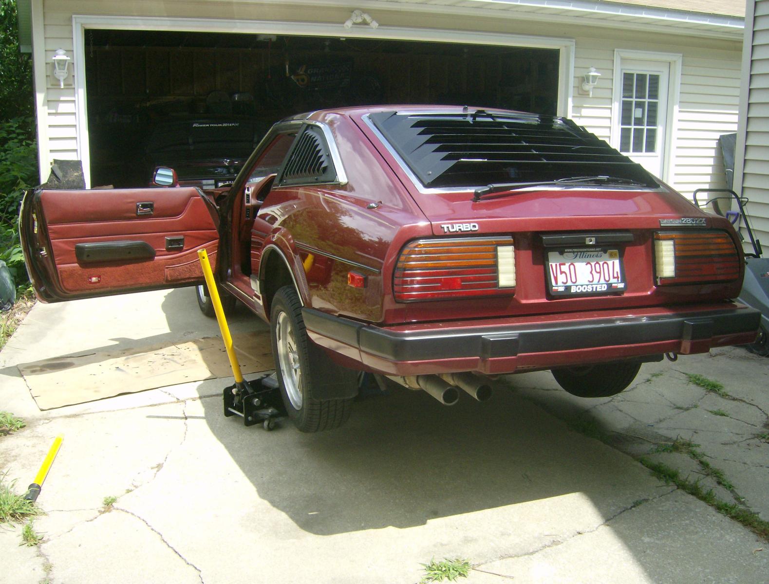

issues I still need to address....float in washer reservoir, no back up lights, and no power doorlocks. Spent a couple hours scraping rust and applying POR-15 today. I put the car on jack stands and it looks like I might have some brake fluid leaking in the rear.
Attached Thumbnails Door locks-hpim2807.jpg   Door locks-hpim2810.jpg   Door locks-hpim2811.jpg

Pics yea !
thanks for the Pics, she looks nice, and you are fully louvered out, Jamal would be jealous, I know he was looking for the rear louvers for a 2+2 for a long time, I think he finally found one, but I don't think he has the side ones, very cool.

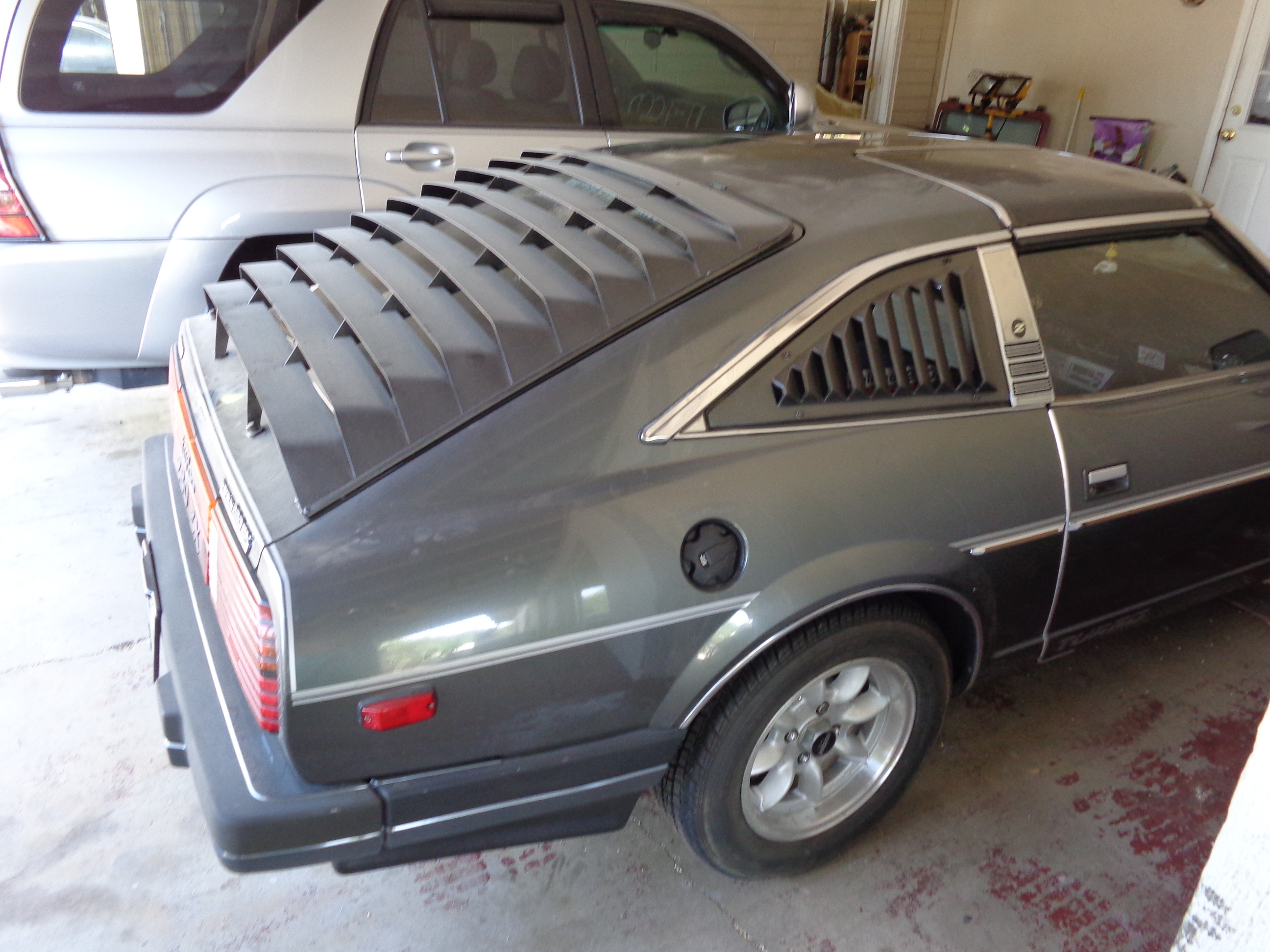

Also I just got some side louvers for my 2+2 and I found a rear louvers not long ago....
