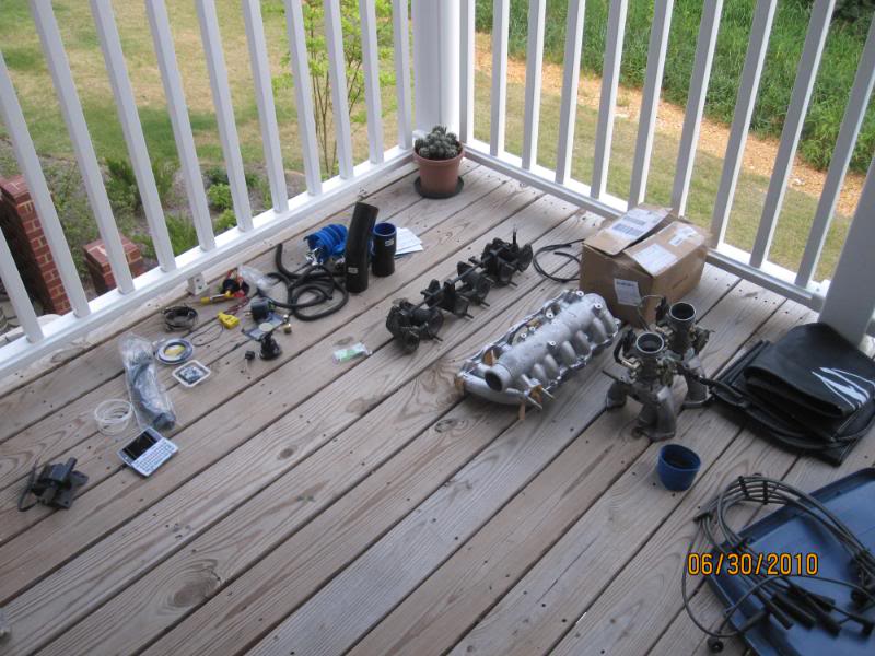

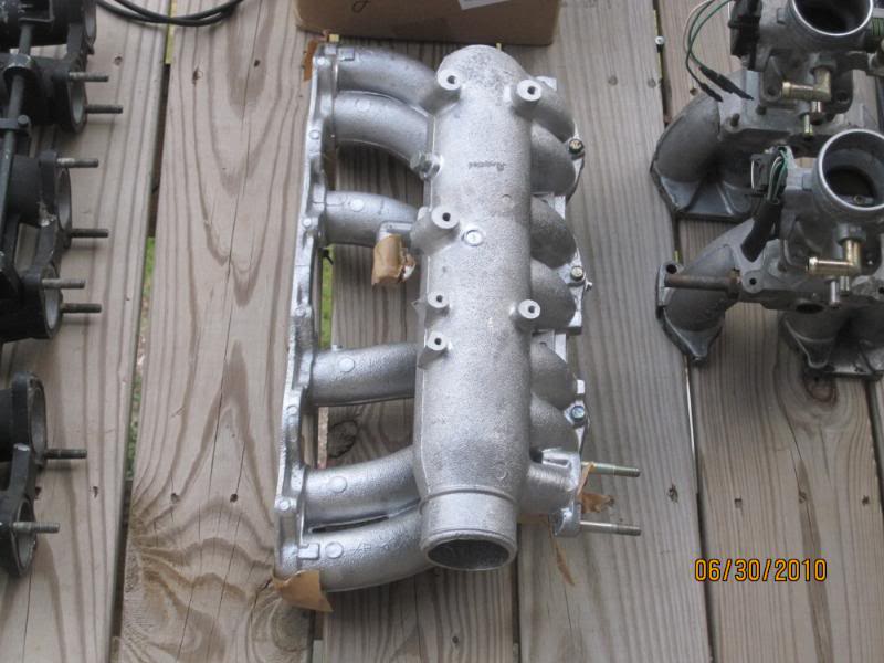

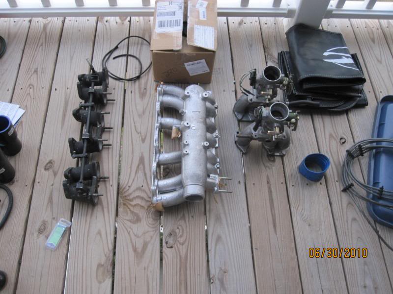

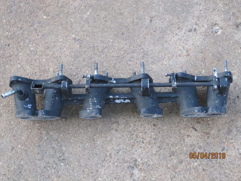

mmmm Endless directions. Not pictured- 3x 40DCOE18's almost ready for powder coating.

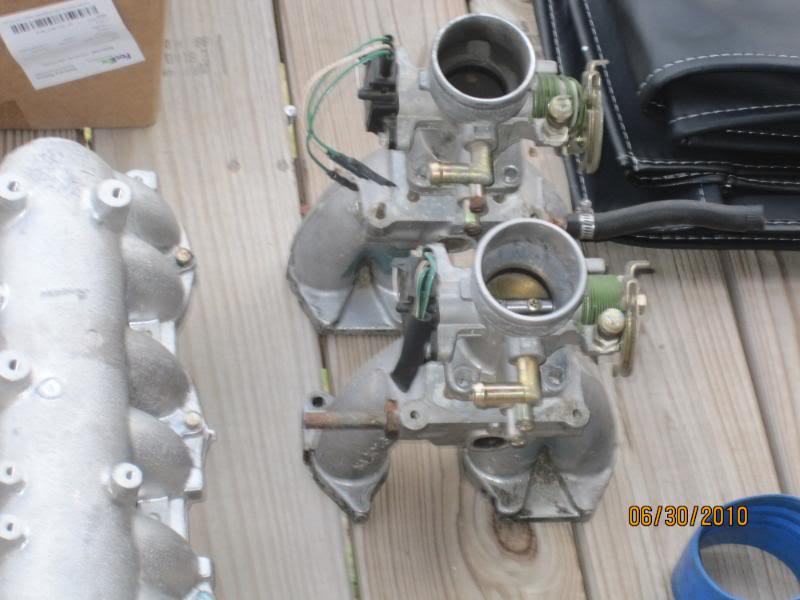

triple manifold, LD manifold, and SU's with Z32(?) throttle bodys, hmmmmmmm

Those T/B's are from a werid brand car. can't remember what one. but i pulled them at a u pull it. i just found one that will bolt up with little to no modd's. The two lower holes will have to be wobbled out slightly, but will not run into the throttle bore. And if i get my hands on a HKS, or a crappy Cartech intake. I will deff do turbo triple.

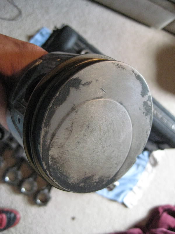

check out these pistons, there Nissan OEM but never available in the US

And interesting... I dont think they work in the newer L28 heads tho.

even with a turbo triple. I'll never part with that LD manafold. Took me to many years to get one. and this one has almost no miles on it. factory bolts still have there color to them

No Im not on ratsun. tho apparently I should be lol
And I've just been kinda daydreaming about getting another Z and building another motor for ***** and giggles
if you pop over there shoot me a PM and we can talk high CR L28's
its easier there since I dont wonder over here to often
why do you think they wouldnt work on newer L28 heads?
they all have 44/35 valves and the smallest chamber is only 44.6 (my E31 is 42.4)
and the highest cam lift with a stock L28 head is 248/248 (L26 E88 comes with 256/256)

Well it looks like it would come up past the desk height and smashed into the head, but I'm not taking into account the gasket so maybe it will work
