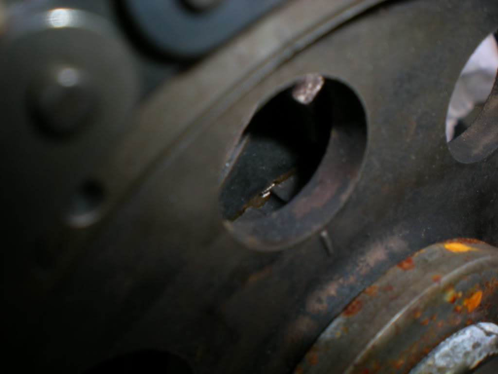

Well I figured Id do this right and get my timing where it should
So the best thread I have found for cam timing is Shady's, I sent him a PM but he hasn't gotten back to me.
But my questions are in regards to his thread about timing chain stretch.
https://www.zdriver.com/forums/showt...+chain+tension
When he says the mark should be to the left, is this that left? Or is this the wrong way and my chain has too much slack?
And if it is as for the directions to fixing the issue what does he mean by "Remove the cam bolt, pump eccentric and cam sprocket and advance it to the next position"?
