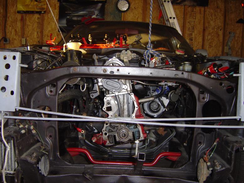

here is a pic of the chain w/ out the timing cover on... this is what you should be seeing. The tensioner in the pic (hard to see) is right below where the hood bars (primer gray) criss cross. It's a steel block w/ a hard rubber piece sticking out to tension the chain.

you can't see the tensioner from that plate. Like I said before, you have to take off the whole timing cover (look at the pic again).
