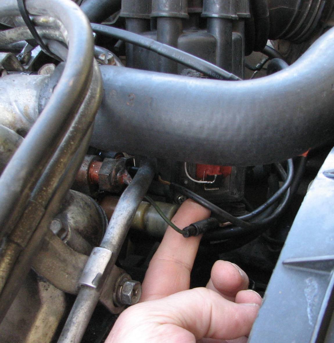

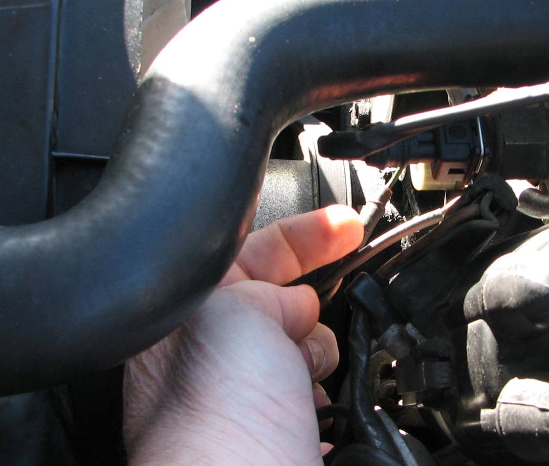

Temp Gauge
Under the thermostat housing is the sensor housing, there are 2 sensors that have the same connector, one on a pig tail, the other plugged directly in, swap those 2 and see if that fixes it, that's what fixed mine, the PO must have worked on it and got them reversed. here are some pics to show exactly what I am saying.
