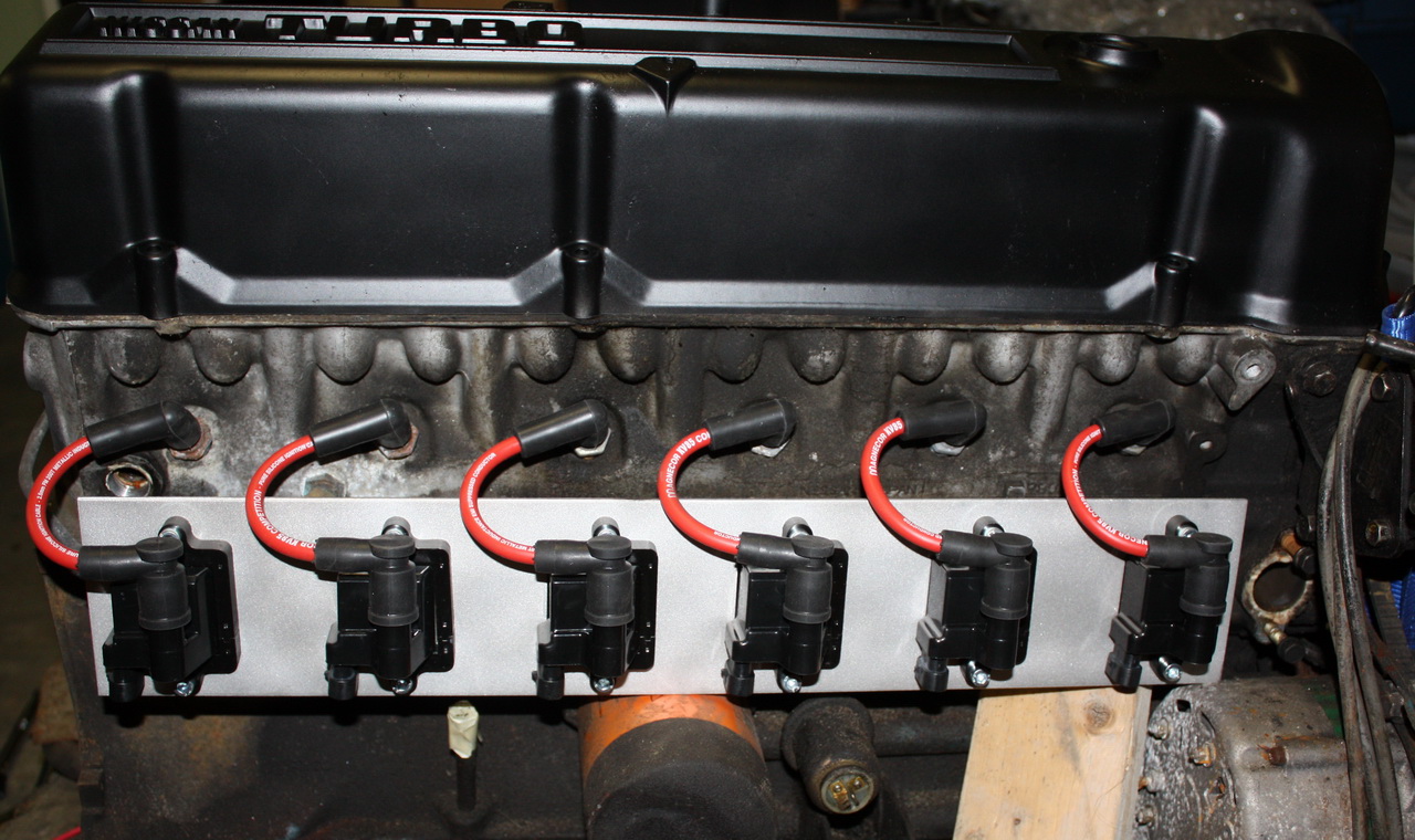

If anything they would need to go together. The angle is a little decieving - the coil packs line up right under each spark plug. The outlet for the lower rad hose is angled back towards the firewall on the ZX but on the 240s it come out almost straight from the block which gives you a little more room.

Oh I meant a tad away from the block so that heater hose goes behind the coil pack plate

...and we have spark on all the coil packs! Going to build a modified harness for the coil packs now that everything seems to be working fine. No RPM signal though when I went to start it... strange. Didn't have the cap on but that shouldn't make a difference..... hmmm....

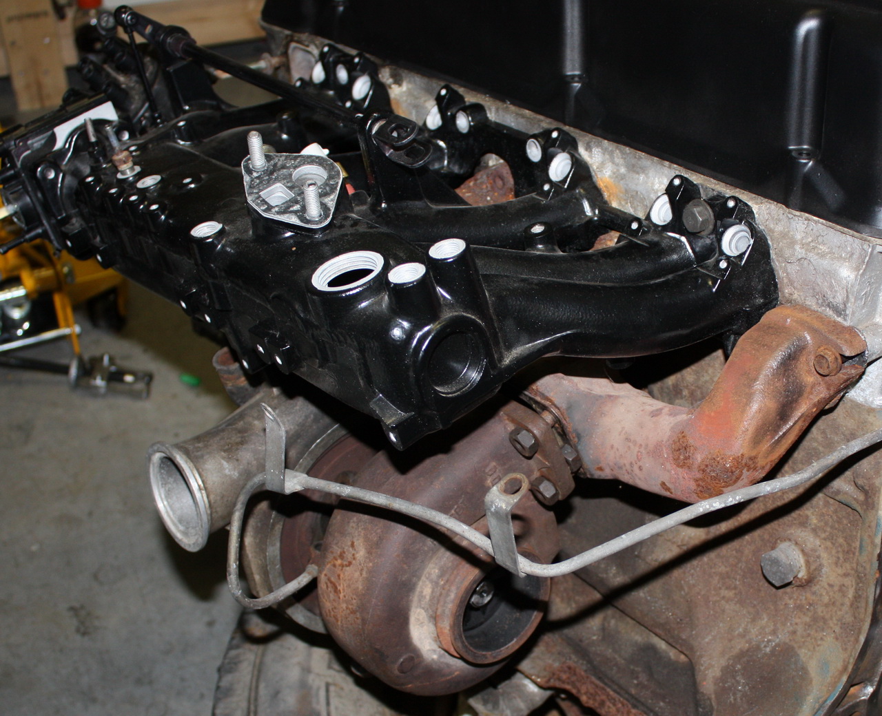

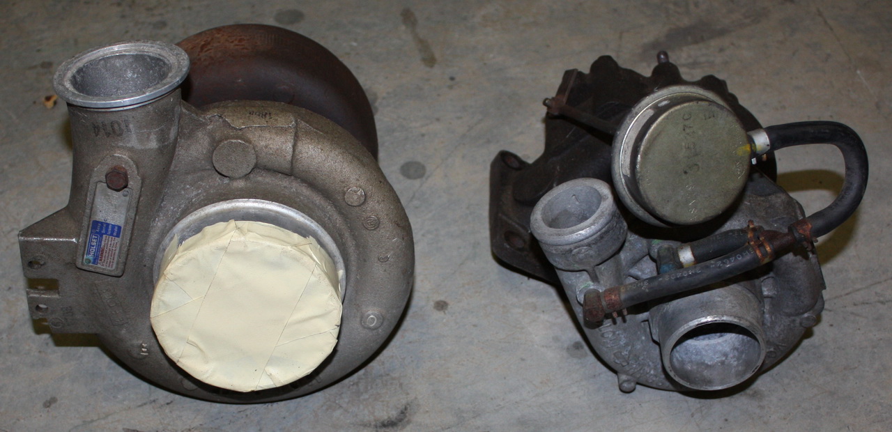

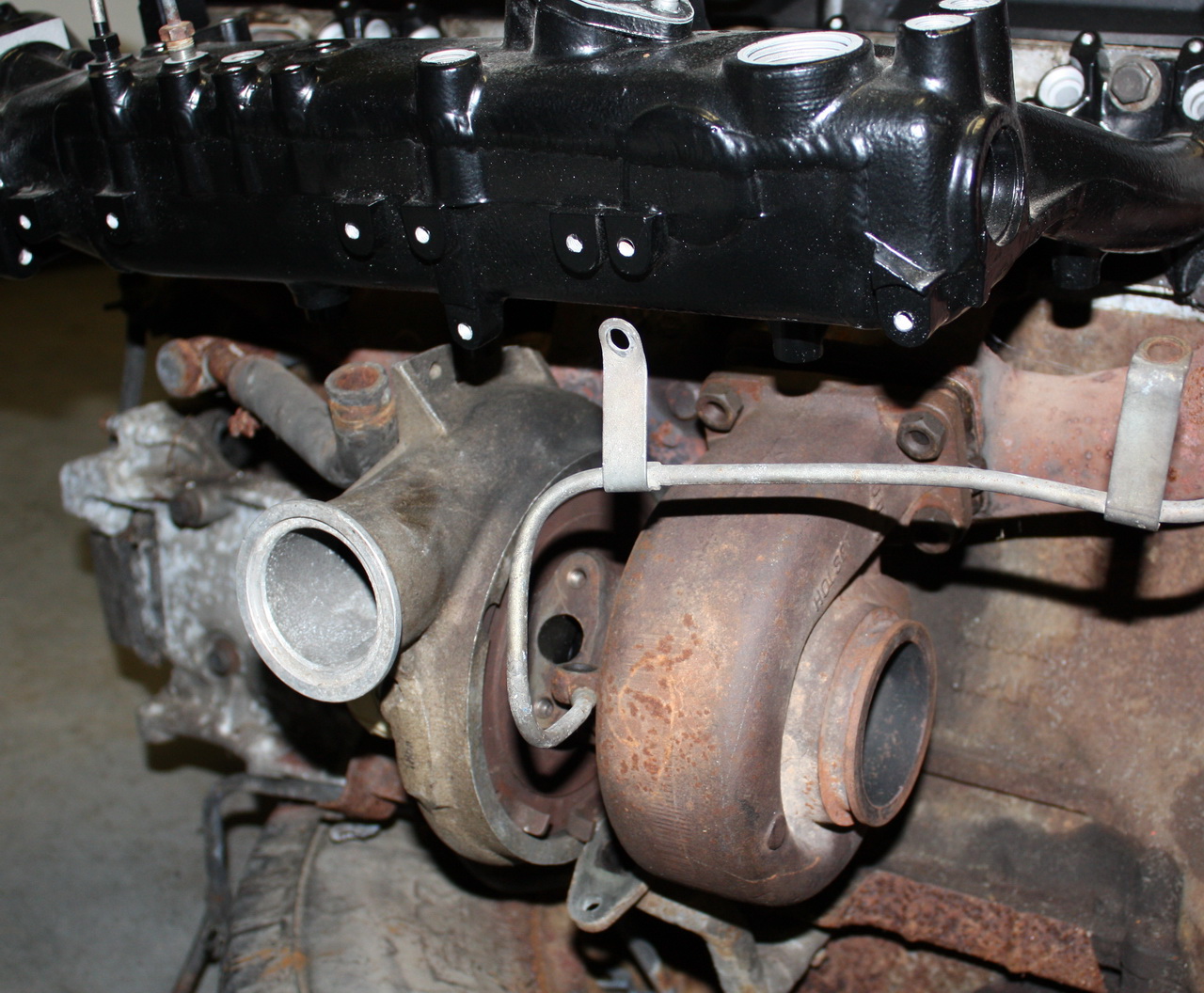

T3 or Holset?

  #107
0h my!
Good luck getting that to fit on the stock intake / exhaust manifold setup.

  #109

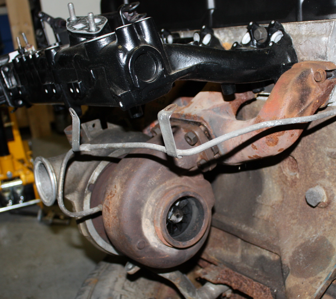

From: Victoria, BC
I figure a 1/2" spacer should do the trick with some longer studs.... hmmm only one way to find out. I'll need an external wastegate though....

  #110
Clocked like that you'll have to make a sharp 90* coming off the turbo though. My T3/T4 hybrid is clocked like stock and there's about 1/8" between the housing and bottom of the intake. Are you going to cut into the manifold for a wastegate port?

From: Victoria, BC
Yea it's the stock clocking from the Dodge it came off of. It would obviously need to be clocked so the oil inlet/outlet is verticle for starters. The first issue is finding a flange that will mate up to the exhaust because it's not a normal 3" outlet.... sigh....

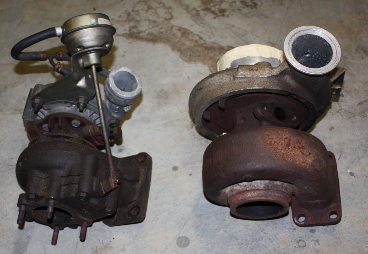

The Big, The Bad and the Itty Bitty....
"Cleaning" the garage (aka moving stuff around so you can get at something then piling it up somewhere else).

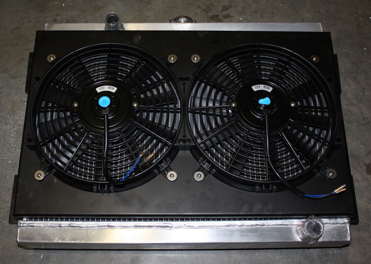

Dual 12" fans that will be controlled by Mega Squirt. I also have a relay circuit set up that will run them in series for low current draw/low speed or in parallel for hurricane force winds....

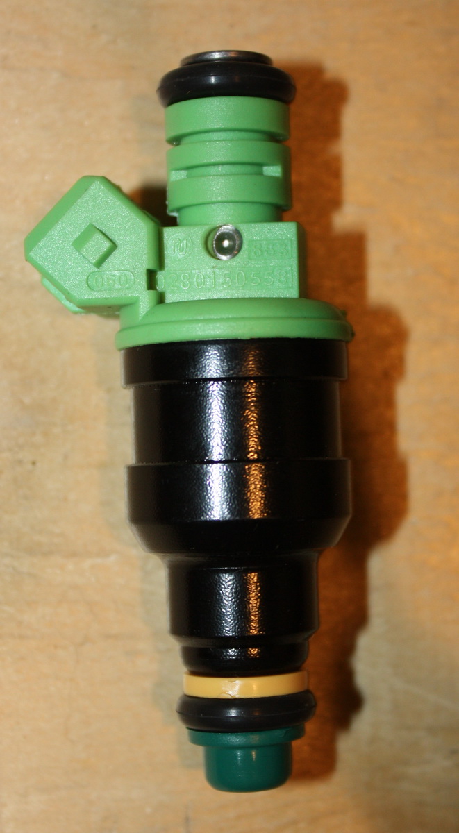

From: Victoria, BC

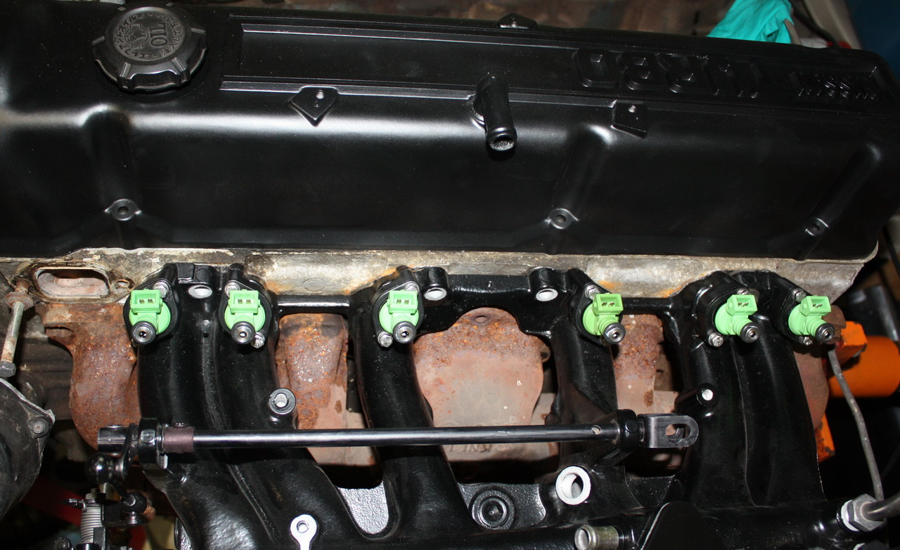

440cc "green top" Bosch injectors awaiting a fuel rail. The moron in charge of this project ordered in an 11mm rail before he ordered in the injectors then ordered 14mm injectors.

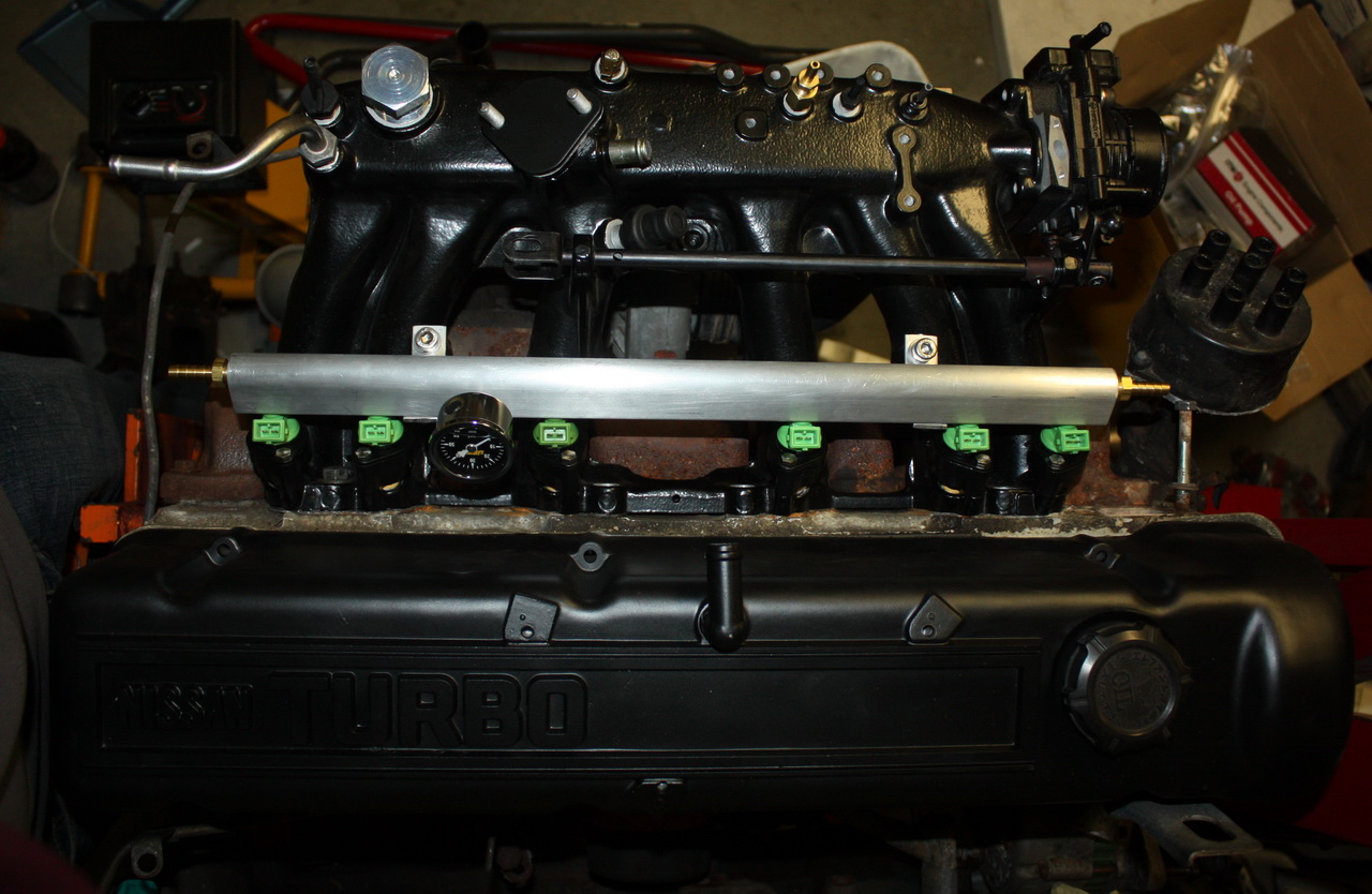

From: Victoria, BC
Rail mounted with fuel pressure gauge on the side. I think in the future I'll just run a fuel pressure sender instead.

  #123
Did you change the pintle caps? Or how did you get those short hat pintle caps to seal properly?

From: Victoria, BC
Hmmm I assumed it was the o-ring that made the seal?

  #125
Ah, They did seat all the way down?
I had a set of those style short pintle cap injectors and that top lip of the pintle was too big for the manifold injector port. Looking at your pics again, it does look like they seated all the way down. Are those 440's for the Mercedes?
