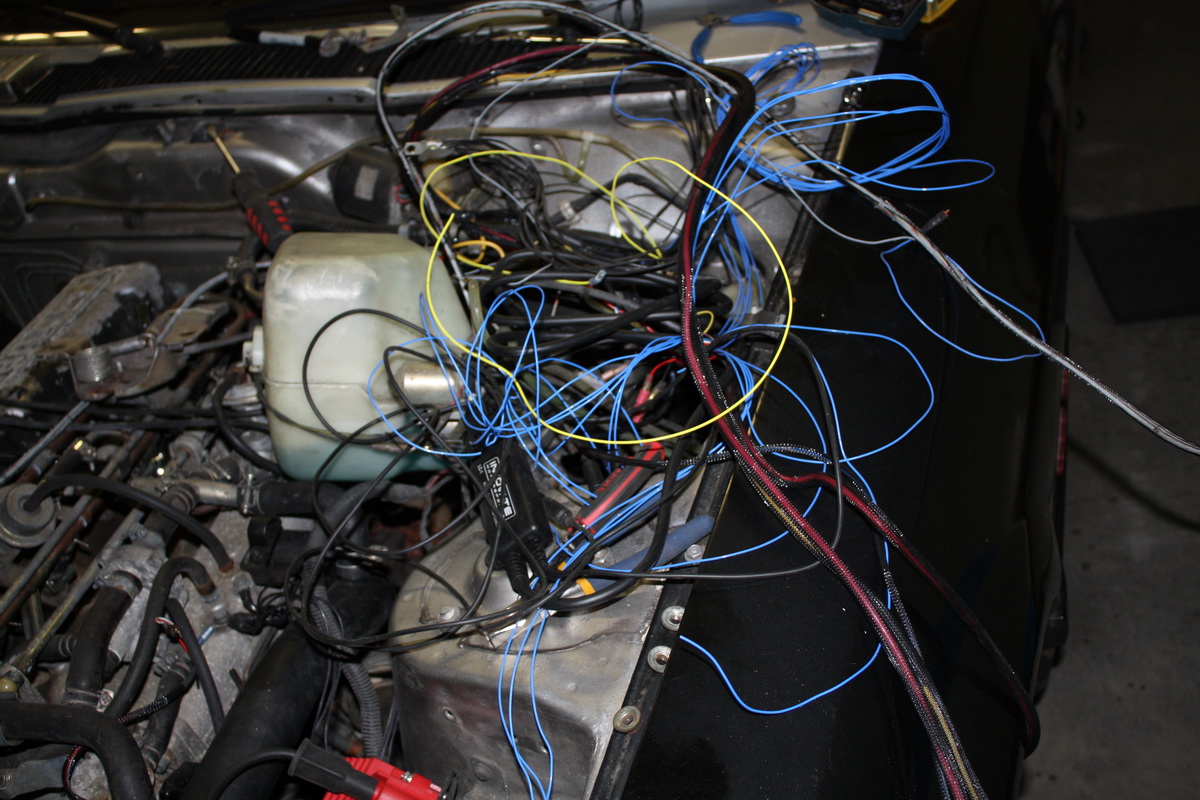

Some would call it a mess - I call it progress!
No AFM or Vacuum Control Modulator and brackets. I'll bet I lost 10lbs just removing this junk.
...and my new get-the-harness-done inspiration. Thanks Yasin! We're busy working each other into an S130 modding frenzy
Attached Thumbnails 280ZXT - wasn't going to be a project...-harness-mess.jpg   280ZXT - wasn't going to be a project...-no-afm.jpg

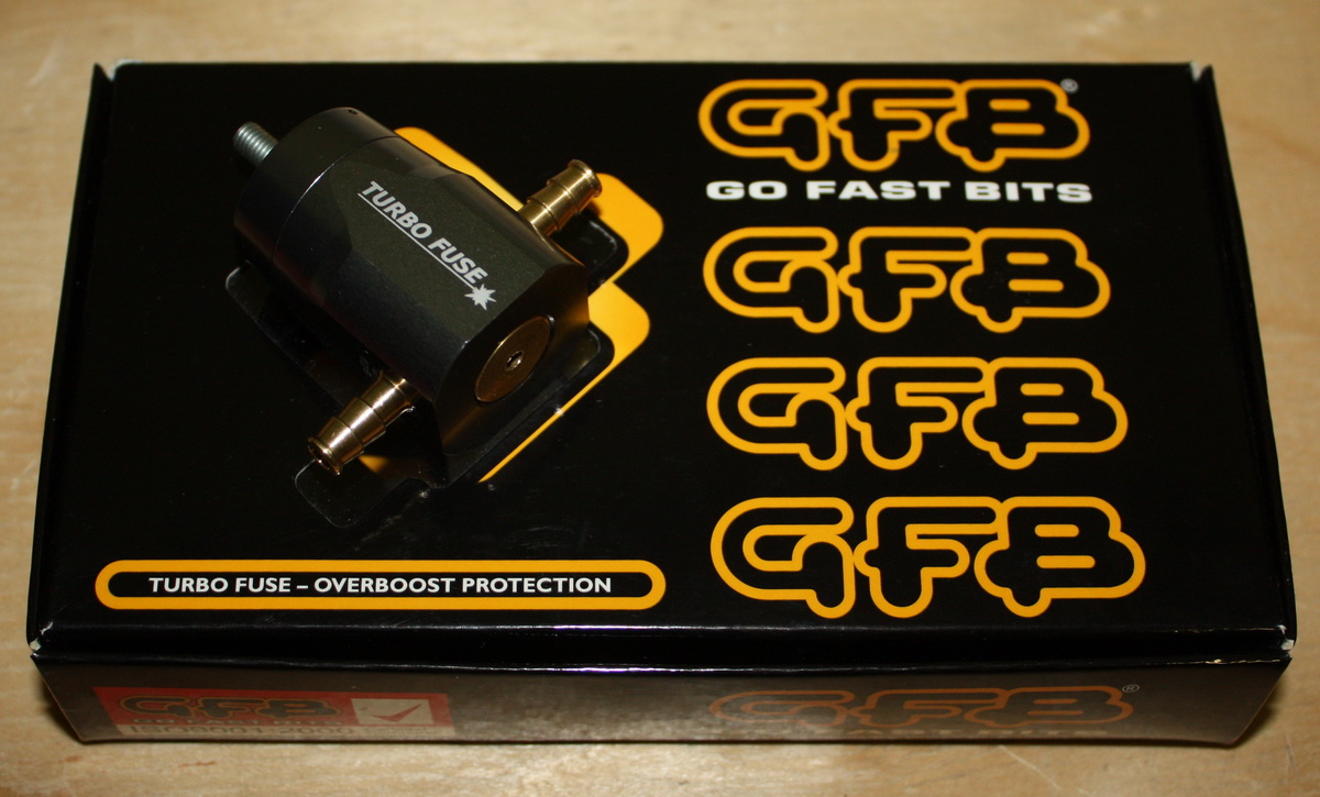

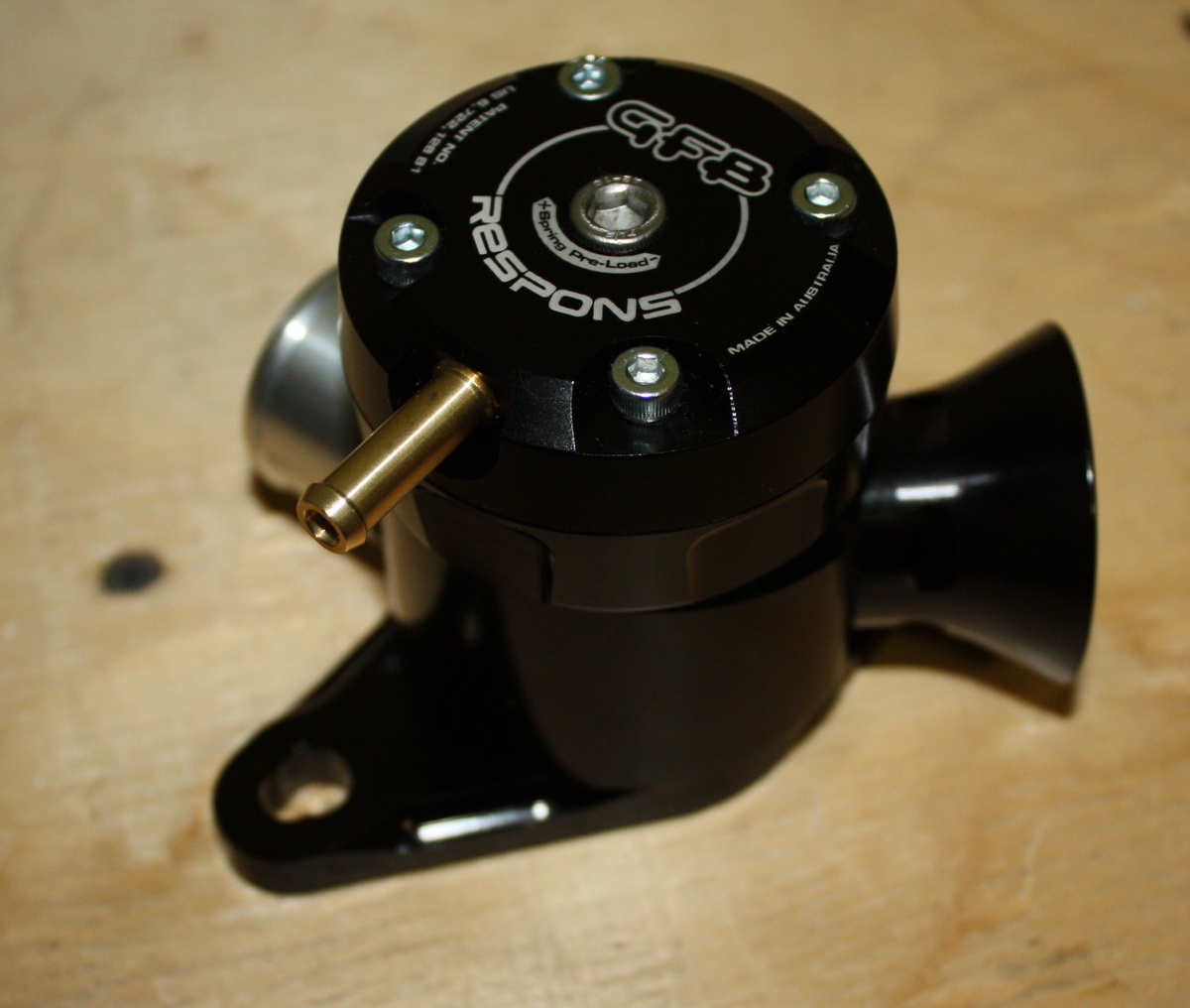

Ohhh my Christmas present finally showed up
Go Fast Bits Turbo Fuse (use your BOV as a Pop Off valve - why don't we see these on every turbo car?)
.... and my fully adjustable Recirc/BOV again from GFB. I plan on running a recirc to keep the turbo spooled and partial BOV to run in conjunction with the Turbo Fuse. I really like the GFB as it's the only fully adjustable Recirc/BOV I could find not to mention great fit and finish.
Attached Thumbnails 280ZXT - wasn't going to be a project...-turbo-fuse.jpg   280ZXT - wasn't going to be a project...-respons-bov.jpg

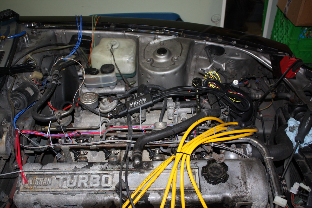

From: Victoria, BC

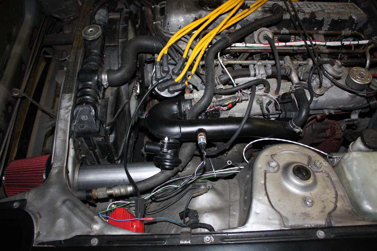

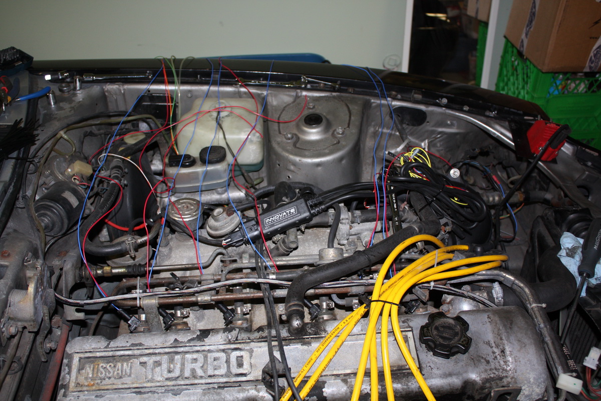

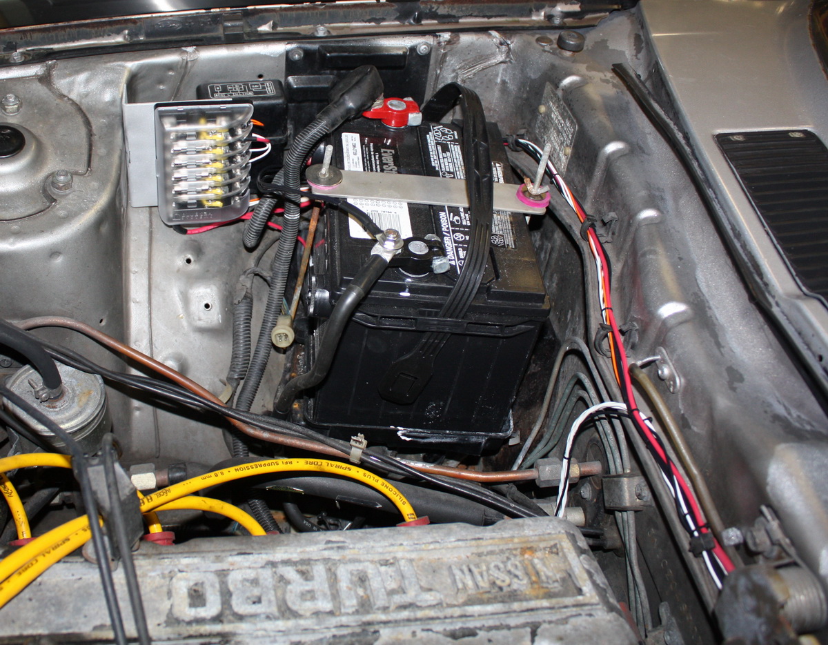

Wow I've put a ton of work into a little bundle of wires over the last two weeks but I've had some really great sucess with it all. The MS3 is running great! Went out for another test and tune today. Told my buddy that the car was running better than I've ever had it run but it felt like I needed new engine mounts as the engine was shaking a lot at idle. He kept saying it was like it had a dead miss. Anyhow we had stopped for coffee and were going to continue our run when we decided to pull the injector plugs one at a time. Pulled injector plug 6 - worse, injector 5 - worse, injector 4 - no change! Put it back on half way and it was smooooth.... arg corrosion on the injector - new injector plugs on the harness doesn't matter if the plugs on the injectors are corroded Wow the car is a new beast and I've only put on a cone filter, removed the AFM with a piece of pipe and a crush bent 3" exhaust all held together with the MS3. Pretty impressed how smooth and how much more power I've got by the butt dyno and no dyno tune either.
Here are some pictures - it's a pretty close to final product running prototype for the harness.
Attached Thumbnails 280ZXT - wasn't going to be a project...-wiring-harness-prototype-04.jpg   280ZXT - wasn't going to be a project...-wiring-harness-prototype-05.jpg   280ZXT - wasn't going to be a project...-wiring-harness-prototype-06.jpg

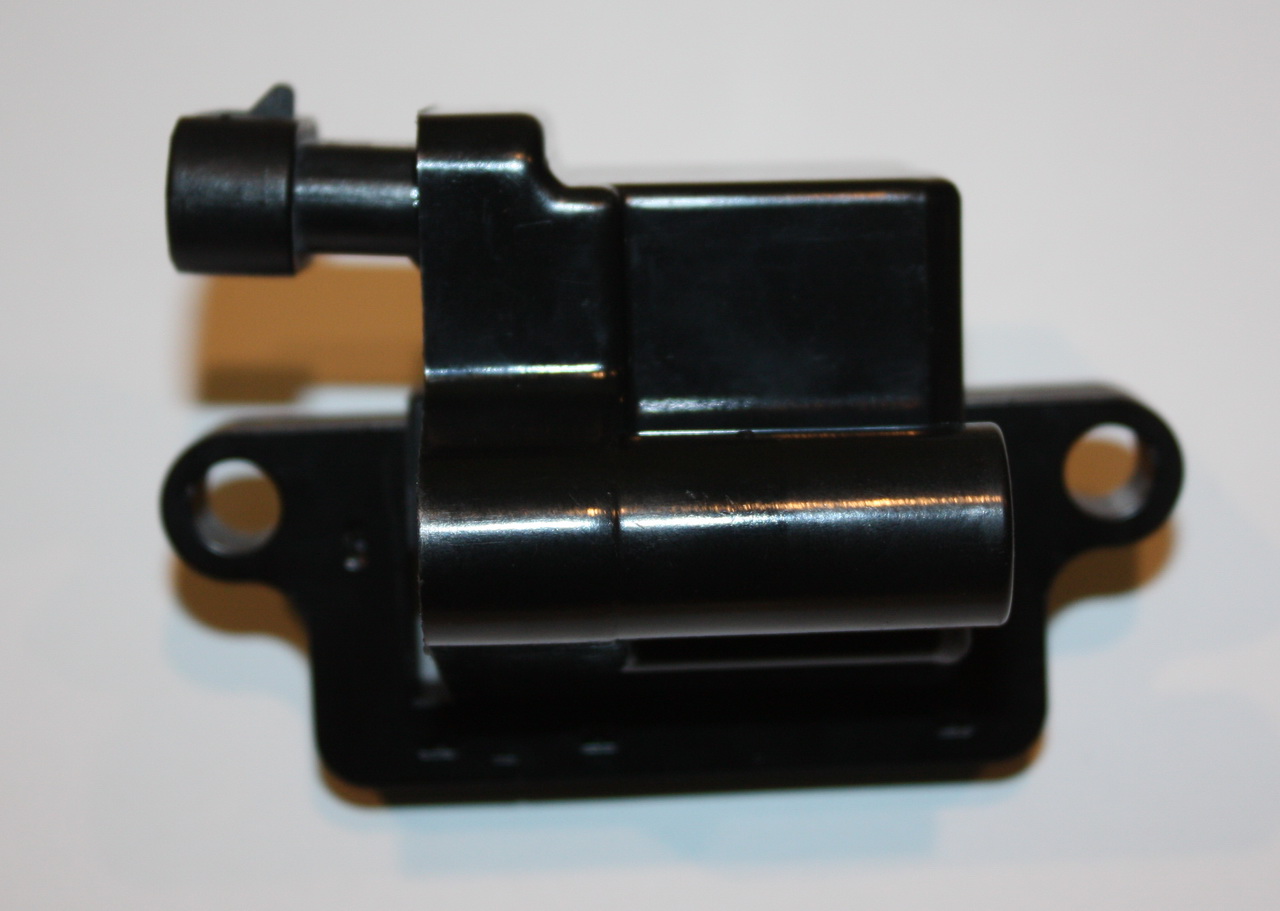

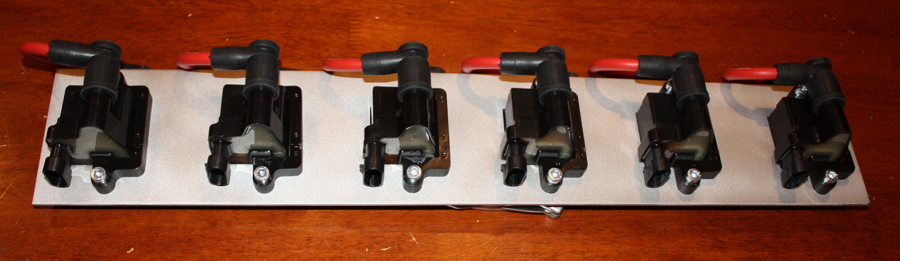

Is there by chance a plan to add coil packs into a future harness? If I go MSnS, I'd like to go coil packs.
Old Feb 6, 2012 | 05:26 AM
  #92
From: Victoria, BC

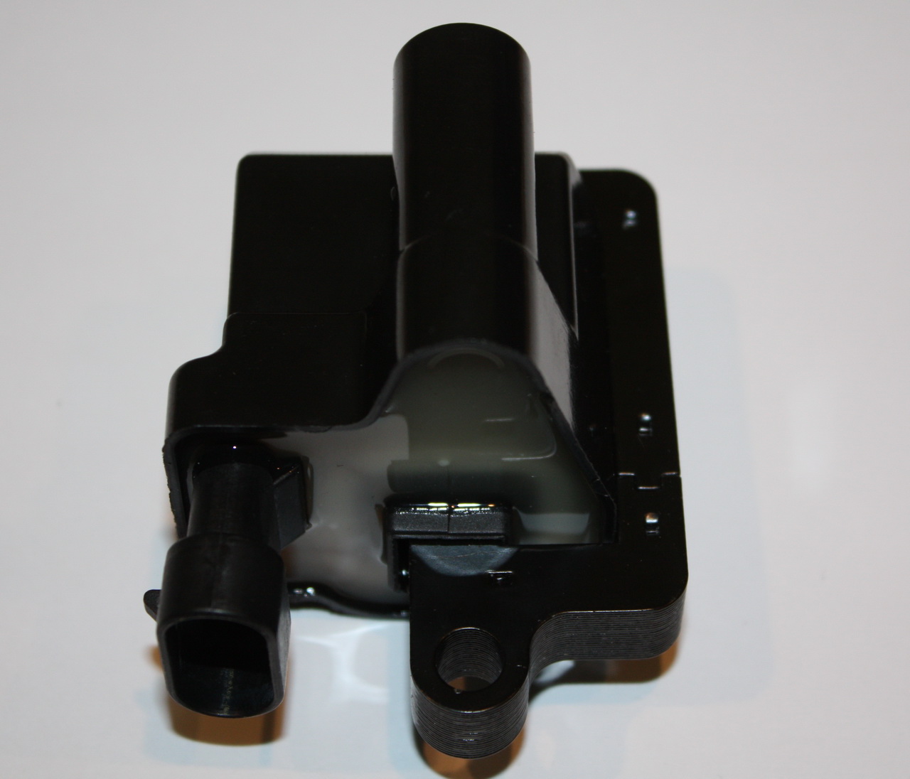

You mean for the six LSX coil packs sitting on the shelf beside me? You bet! I just have to get the diyautotune optical wheel for the L28 they just came out with for the distributorless ignition/sequential injection setup.
Attached Thumbnails 280ZXT - wasn't going to be a project...-lsx-coil-1.jpg   280ZXT - wasn't going to be a project...-lsx-coil-2.jpg

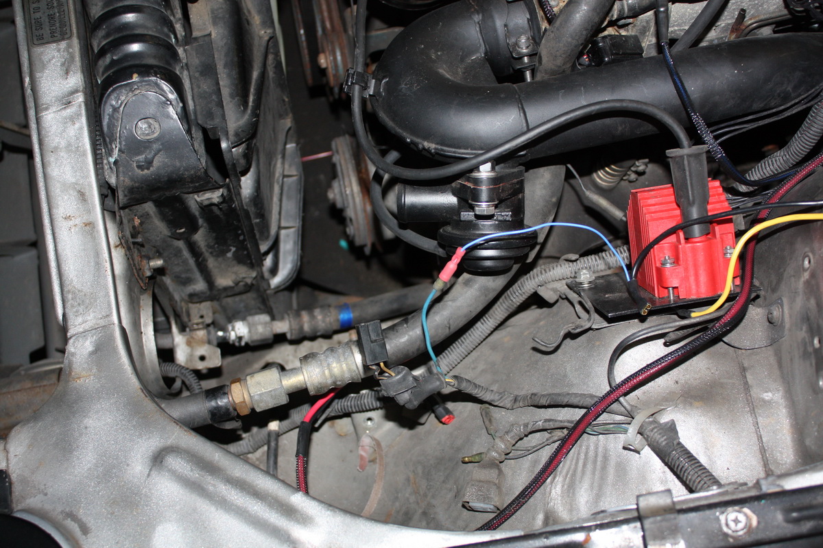

From: Victoria, BC

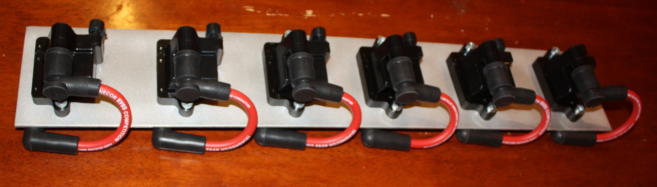

Coil Near Plug setup with LSX coil packs (truck) mounted on plate. Have to re-route some water hoses to make a little more room for a nice clean install....
Attached Thumbnails 280ZXT - wasn't going to be a project...-cnp-01.jpg   280ZXT - wasn't going to be a project...-cnp-02.jpg

From: Victoria, BC

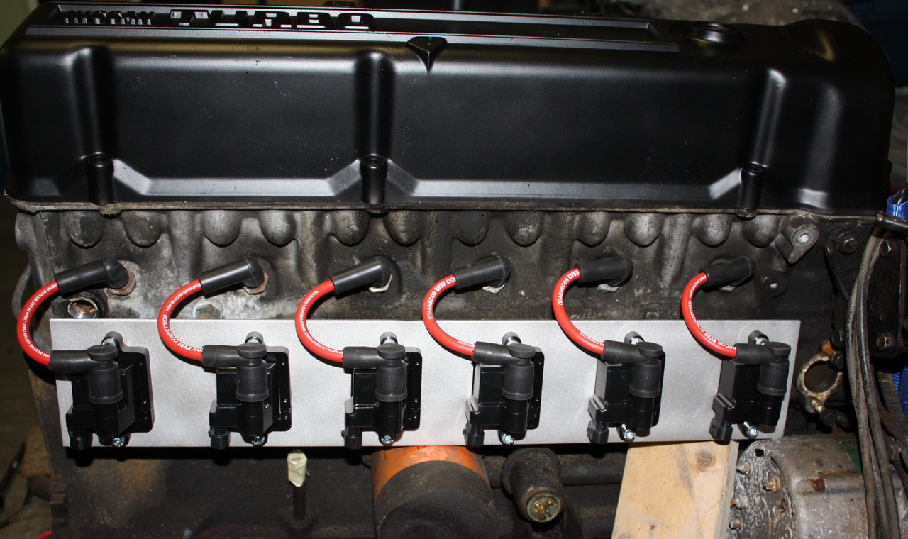

Trying to figure out how to mount this. I think I'm going to have to re-route the heater hoses a bit.... Just mocking up on a spare engine in the garage....
Old Feb 16, 2012 | 07:38 AM
  #100
You could space it out a tad to make room or go high mount off the valve cover.
