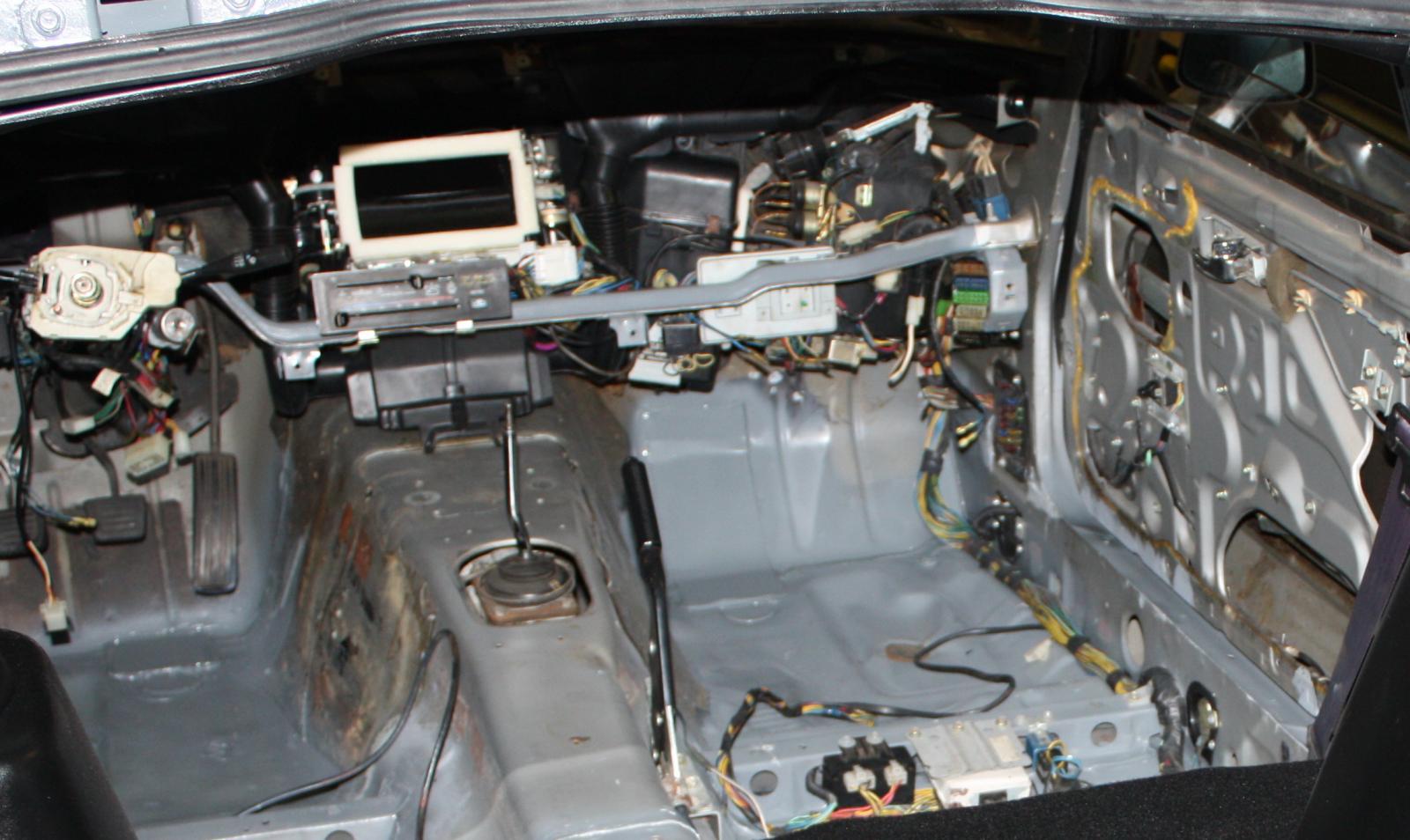

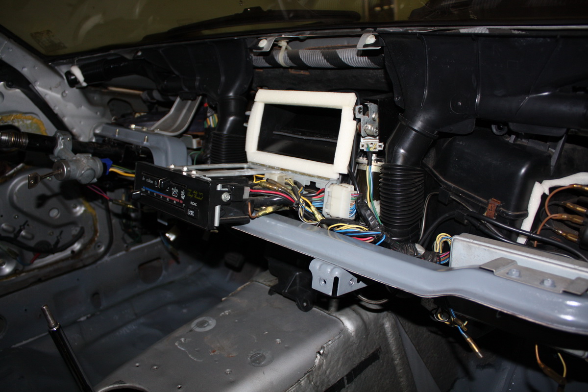

Completely refurbished climate control system....
Attached Thumbnails 280ZXT - wasn't going to be a project...-interior-progress-01.jpg   280ZXT - wasn't going to be a project...-interior-progress-02.jpg   280ZXT - wasn't going to be a project...-interior-progress-03.jpg   280ZXT - wasn't going to be a project...-interior-progress-04.jpg
Old Aug 11, 2011 | 07:56 AM
  #27
Nice! I hate that stock black goo foam in between the control units. Is that just generic weather stripping that you used?
Old Aug 11, 2011 | 08:21 AM
  #28
From: Victoria, BC
It's open cell foam the use for weather striping. I got mine from Home Depot. The closed cell is too firm. It is a night and day difference in getting the air flow to where it needs to go. It blows like a hurricane now. I used the closed cell foam inside the climate control for the doors, etc. It's lower profile and it tends to mold to what it's pressing up against. I think they also use the closed cell foam on the edge of the box on a pickup truck between the box and the canopy. It works great on the back edge of your side windows (down the rear pillar on the weather strip) where you get that whistle from the weather strip gap....

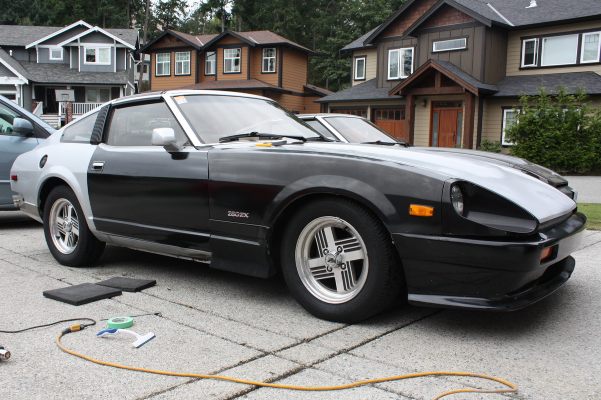

Replaced the front fenders with some I pulled off a parts car. The parts car had side skirts welded to the car so I sawzalled the fenders and left part of the side skirt on the fender. I've got another set of fenders I'll put on the car but for now I've thrown the black fenders on and front air damn to see what the car looks like black and silver. Oh and I threw the hatch on from the black car as well since the shower of rust every time I closed the rear hatch was starting to get annoying.
That didn't look too bad so I started doing some vinyl wrap on the doors...
Driver side done....
Attached Thumbnails 280ZXT - wasn't going to be a project...-no-vinyl-wrap.jpg   280ZXT - wasn't going to be a project...-vinyl-wrap-door.jpg   280ZXT - wasn't going to be a project...-vinyl-wrap-driver-side.jpg
