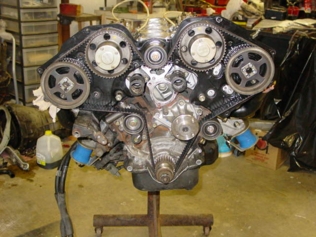

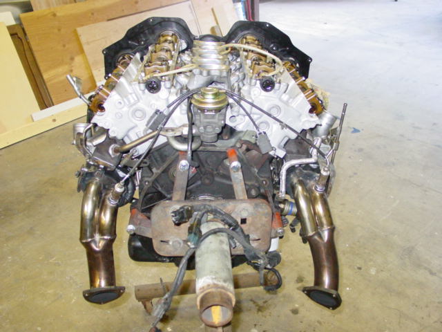

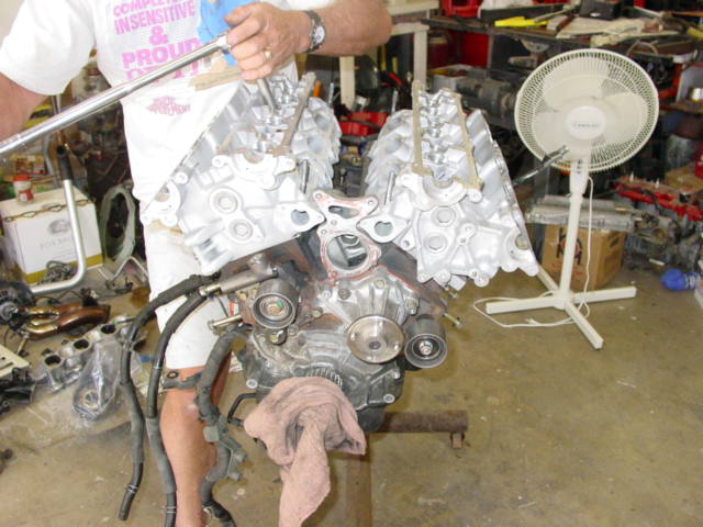

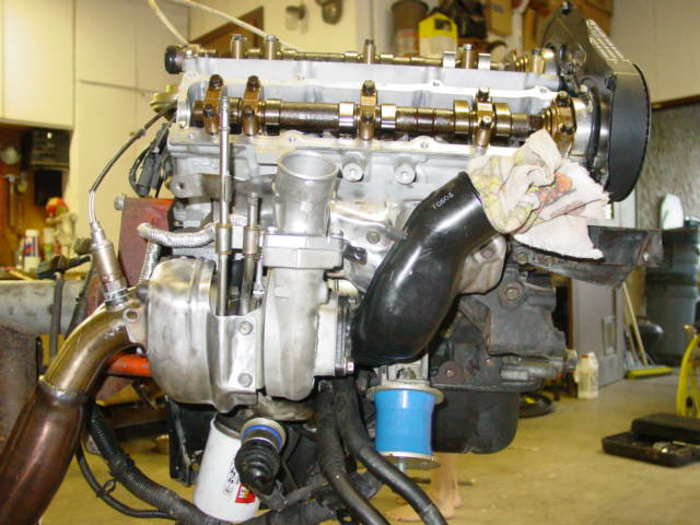

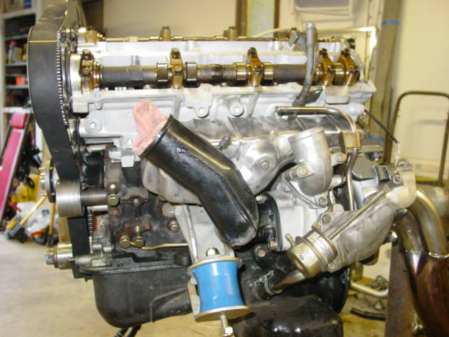

I just need to put the EGR return tubes back on, run the EGR vacuum line, connect the turbo coolant lines, then the tranny is ready to be bolted back on, then it goes back in the car. Once it's back in, then we put the power steering pump, alternator and AC compressor back on along with the rest of the other miscellaneuos stuff. We should be able to have it back in next weekend. Maybe I will be able to drive it for my birthday. It would be just about the one year anniversary on when it failed smog and all this work started.

REALLY nice looking. I wanna build a motor. Those cams look funny, not enough lobes or something..... I know I'm used to single cammers.

i'm thinking to myself, good thing you can't see the block from the top of the car because those heads are just putting that block to shame. SO DAMN CLEAN!!!

yea, I was kinda thinking that same thing. Why didn't you ahve the block cleaned and maybe repainted?

Didn't feel the need.

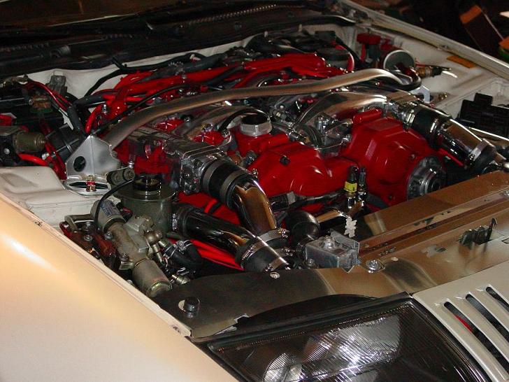

I drove it home earlier this week. I still have some minor adjusting to do (TPS & boost controller mainly). I haven't gotten on it real hard yet; i.e. I haven't put my foot to the floor, but wholly sh*t is it fast. Huge difference. The new turbos are so damn quite compared the stockers. I'll take it to the dyno in a couple months. I want to put some miles on it 1st.
The 1st start up didn't go without a few tense moments....1st off, after 1 year of sitting, the battery decided that it wouldn't hold a charge, or even start to charge, so I had to buy a new one. With the new battery in, it started on the 1st try. About 5 seconds in, it started making a very bizarre noise, followed by a puddle of oil on the ground. Turned it off in time, so there was no damage. With the new turbos, Z1 sent me new oil feed lines as well. In the drivers side feed line there is a distribution block that has a plug threaded into it. Z1 didn't have the plug in the new line, so we had to take it off of the old line. Lame. Put more oil in it and it started right up again.
As we began adding ATF in to the Power steering reservoir, a puddle of ATF formed on the ground. The reman power steering hose had a leak. Z1 shipped it to me without tightening a fitting. We tightened it, added the fluid and now everything is good.
I'll drive it for a few weeks, then take it in to get it smogged. Here's a couple pictures. I added chromed water pipes and painted the timing belt covers since the last time I posted pistures. It looks even better in person.

Looks awesome. Are you sure you're gonna wanna drive it and get it dirty? It looks SOOOOOO clean. Besides the mods, I'm sure it feels fast since it's been a while. Can't wait to see what the dyno numbers are.

Looks good 91! One of my favorite color schemes. Hopefully you'll pull some nice numbers.

See...toldja it'd look good with the timing covers painted.
Looking absolutely drop dead gorgeous.
