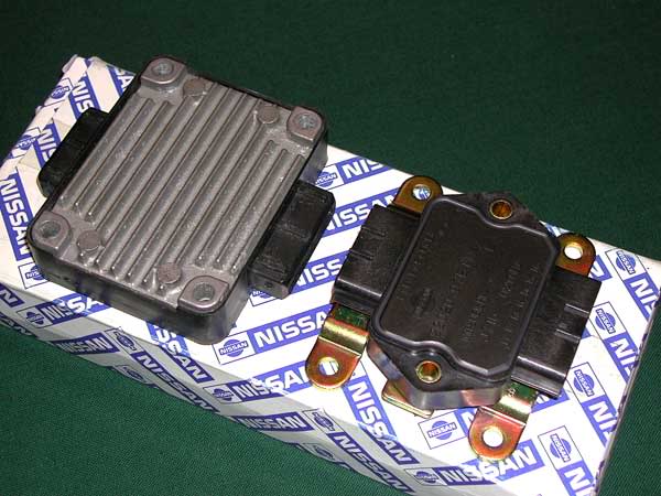

Sound just like a PTU fault. Do you have a series 1 or 2 PTU? Located on the left front timing cover (unless the US cars are different).

Series 1 on the left (trouble) or series 2 on the right (good one)
