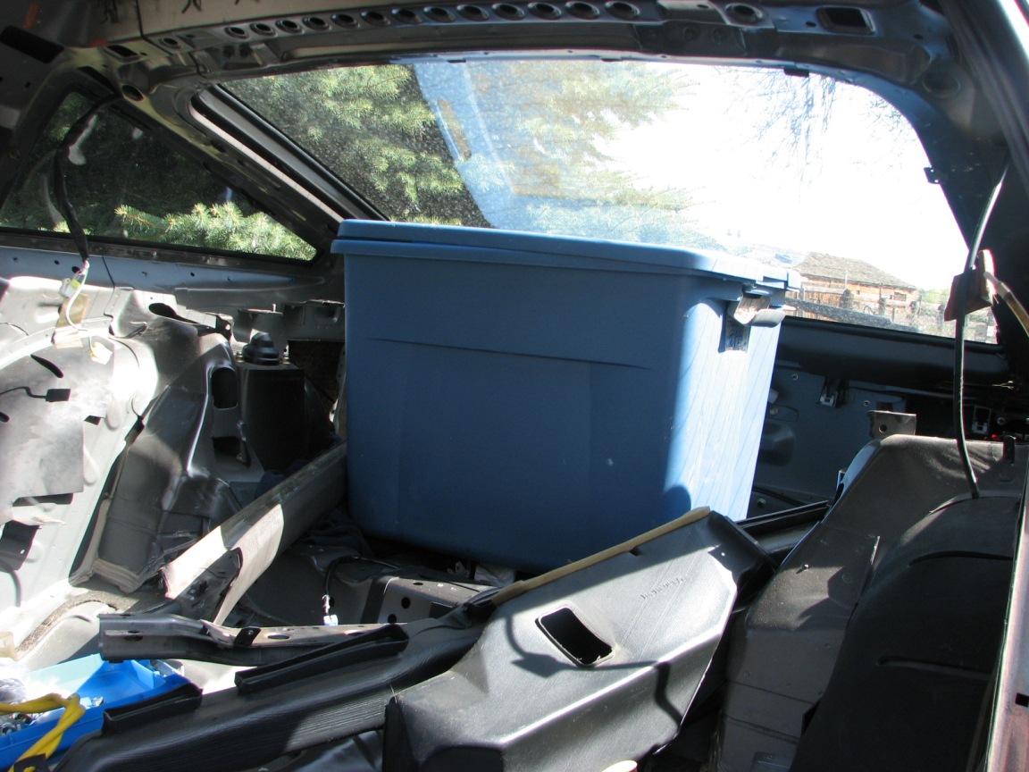

There's a plastic clip you have to get you hand in there press on both sides and it pops out, not easy but doable. Minus a little skin and half a dozen cuts later. Better than last week, nicked an artery 8 stitches and about a pint of blood later the VA had me fixed up, kinda set me back a week. But now there isn't a bit of the interior left, just sheet metal and the harness in a heap.
