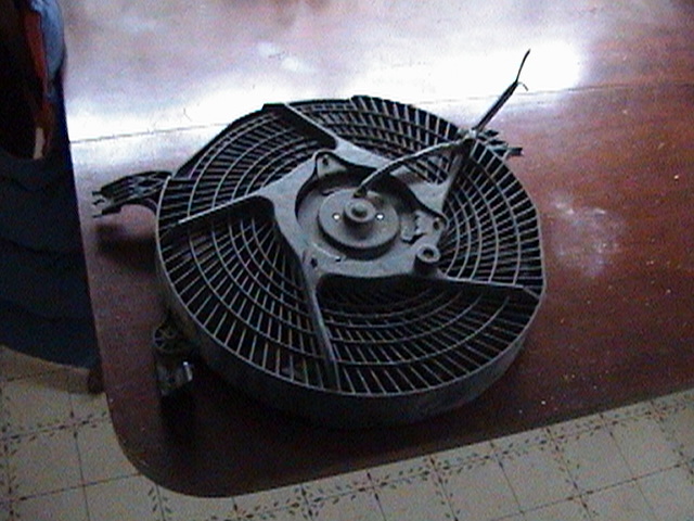

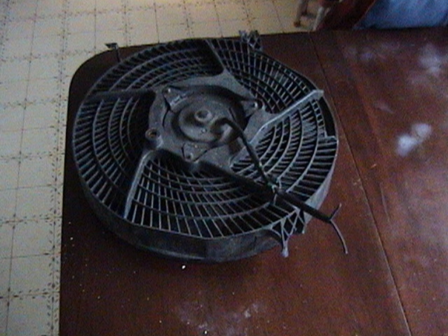

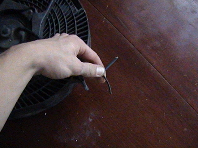

heres the fan, the wires are blue and black. which ones positive....i think it should be big enough to keep it under 180*...i hope so in cali heat. and how do i hook it all up. use the black wire to the fan as pos. the just set up a relay/switch and what not.
Attached Thumbnails WreckedJ30's Z31T ecu conversion-dsc00403.jpg   WreckedJ30's Z31T ecu conversion-dsc00404.jpg   WreckedJ30's Z31T ecu conversion-dsc00405.jpg
Old Dec 10, 2006 | 10:02 PM
  #86
Black is neg, blue is pos. You gunna ziptie that to the radiator?
naw i'll just use speaker wire like thxone, haha. No i was going to fab. up some bracketry but now its snowing and am just going to have to wait til cali... And black is neg on which? the fan or the unused maf wires?
Black is neg on the fan... we were only talking about the fan wires. And there shouldn't be any unused maf wires. I believe you are talking about the 2 sets of blue & black wires I chopped from the egr & aac actuator plugs? The black w/ white stripe is + ignition source, so you'd use that to turn on the relay.
