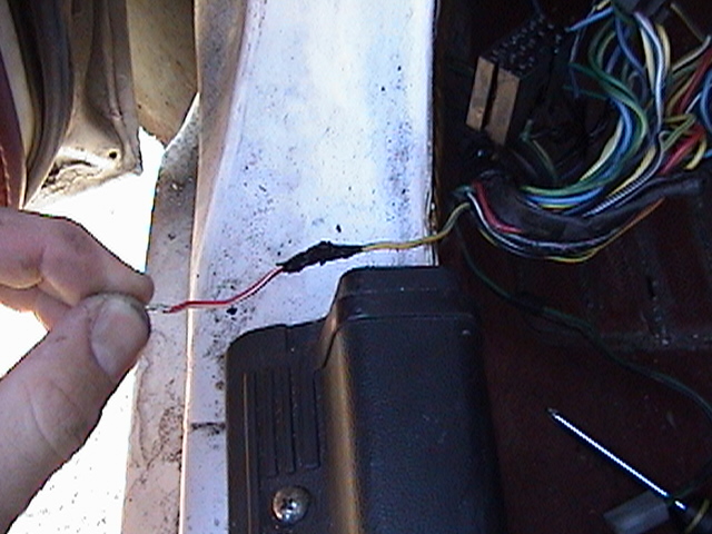

ok heres the picts i was talking about, it's a yellow blue to red/white, red/white is the one from the z31 plug. So wheres it go and how do i fix it, dam that sucks huh.

k... that wire plugs in to slot #12 on the ecu plug. You will see the slot #'s at the base of the plug where the wires come out. Make sure it goes back in the right way & that it won't slip back out.

cool, it just cliped right back in, nice. i haven't started it yet, cause the spark plugs were soaked and are drying off. I'll let you no though, and where the 12, is suppose to be, is the clippy mark yes, i hope so.

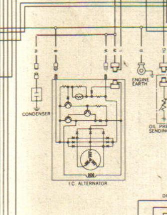

so no one has a pix. of the back of an alternator...oh and nismo, can you help out dgriffin, starter prob...and how much would it cost for you to weld up a down pipe or two for me? My car seems better, but shivvers still, miss? or what. Hasn't died yet but i haven't gone for a drive either.

Attached is a pic... from the Haynes manual. I assume you are talking about the condensor? It should have a connection & just bolt to the alternator.

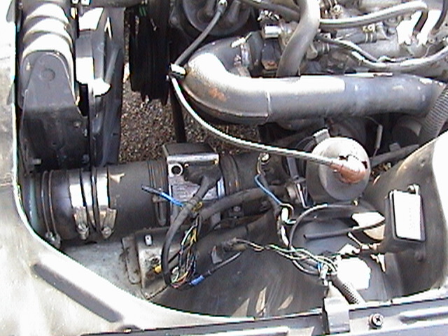

that picture is hella confusing, if i snap a pix, can you just tell me if its, right! That'll be easier. So what would like, engine shivering be?

Yep... it's the condensor. I don't really get why you are worried about it... just leave it the way it is, and it'll be fine. .05oz of weight won't make much difference.

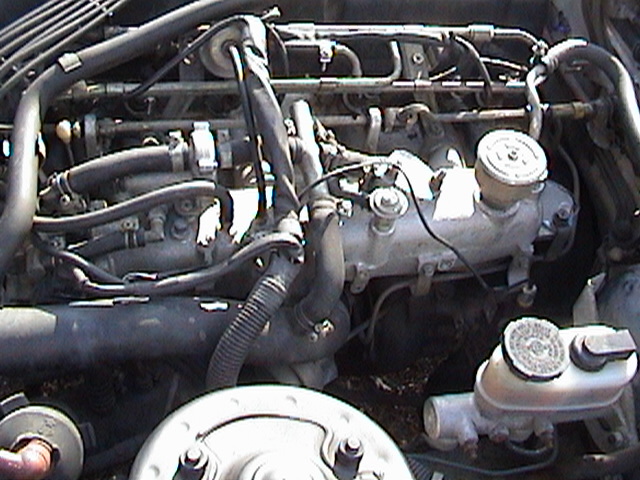

Engine shivering... are you sure you capped off the egr & aac correctly? There could be a massive vacuum leak. Take a pic of your engine bay... I want to see what it looks like right now. Maybe I can spot a prob.

ok i'll go get a pic right now

When you took out the egr & aac actuators (from below the AFM) did you cap EVERY vacuum tube? There should have been one going to the boot between the AFM/MAF and turbocharger. Make sure there are no openings or loose tubes there. Also... you left the boost sensor on, but I can see the vacuum tube hanging disconnected. That originally hooked to the tubes running on the side of the intake. One of those tubes connected to a port on the intake. What did you do w/ that port?

grinder+jb weld works well. Yeah i was going to take it off(boost sensor), but couldn't unscrew it..rusted stuck, but it'll be gone before long. And a bolt went into the hose from maf into turbo, then clamp over it...could it still be leaking...naw, but i'll check.
