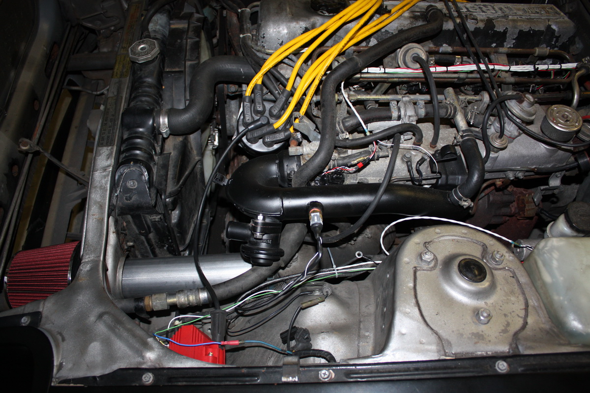

You already have a CAI on your car stock from the factory. If you want to get rid of the gigantic air box rip it out get a piece of 3" pipe and a 3" diameter cone filter and voila replacement CAI. Here's a pic of mine without the AFM but you get the idea...
The problem with the 280ZX for the most part with regards to rust - the seam sealer. It's pourous so instead of keeping water out of the seams it wicks water into and along the seams rotting them out as soon as the paint cracks over the seam sealer.
