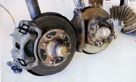

Crappy pic of 280ZX brakes, i know, maybe you can point out what it is you think the problem might be? I dont think we have a clear understanding of the part you speak of.

metal pieces in calipur make grinding noise, HELP!!!!-0106scc_rally13_zoom.jpg
they are two small, about 1.5" square pieces. after you loosen the bolts behind the caliper and take the top of the caliper off you can see the two pieces. sitting in the spots that I have marked (sorry about my 3d polygon drawing skills) the one on top is tilted forward when the caliper grabs and doesn't reset. sorry about the confusion. I will have multiple pics of the problem in about a week. I have examined the scraping by slowly rotating the wheel and noticed that after the test runs that the metal piece hugs the edge of the rotor. thanks miekatrpi but it isnt any moving part on the caliper. they just sit there like spacers of some kind, not connected to anything moving.

From the nissan parts catalouge- maybe this?
EDIT-officialy known as a "spring pad"

THATS THE PIECE!!!! but there is also one higher up on my brakes. maybe it isnt supposed to be there? I have two of those on each brake on the car. anyone know the purpose of this "spring pad"?

Well, if im reading this right, should only be 2 per caliper. And if i remember correctly, there was 2 per side on mine. And i dont think, if installed properly, they even come close to the rotor. They should be sitting on top of the pads, keeping them in place. Correct me if im wrong guys, but i am pretty sure there should be only 2. You might be dealing with a backyard mechanic, jerry rigged something or other. Maybe its something else that is grinding?

thats what i meant. i have 2 on each caliper. and i'm 95% sure that the spring pads are causing the sound. I've watched all parts of the caliper while turning the rotor before and after moving it and it only occurs after the piece is touching the rotor. also it doesnt make quite the same sound as squeaky brakes. this sounds more like a chain dragging and bouncing under the car, because the edge of the rotor that is being scraped is slightly rough from age unlike the smooth side where the caliper grabs.

The brake pad retainer clips (top and bottom of caliper) have nothing to do w/ the "low brake pad" sound. They don't flex or move sideways as the pads wear, they should stay stationary to hold the pads from coming out of the caliper. The pads themselves should have wear limit pieces that scratch the surface of the rotor when the pads have reached their limit.

Thats the standard name for them in my part of the world. When I opened my front brakes one had been missing for who knows how long! Put it back together without it. When I have time I'll replace it. If you want, just pull both clips out, put it back together and drive around the block, if no noise its the clips. They can get bent slightly when you put them in and scrape something! Straighten with pliers or just replace then. Here is an Ebay number for what you need if it is the clips. And they are cheap! Item number: 250186756115
