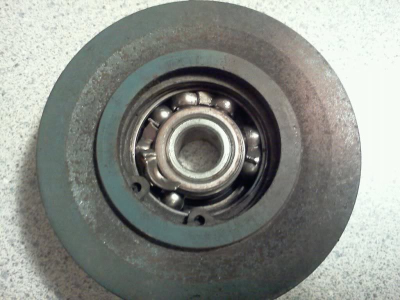

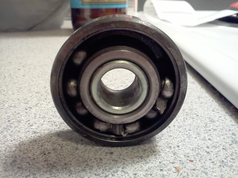

Turns out it was a tensioning pully for the belt that also powers the power steering pump, or that just failed at the same time. anyhow, the belt is slipping, the pully is locked up, i need to replace it. Its the pully on the top front of the motor. dont know what its called.

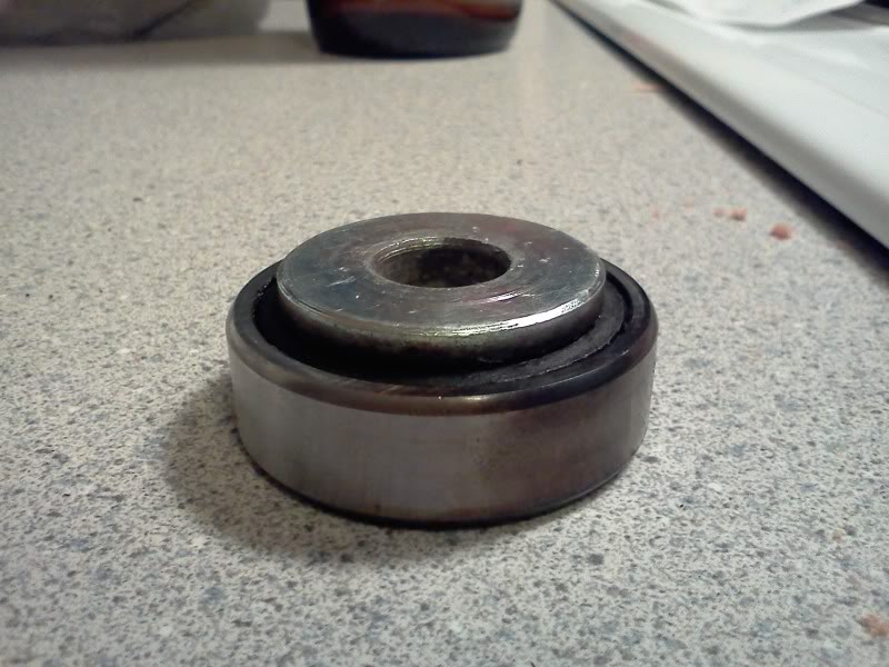

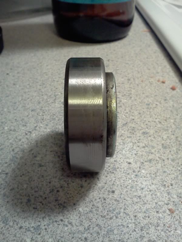

So the inside "spacer" Does that need to come out from the old bearing? or does that come with the new one? Im lost here. that and no one carries this thing :\

Yup. Just press it out and put it in the new bearing....

Now ive read that the tolerences are very very tight on these. So much so that i can damage the bearing by not only pushing the spacer in but also but simply pressing it into the pulley as well.....Any tips?
Old May 9, 2011 | 08:29 PM
From: Victoria, BC
If it's clean and you have the right bearing it should be all good. Mine worked out perfectly and I've got zero mechanical background....
