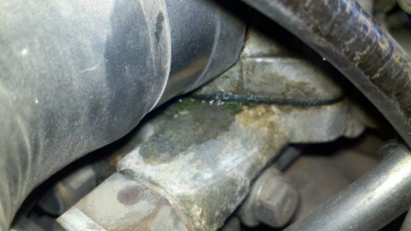

Pokin' around under the hood, trying to decide if I want to change out the water pump (which of course it's suggested you do the fan clutch as well) while doing the thermostat and hoses; I saw this new development...
It had not been leaking before- did take a 20 mile drive yesterday, first long distance since purchase.

Tricky diagnosis. Could be just the clamp or the hose leaking. Easier replace than the other stuff. Metals still look healthy to me. Think positive...!

Oh, I am. Just looked, it's dry and I drove it today, but not yesterday. It really looks like it's from the gasket itself.

When you replace the thermostat gasket do the head to housing gasket as well. If one is leaking the other is most likely going to leak too.

Dumb question- what's the head to the housing? The top cover over the t-stat?

Yes, I do use the FSM, just not during work hours... Upon referring to the FSM, 1+1 make 2 and I see what audio was indicating, thanks. I'll get the other gasket when I pick up my lower rad hose, which will be tomorrow.
