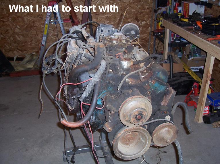

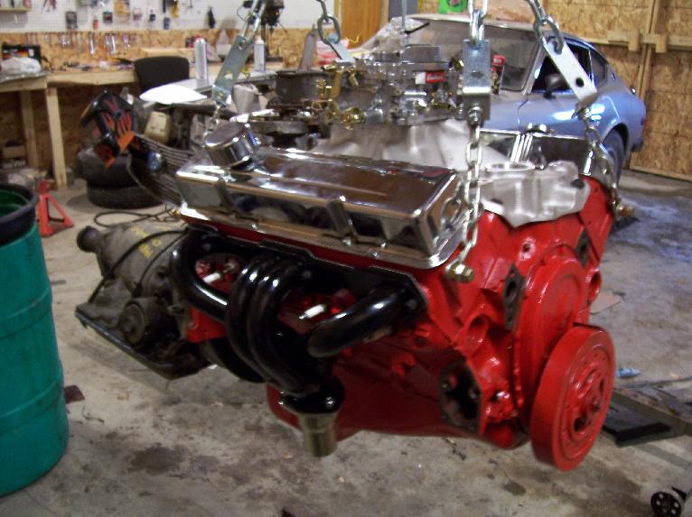

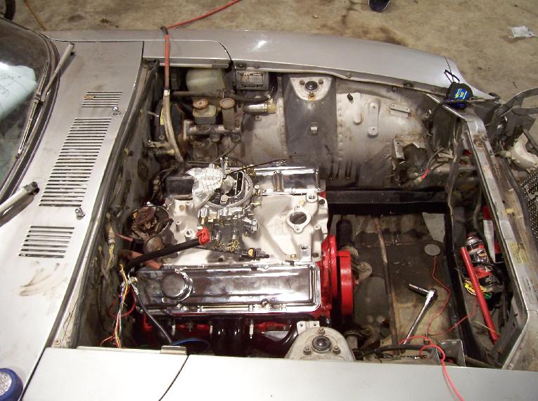

ok its been a wile but I am getting closer to getting her on the road, attached is a few pics for your veiwing pleasures. the engine is a 1975 sbc 350 4bolt main 010 block, I kept the 882 heads and the standard bore, added scat conectng rods, .275 dome top pistons (10.3to1 compression), melling 22301 cam set, weilend xcelerator single plane intake, 750 edelbrock carb, acell high performanced hei ignition kit, 1 5/8 block hugger headers, and a 700r4 trans. I would definatally recomend the JTR conversion manual for anybody else doing the V8 swap.
