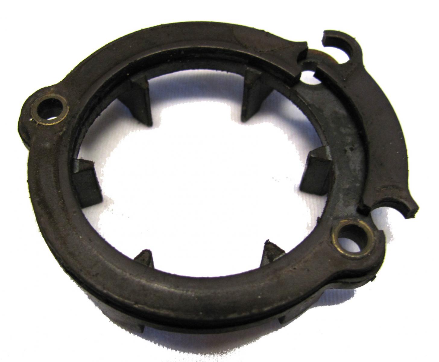

Looked deeper into the distributor and found that the "Stator" was cracked on the bottom side: See pic.
I moved the "cracked" piece out a little bit so that you can see it more clearly. I am not sure if it needs to be solid or whatnot ... It is the only thing that I can "See" that is broke.
So now I throw it out to the experts ... where do I go with this now?

Old Jan 22, 2011 | 08:39 PM
Yowsa!
I'd try to source a new dizzy from a local junk yard (www.car-parts.com). I have one somewhere in my garage storage... but I have no idea where.

#4 is the Stator (the part that's cracked) and #3 is the Reluctor. When it spins it produces magnetic pulses that the #8 coil picks up then the black module on the side translates those pulses into +12V pulses the same as your cap and rotor would produce for the low voltage side of the coil ignition on the earlier distributors. It replaces a mechanical switch with an electronic one and since the stator and reluctor never touch each other they (should) last for a very long time comparted to a mechanical contact.
