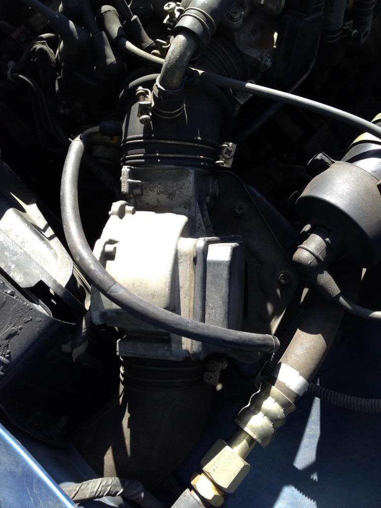

I have 1982 280zx non-turbo for not long and I have now unstable idling problem. I look around air intake area and found one hose that is attached to the rubber duct hose between air flow meter and the intake manifold as you see in the picture. And it's end is not connected to anywhere.
Please help finding where that small hose supposed to be connected. And it is sitting on the air flow meter. It's other end has a clamp. It may be one of cause of unstable idling on the engine. And if you have any suggestion to tackle solving the idle problem, I greatly appreciate your suggestions.

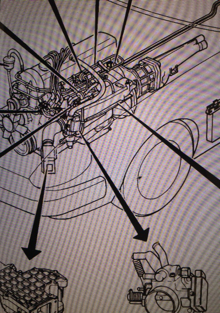

That should be able to reach the tube coming out of the side of your valve cover. In the "Engine Fuel & Emissions Control System" section of your FSM page 4 of 126 in the PDF, it clearly shows where it goes.

First picture is from manual FSM page 4 of 126. I see a larger hose from the air flow meter goes to the valve cover. And it is not the one I have problem with small size hose from large rubber connector between the air flow meter to the intake manifold.
Size:  425.0 KB[/URL][/IMG]

And next one is the hose that I can't figure out where it should be connected.
[IMG][/IMG]

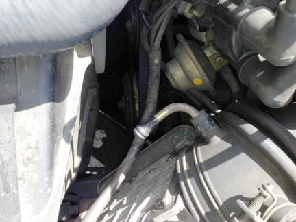

cause none of your pics show where it goes it connects to a vacuum port its located right below thermostat housing under water temp sensor you should see it

Thank you for quick help. I looked at it and took a picture near yours was taken.
[IMG][/IMG]
However, two small hoses are connected and not the one like yours. And there is no other nozzle is available.
