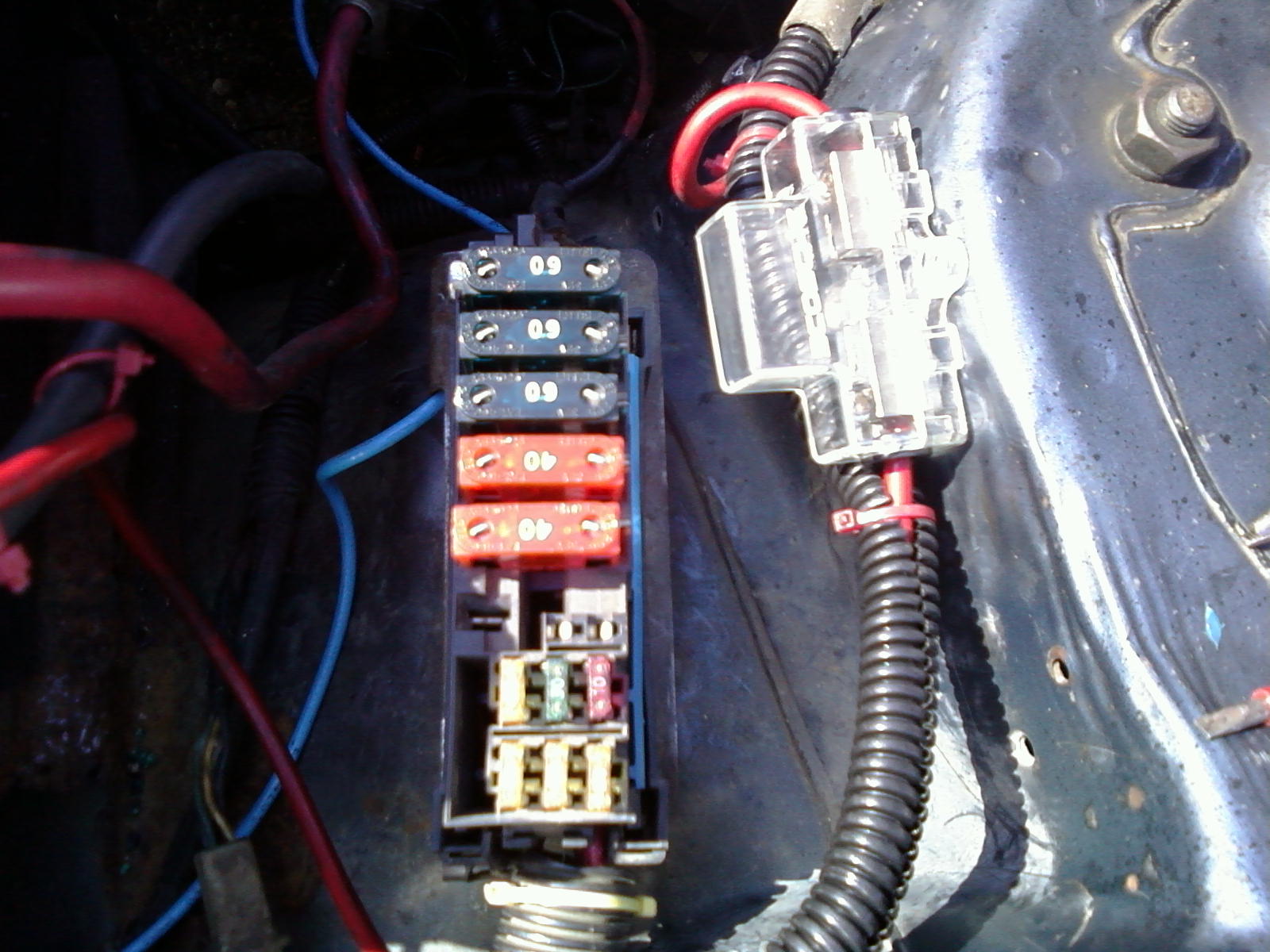

Ahh. I don't have Fuse links anymore. I installed a 98 pontiac box. it has maxi fuses. i have 3 60's and 2 30's. there all good.

mine is cool. 5 large. 9 small. bottom pops off for all the accses to wires you need. it's long. and not sqaure. has a shunt plug. pull that out. all the smalls loose power.

dang take some pix

tomarrow i'll post a pic.

6 small. srry been awhile since i've actuly looked at it.
Attached Thumbnails Odd Charging Issue-p_00082.jpg   Odd Charging Issue-p_00081.jpg   Odd Charging Issue-p_00080.jpg

cool, it looks factory too!

94-99 grand am's should have them. i should of mounted it parralel to the fender. but space is limited with such a bigg fckin battery
