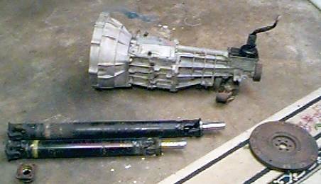

Old Apr 14, 2006 | 02:20 PM
Originally Posted by nismo619
i do belive u can still use the 2+2 drive shaft to compete the swap over to turbo maunual tranny...
you tell me then.
turbo 2+2 driveshaft on top
turbo coupe driveshaft on bottom
can I use the 2-seater one in my 2+2 T5 conversion? The longer driveshaft fit just perfect.
All 1982-83 280ZX's had the larger turbo hood scoops.

well what i ment was i have a engine from a 2 seater 280zxt with drive shaft but couldnt he still be albe to use his auto tranny drive shaft onto the t-5 manual tranny ? meening the turbo drive shaft and a non turbo drive shaft of the same type of car lets say 2+2 are the same ? or is there a strength issure on the turbo drive shaft ?

Nope. Nearly every tranny and every body used a different drive shaft.
ie.
2+2 Turbo 5-speed only fits a 2+2 Turbo 5-speed
Coupe Turbo 5-speed only fits a Coupe Turbo 5-speed
2+2 NA 5-speed only fits a 2+2 NA 5-speed
Coupe NA 5-speed only fits a Coupe NA 5-speed
The only one that will work with more than one config are the Auto's.
Coupe Turbo Auto will work with the Coupe NA Auto
2+2 Turbo Auto will work with the 2+2 NA Auto
