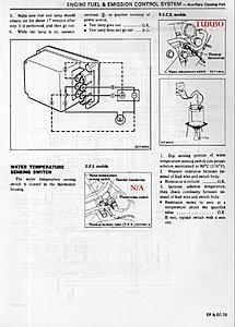

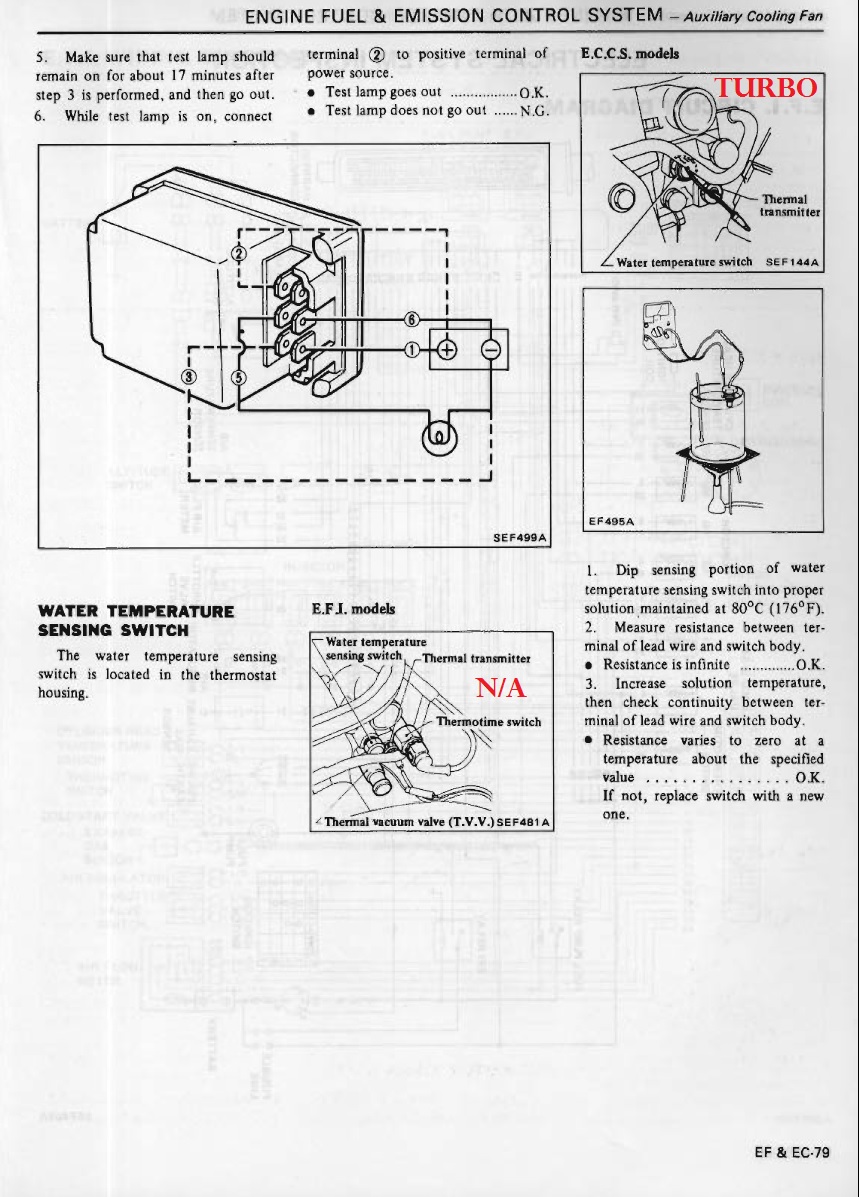

First you need to check static fuel pressure... is the fuel pressure leaking down when the engine is off? Is it coming back to ~35psi when the fuel pump primes?
Second, you are referencing harnesses in the FSM, but not by name or location, so I don't know specifically what you are / aren't looking at. Here are some good reads and a screenshot of the thermostat housing sensors.
https://www.zdriver.com/forums/280zx...problem-38252/
https://www.zdriver.com/forums/280zx...problem-38793/
There are 3 sensors...
#1: Water temp sensor for dash gauge
#2: Water temp switch for the aux fan
#3: Thermotime switch for the cold start valve.
