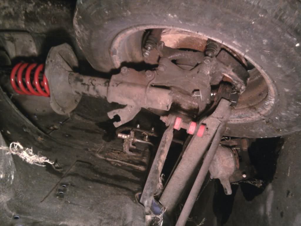

You could just bolt on s13 everything. Its what i did it sits like an inch lower than the stock 280zx suspension. But then you got all the aftermarket support. Like coilovers and brakes even knuckles. Im running sentra coilovers in the rear and s13 in the front and it still has travel. I was going to use the s13 lower controle arms but decided not to since then i would have to worry alot about mounting my tension arms up straight with that. Ill post some pics up here soon.
oh and i swear ive read on here quiet a few times that s13 s14 suspension wouldn't work on the zx?

Isnt she lowvley

i think your missing your brakes there!! that ball joint is at a really bad angle, there not meant to do that regularly.
