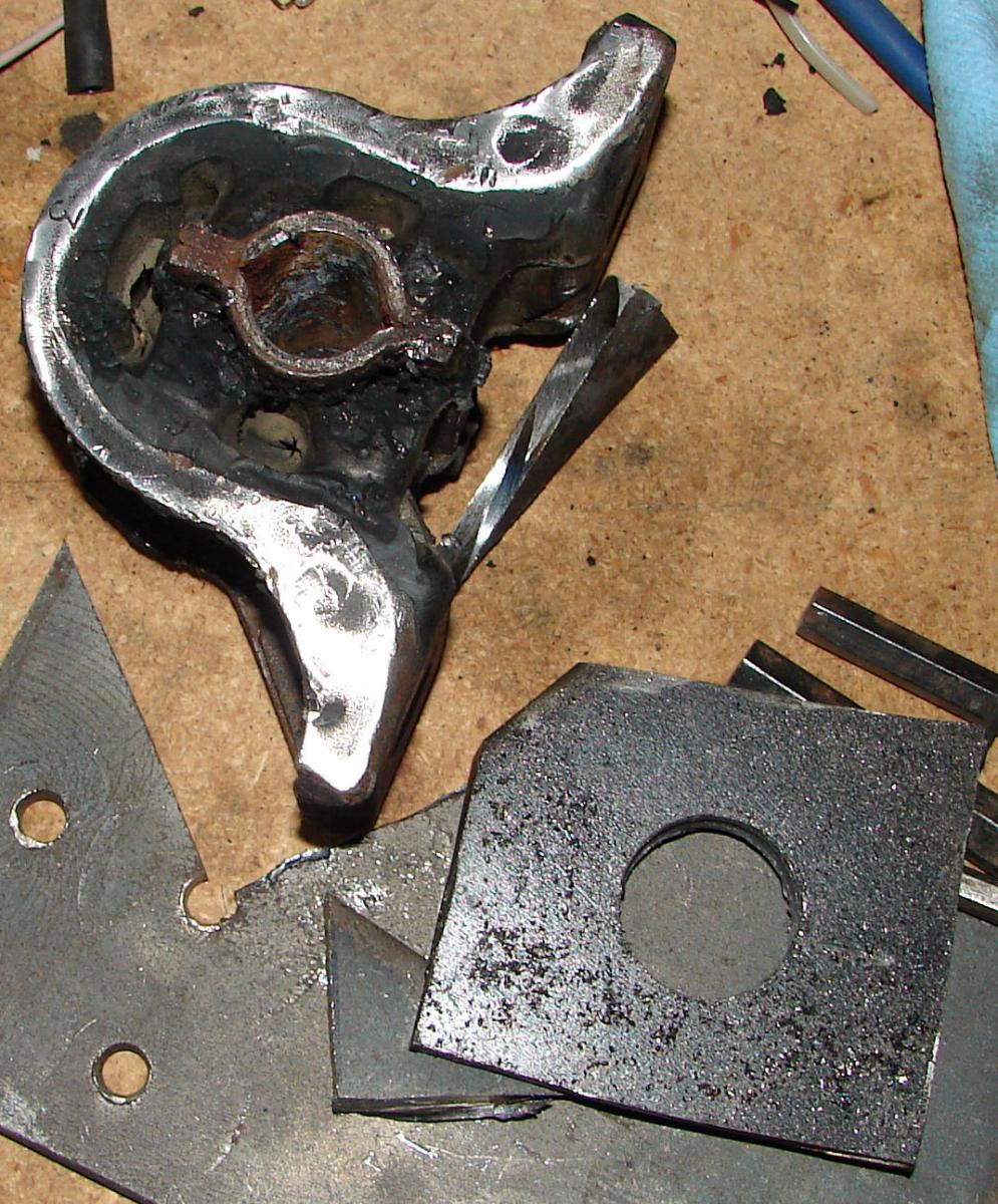

My car is starting to get a thud in the rear end when shifting now... YAY More crap to replace! Diff-mount going out Im POSITIVE on that one
Go solid diff mount! I've been putting one together. Mebbe I'll post pics tonight.

meh. like the RT mount nismo? but im guessing only for an S130, or do they share that in common? i can;t recall.
Old Mar 17, 2009 | 11:33 AM
Same idea, but the RT mount is quite a contraption. The S130 mount is just a U. I have removed the rubber insulation & will be welding a plate on top & bottom.
Old Mar 17, 2009 | 02:22 PM
i did that upgrade 3 years ago, it really made a difference in how solid the rear xmember was, i left the xmemeber bushings in too tho, didnt feel it needed those to be solid on a street car. no real xtra noise was noticed.

Here's a pic of the S130 diff mount w/ a half finished plate that will be welded on the top. I'll probably weld in some support on the bottom too.

Thats interesting. I take it you have a bunch of metal working tools?
A few.

the rt mount just replaces the strap on top of the diff. allows the diff to be held from the top or sandwiched so you wont have your diff slapping. such a simple but great invention
