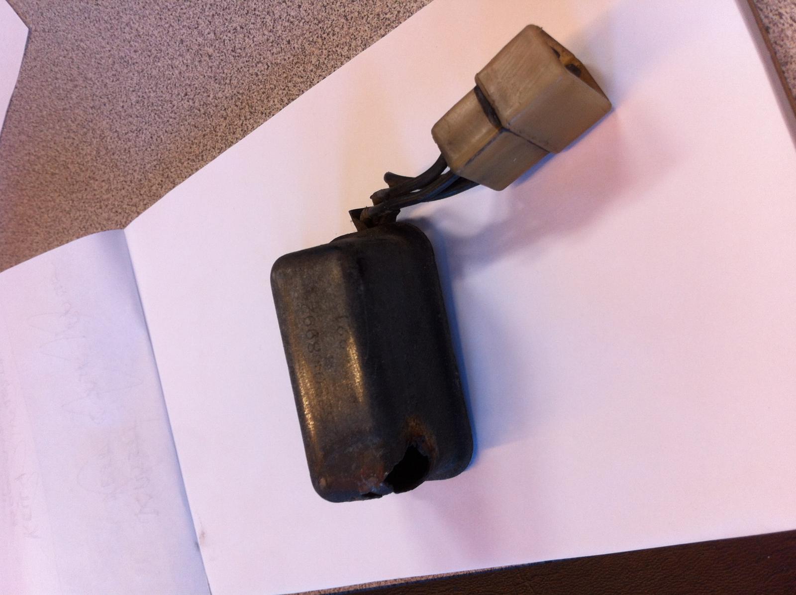

Trying to identify this thing, maybe a horn relay? It was screwed to the firewall and coated with paint I removed the paint with laquer thinner but the numbers are too faint for me to see. I am thinking the rust hole it it may have caused the internals to suffer and I should replace it...

Screwed to the firewall where???
More info and better pics would be helpful...

It was towards the passenger side about halfway down the firewall. That is as good a picture as my cell phone will take I can snap a better one at home this evening. The numbers I can make out on it are ...25280 8992 on one line then next line ...321
It has 4 wires out of the back into a 4 pin rectangular plug.

I think I found out what it is, looks like it may be the relay for the rear window defogger...

How about the year of your car? That makes finding parts a little easier.
Old Jan 18, 2015 | 03:28 PM
Steve260Z74's Avatar
Joined: Feb 2011
Posts: 305
Also, was it plugged into the harness? If so, what were the wire colors at the harness?

it is a 1973 I will have to check the wire colors...

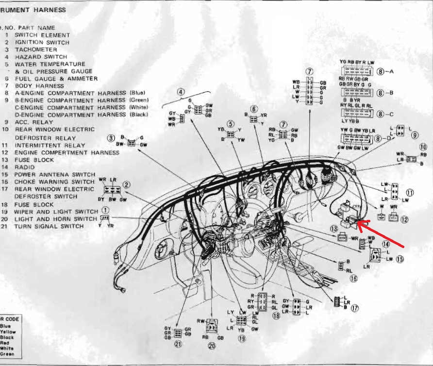

When you get the wire colors, I should be able to identify it for sure. I took a closer look at your picture. I believe the full part number is 25230-89924. Searching online, that part number comes up as an Accessory Relay Type K24, so that would tend to support the defroster relay, except for your described location. In the 73, the defroster relay should be on the passenger kick panel, not the firewall, next to the accessory relay. I drew an arrow to it. The dash harness wire colors are white/red, red/black, black, and blue/red.

I will check it out for wire colors, forgot last night, was working on removing the transmission after I realized that I used the 5 speed throw out collar when I should have used the original 4 speed collar...
