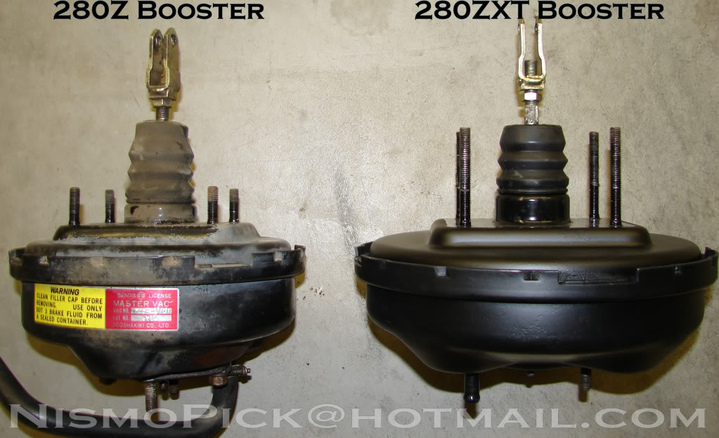

FYI... This is an easy upgrade. The S130 280zx brake booster & master swap right in to the S30. The only thing you have to do is:
-Remove the spacer on the back of the 280zx booster.
-Adjust the brake pedal link to match the 280z booster.
-Rotate the 280zx booster 180 degrees & install.
Bam!

Hi,
I'd like to know, do the 240Z and 280Z boosters have the same thread patterns? or does it need to re-drill new holes on the firewall to fit a 280 unit on a 240Z body?
on your photo, the threads between the 280Z and 280ZX units seem to be at the same spot, so I'm guessing it needs to re-drill?
if anyone can confirm that to me..
thanks!

The distance between the booster studs are the same for all 240z-280zx's. As stated in my previous post, when using an S130 booster in an S30, you just need to clock it 180* (turn it upside down) and do not use the spacer.
No re-drilling, no other modifying... just install it.

are you a 100% sure though?
'cause I've read a few topics stating drilling was needed on 240Z bodys, like this guy (maybe he didnt turn it 180°? )
http://www.classiczcars.com/forums/w...-can-done.html
you wouldn't have measured the distance between the studs before installing it on your car, by any chance?
