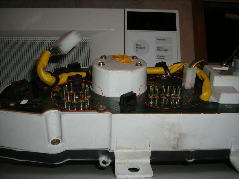

new problem.. these pins the chrome ones circled.. those two connectors i have to get off and they dont snap or anything i dont think but they are on there with a brute amount of force.. i dont wanna break anything so any suggestions on them or just pull the F'ers ?
Old Oct 30, 2008 | 04:05 PM
Just pull....

This mother will not pull off... Idk like I've got it to where I can get a good grip but like its pulling up the green circuit board almost
Old Oct 30, 2008 | 05:06 PM
speed280zx's Avatar
Joined: Oct 2008
Posts: 67
From: Blairsville Pa
lol alright well with a little handy work of a flat bladed screw driver it finally gave way. and i completed the swap thanks for the help
