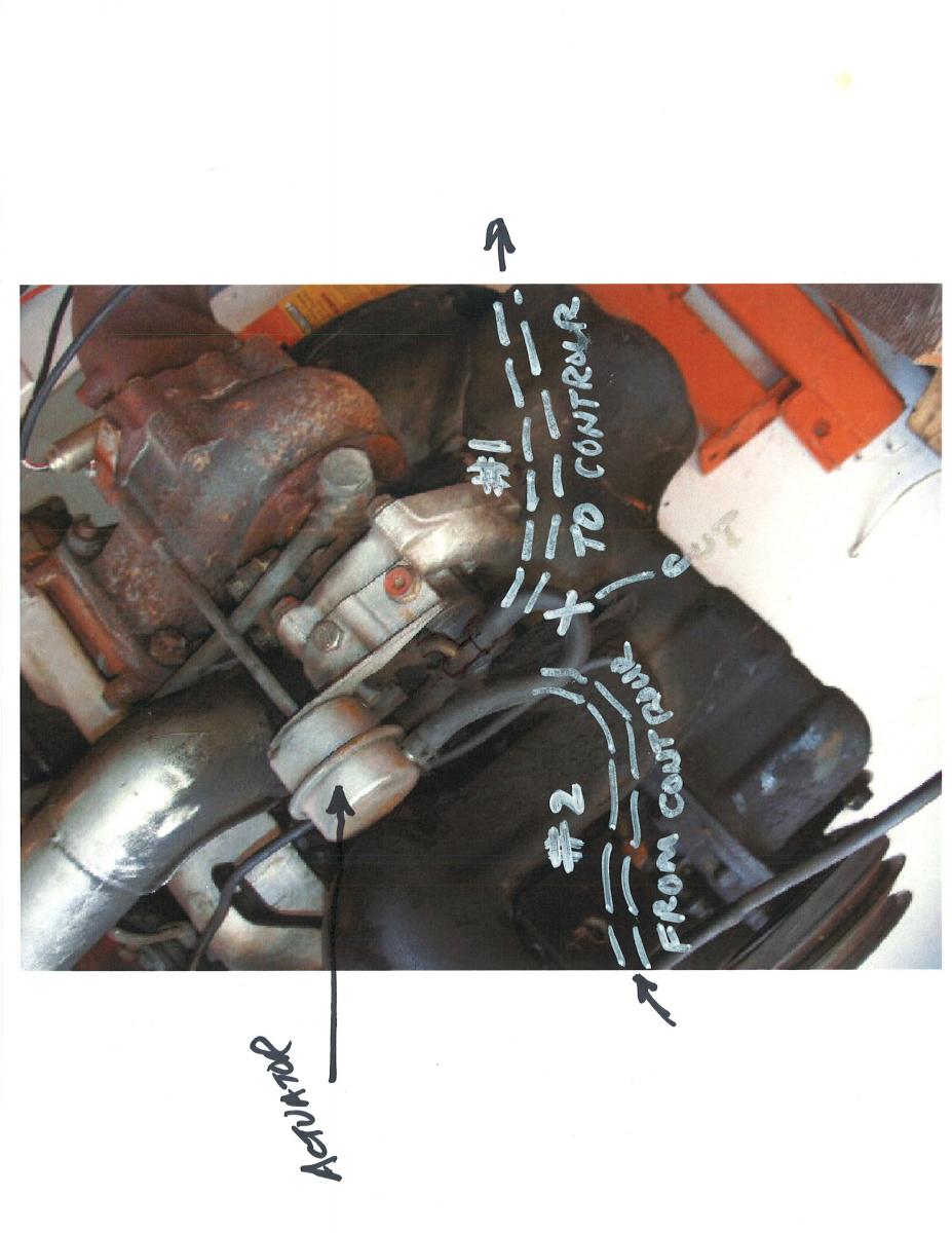

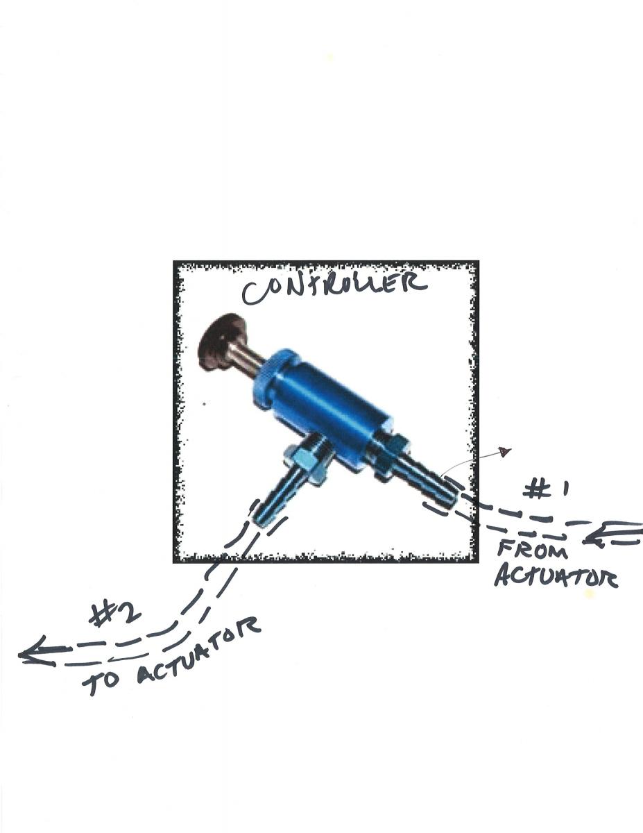

I put in this boost control combined with this gauge. There are a lot of choices out there.
Amazon.com: Voodoo IV Manual Turbo Boost Controller Anodize Blue Body Black ****: Automotive Amazon.com: Voodoo IV Manual Turbo Boost Controller Anodize Blue Body Black ****: Automotive
Amazon.com: GlowShift Tinted 7 Color 30 PSI Boost/Vacuum Gauge: Automotive Amazon.com: GlowShift Tinted 7 Color 30 PSI Boost/Vacuum Gauge: Automotive
Just found the diags we used - if that's any help.
Attached Thumbnails turbo issue new to 300zx-20130508095738_00001-diag1.jpg   turbo issue new to 300zx-20130508095718_00001-diag2.jpg

Planning on going with auto meter gauges but wasn't sure about a controller. Thanks zxguy1986 for the diagrams that helps out a lot since this is my first turbo car and know just about nothing about it yet.
