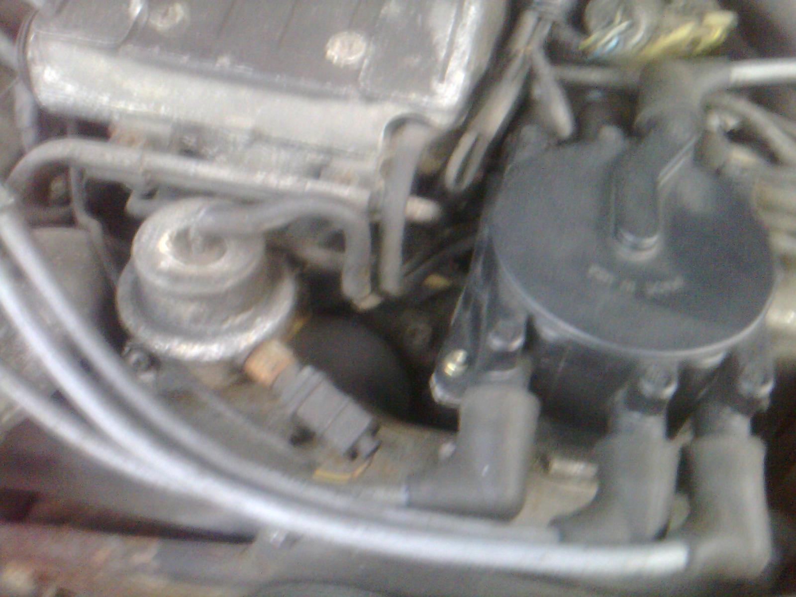

Okay, I attached a pic of, I think, the fuel pressure regulator that is to the left of the distributor cap... let me know if I am wrong.
Going on that it is.... I checked around the FPR and it did sound like it was the source of the air/gas fume leak. Still didn't see any fuel though, nor could I feel the air blowing from the FPR it was just hissing louder from its area.
Is it possible to have a air leak from the FPR?
Also, the car idles up and down like I tapped the gas pedal and then it goes to almost sounding like it will stall then shoots back up again and it just keeps repeating that. Could that be related to the FPR?
Thanks for your help!
zx-white-belt
zx-white-belt
air won't come out of the fpr. quite likely the source of your problems however. put a fuel pressure gage between the filter and the fuel ring. monitor pressure to see if it is fluctuating. the fpr has a vacuum line going to it to increase fuel pressure when vac is high.
