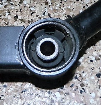

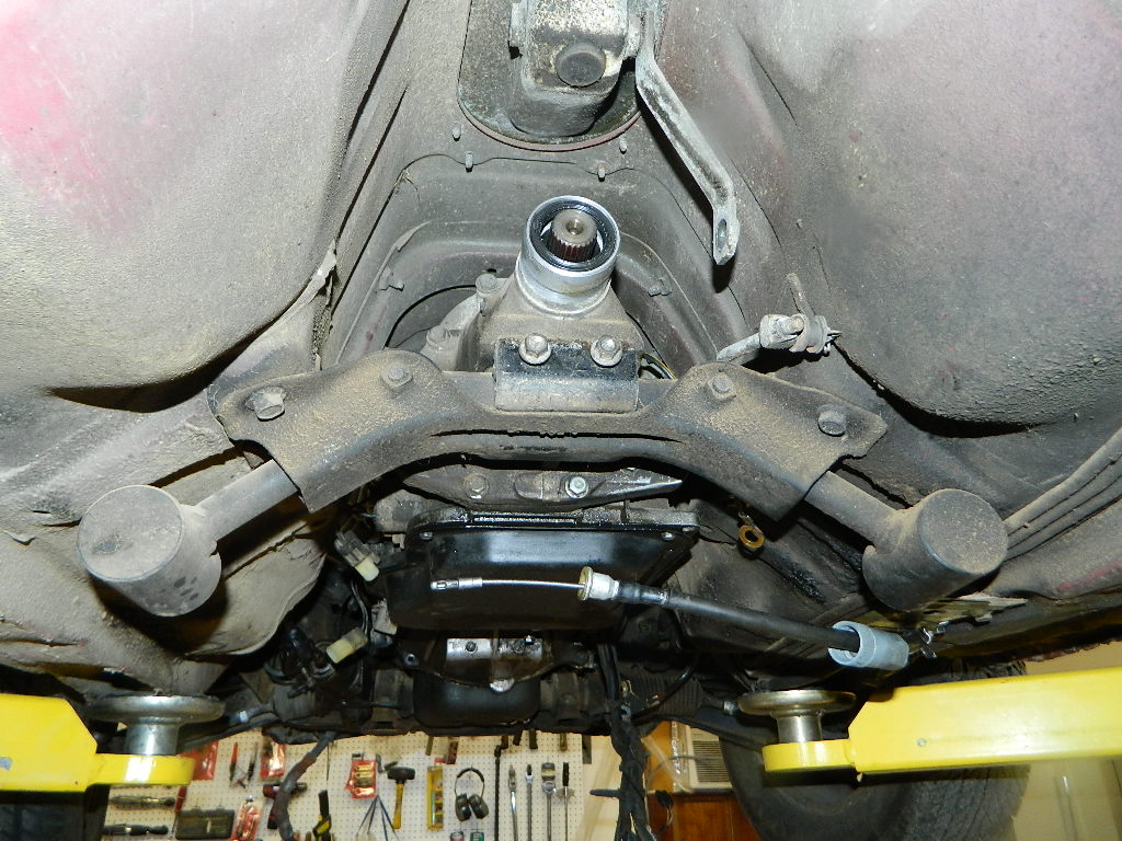

Hello, I am new to this forum. I am working on my Son-in-law's 84 300ZX 2+2 with automatic transmission. I am doing all the work and this is a gift for him. The car was originally given to me by a good friend. We found that the engine had over heated numerous times, causing the left side exhaust manifold to crack, head gaskets to leak and ultimately warp both cylinder heads. I purchased a remanufactured long block and I am in the process of cleaning everything up and seeing what needs to be repaired or replaced. After taking out the transmission and the old long block, I found the following item attached to the transmission mount. The rubber flex bushings are damaged and need replacement. I have a FSM and it does not call out this item, See pictures. Has anyone replaced these bushings before and where they can be purchased from? I have a new trans mount already. Thanks, Bob
black thing looks like what is bolted to the manual tranny on my 86. maybe the same on the auto tranny. I think it is there to keep the tranny from torquing around. or just a handle to drag it around the garage when out of the car??? LOL

Thank you for your wisdom rogerz, as I am sure it is based on your experience with these cars. I have been working on cars and motorcycles since I was 19 and had used dielectric grease, but had never heard of Deoxit or CorrosionX. I will heed your advice from this point on. Thanks again, Bob
That piece was a vibration dampner installed after cars in hot climates , like Texas , the SW, Fla , were getting noise and vibration mostly after long rides in 95 + heat... I was told @ the dealer I was at I experienced it once ,thought the trans was coming apart
Thank up 86 tcoupe. The car I am working on, had to have been from the south or southwest, as there is virtually NO rust on the underside of the car or on the body as well. The interior and dash has taken a beating due to sun damage though. It is a really solid body car. One of the reasons I decided to fix it up for my Son-in-law.
I thought that was what it was for. I have been looking for replacement bushings for awhile on the internet, but have had no luck. I am leaning towards going to the Nissan dealer, close by me, to see if they are still available. Bob

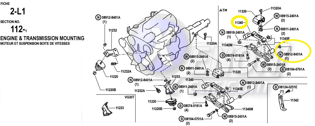

XenonZcar.com Z31 Parts Fiche ENGINE & TRANSMISSION MOUNTING Section 2L-1-112
Looking in the above web site, i found the vibration damper and replacement bushing parts. The Nissan part numbers are listed and I show them circled in YELLOW in the attachment. Calling my local Nissan dealer and confirming availability then cost, is on my list to do today.
Thanks, Bob
Thanks, Bob
