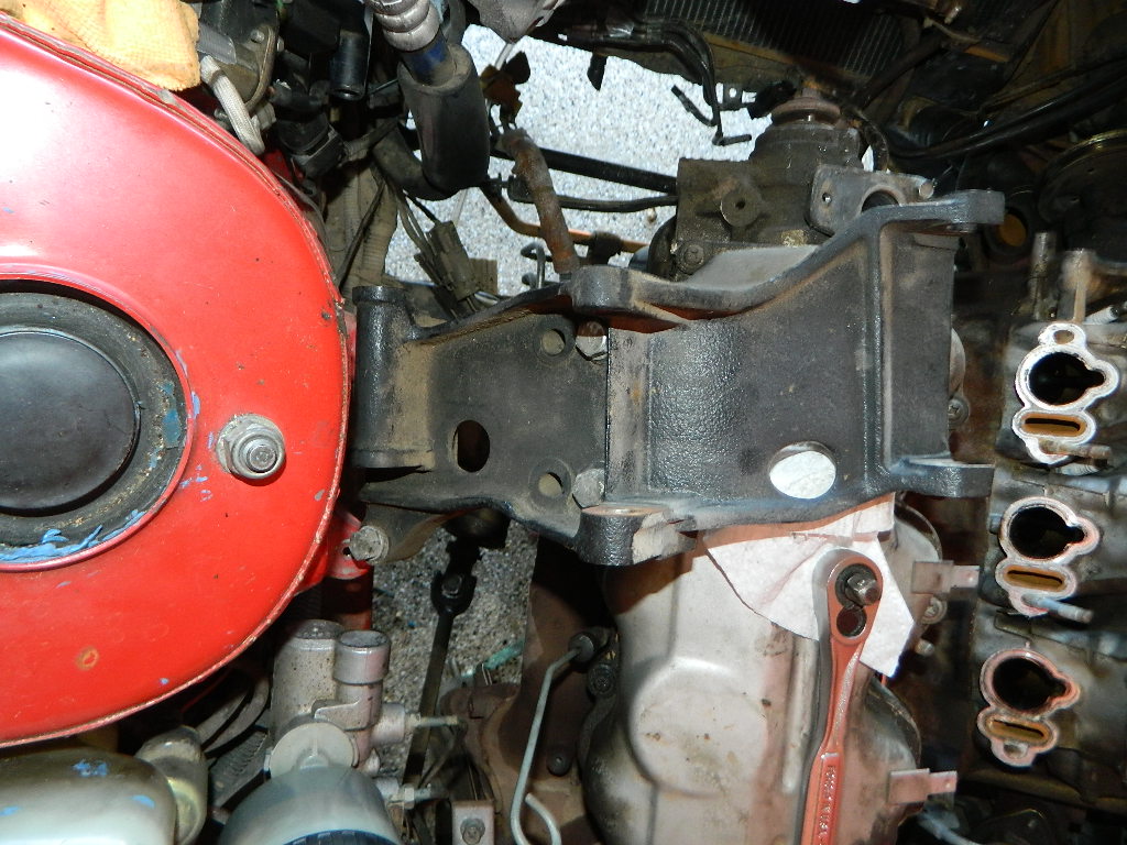

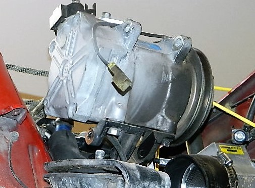

The air conditioner has been acting up for a while and I'm real sure its the compressor and or the pulley. They are both getting replaced. I cant seem to find any info on removing the compressor except the manual say remove the 4 bolts. I believe if I remove the top two bolt the this will allow me to rotate the compressor on a bracket below and unbolt the other two bolts. Is the correct or am I going to be kicking and having a fit with removing other parts to get to the lower bolts?

Here are 3 pictures that show the main large bracket, that the air conditioning compressor bolts onto and a view of the compressor itself. The compressor fits snuggly between the flanges on the top and bottom.
