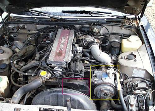

You asked for them so here they are.
Now when I saw it at first I looked under the hood and saw what all of you see...the 3000. What actually tipped me off was the spoiler. Then as you see in the second picture it is a 2+2 and the front seats are (well, at least out of) a turbo. Now to me, when you look back at the engine that looks like a stock turbo.
However, I don't know for sure...which is why I have you guys (and gals).

You should look more closely at the engine. First, the 3000 plate doesn't say turbo. Second, the pipe right before the throttle body is plastic and is NOT connected to any turbo. And if you look more closely, you'll not find any turbo anywhere in the engine bay. And that's because the engine isn't a turbo. Also the injector cooling fan that's on the right side of the engine only came on the 86NA models in that location. And finally, the 15" NA wheels.
All 86 models came with a rear spoiler (in the US anyway) because of the third brake light that was added. The seats, are you sure those say turbo? I believe they say 300 across the top and ZX below. But it's hard to tell from the pictures. Regardless, that is not a turbo car, and that is not a turbo engine.

Then what is that right below the distributer cap? (curious now)

Below the distributor cap is the engine. In front of it (red) is the timing belt cover. Next to it (yellow) is your air conditioning pump. Did you think the AC compressor was a supercharger?

Ok, I thought the timing belt cover was covering the turbo. I have never seen that on an engine...of course I have only worked on the 88's. I knew what the air conditioning pump was (and wasn't).
Thanks Bleach and Bum....sometimes I am just oblivious.
