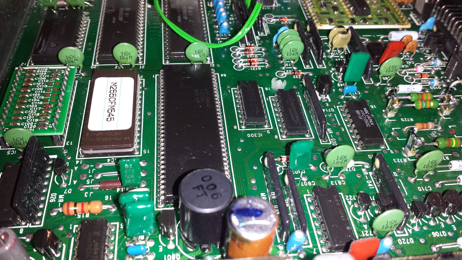

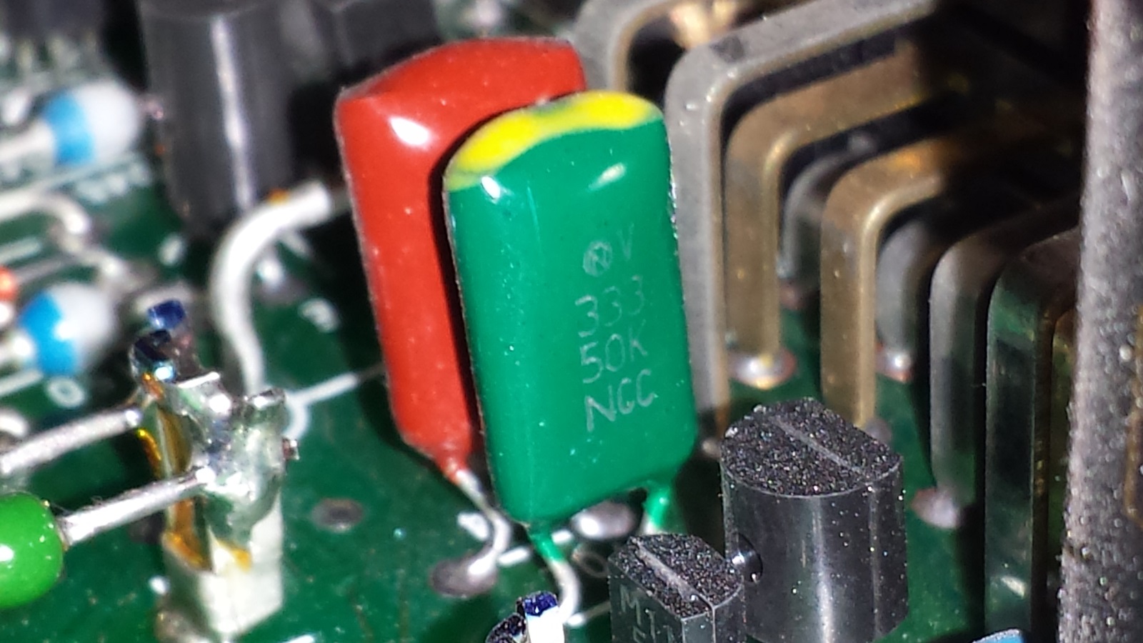

Here are two pictures of the inside of my ECU. I don't know if the green component or resistor or whatever it is beside the 15 pin connector is supposed to have a yellow top or if that means it is bad. None of the other ones on the board are like this one.

don't think that is your problem. Probably a capacitor and just got a yellow mark for some reason to identify it. Codes usually just cost you money with no real value to diagnosis.
