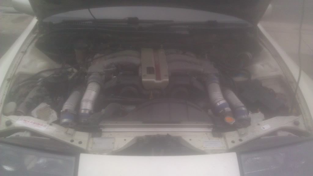

Hello fellas I am a new 300z owner i recently got this car in a trade
Its been giving me headaches since I got it,rarely it will start but only for less than a minute but sometimes more than a minute and after she starts and suddenly dies she wont start again. There was a compustar alarm installed at one time and even with the alarm harness unplugged she wont start. I have made sure I have lots of fuel/fuel-pressure to the engine but when I checked for spark I put an in line spark tester and saw minimal spark going to the plug.
I am a msd and carburator kind of guy old school v8's and stuff like that and am a bit stumbled as to where I should start. I have read on some forums about the cas....? Is this a common thing for these cars?
Any help would be greatly appreciated cause I dont want to bring it to some rip off mechanic.
