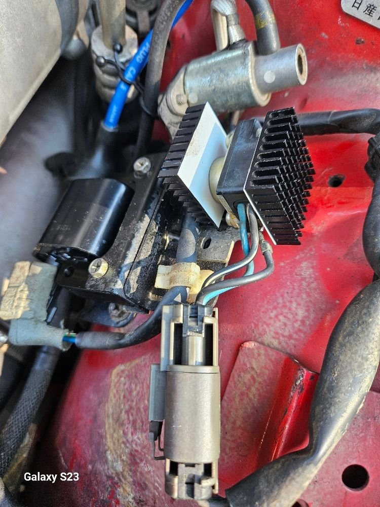

Troubleshooting no hot start issue
1985 Base. Check the power ignition transistor(oem# 22020-12P11). Quick step to verify that is the problem: Take an ice pack and place on the part (located on the driver side strut tower under hood) for 5 minutes. Remove. Try to start. If starts, bad unit. Put the factory fix of a prw-2 unit with a crossover wiring and heat sink. Godzilla Raceworks has a kit for @$130.00. The other possible part failure is the hot start assist module(oem#A18-800 100). It is located under the battery tray(Nissan hid it because they knew of the hot start problem). I put heat sinks on my failing power transistor and didn't have a no start issue. So, after having the Cylinder head temperature sensor replaced with an aftermarket wet sensor, crank angle sensor in new distributor, complete tune-up wires, plugs, rotor, cap, fuel filter for the outrageous price of almost $1,500, my problem was the P.I.T. and/or hot start module, which I replaced for less than $200. After 2 weeks of driving at different distances without being able to replicate the no start issue, I deemed the problem repair. I did switch over to the PRW-2 w/heat sink conversion and replaced the hot start assist module. Picked up acceleration(like I needed more) and smoother idle and throttle. You all can send me some consulting $$...lol! Check the pic for heat sinks on power ignition transistor
PRW-2 link:
Pallnet PRW-2 Igniter and Heat Sink Kit — Godzilla Raceworks
Power ignition transistor w/heat sinks
