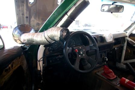

Greeting folks. I'm continuing to try to put our Lemons car on a diet, and I think the next thing to go will be the dash. While at a Pick 'n Pull recently I came across an '83 that had the dash pulled and saw how many odds and ends there were back there. I've circled the three main components in the first image, curious to know what they are. I'm assuming it's primarily heater and AC? I'm tempted to keep a heater just so we can defrost the windshield on rainy days, but would like to yank anything else which isn't necessary. The second image is what our dash currently looks like. Thanks in advance.
